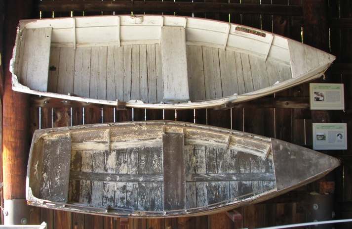

    Standard practice around the Chesapeake has been to build flat bottom skiffs with cross planking and no frames across the bottom.
    According Mike Alford in Traditional Work Boats of North Carolina "Most of the flat-bottom boats indigenous to North Carolina are like second type, with the bottom planks running from side to side."

    I have to admit I don't know much about the NC skiff, but assume it's built one of the two typically traditional ways, with: file or longitudinally planked bottoms. Again, file planked bottoms don't need full frames, just topside "intermediates" landing on the chine log and sheer clamp. These boats leak badly if outboard powered, as the athwart seams are oriented 90 degrees from optimal and wrack from engine torque, which just opens them up pretty quickly. Longitudnally planked bottoms fair much better, as the grain and seams run in the load path directions, but because of the number of seams, still tend to leak if outboard powered, just not as quickly as a file planked bottom. Longitudinal planked bottoms require athwart frames.
    As to the subtle difference in the lines of a NC skiff, compared to others, like clamming skiffs, I'd have to do some research, but I'll bet there's not a lot of difference, except in freeboard and maybe bottom rocker. Freeboard can be changed pretty easily and my Digger has this option available, simply by adding another strake or if a straight plywood build, several inches more side panel height. Rocker is speed and to a lesser degree use dependent, which you'll need to define a bit more. As designed Digger (a pretty typical clamming skiff) can scoot to over 30 MPH with a small engine (20 HP), but this is also the speed they pound unmercifully (unavoidable with this type), so I recommend speeds are kept to 25 MPH or less.

    The most common traditional work skiff seen in coastal NC is in fig 6 of teh link that David gives above: http://ncmaritimemuseums.com/wp-cont...56-reduced.pdf
    Some have more pronounced flare and some have higher bows and some have the motor on the transom, but this is typical of what is seen moored, waiting on the fisherman to take it out.

    Yes, click on David's link. Michael Alford wrote a good description of most of the local traditional Carolina work boats. Since these boats were mostly built in the user's backyard without plans, they have a wide range of attributes. Many of the earlier juniper power skiffs were strip built from chine up which allowed the distinctive Carolina Flare to develop over time. All evolved from earlier non-power boats.
