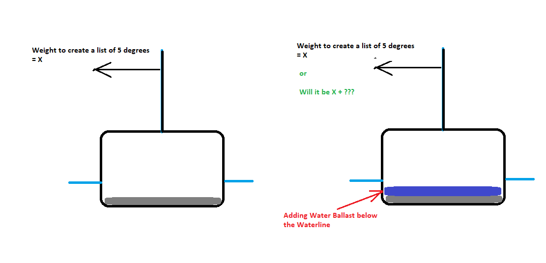

    So, to make sure I have got this right.
    You are saying that in the diagram above, the righting moment of this vessel ( assume just a plain prism on its length) will be identical whether there is water ballast below the waterline or not ?

    Two different situations with water ballast:
    A: Water ballast is external to the original hull shape: In this situation the water ballast has no effect on stability until the boat is heeled/trimmed sufficently that the water ballast is above the waterline. The change to CG and displacement will be exactly offset by the buoyancy of the appended volume. (The ballast tank walls, etc will affect stability to the extent that the density of the ballast tank walls, etc differ from the desnsity of water.)
    B: Water ballast is internal to the original hull shape: In this situation the water ballast has exactly the same effect on stability as adding ballast of any density as long as the mass and center of gravity of the added ballast is identical. (The ballast tank is assumed to be completly full without a free surface). One disadvantage of water ballast can be that the center of gravity of the internal water ballast tanks usually can not be as low as the center of gravity of higher density ballast.

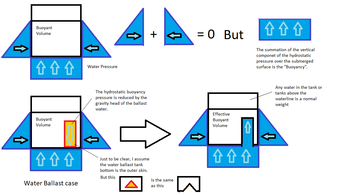

    No, read carefully, I never said that. Additionally, the figure above is irrelevant to CurtTampa's question and this discussion which is about water ballast. What you are totally missing in this discussion is the function of ballast. Ballast is added to a) trim a vessel to its proper lines and b) improve stability. Just because adding water will do (a) does not mean that it will do (b) in all cases. The case I stated; "water ballast only works when it is above the waterline", specifically refers to case (b) which is CurtTampa's question. This is because the weight, volume, and CG of the added "ballast" is identical to the added buoyancy. While adding water "ballast" may change the location of both CG and CB (and sometimes Iwp), you could just have easily changed the shape of the buoyant volume and had the same effect on the relationship between CG, CB and possibly Iwp. In the case you draw above, it is impossible to have the same displacement after adding the "water ballast" unless a weight is also removed. In that case, stability and righting moment has to change...unless...the weight removed had the exact GC as the water added, in which case the stability is identical. So the figure and your understanding of what is happening in it is poorly formed.
    No, what I am saying is that if the gallon of water was below the waterline, I could effectively remove the gallon of water and that much buoyancy and the boat would have the same draft and improve stability. Ok, I'm going to bite the bullet and do the drawing to show a good way to think of buoyancy. I hope this helps.
    Edit: I was working on the figure when kapnD posted, but really other than altering the shape, adding heavy ballast low is the answer.

    Your comment that everything below the water line is in the fluid is incorrect. This is to suggest that adding an object into the space increases the buoyancy. You need an object, statically to displace a fluid to create a bouyant force
    re your drawing, left hand bottom with the verbiage "hydrostatic pressure is reduced by the gravity head of the water ballast" The hydrostatic pressure is not conditional upon what is on the other side of the hull structure. The hydrostatic
    pressure is due to the depth of the water.
    In you drawing on the right, lower, it appears that you are suggesting that the water ballast above the interface, hull membrane, reduces the hydrostatic pressure below the hull. There is not an opening from the inside ballast to the outside
    water as you have indicated.
