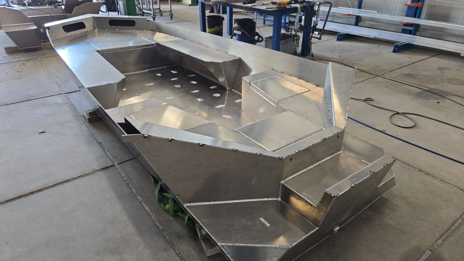

    Nevres.G Junior Member
    Total lenght: 4999.24 (mm)
    - Beam:1880.31 /1958.83 (mm) hull/boat
    - Thickness of the side/bottom: 4/4 (mm)
    - The waight of the boat without engine:
    *aluminium parts: 342,83 (kg)
    *aluminium profiles: 22,33 (kg)
    - Transom height: 508 (mm)
    - Deadrise at transom: 6 (degree)
    - Fuel tank: 25 (liters)
    - Max. hull load: 4/360 (peoples/kg)
    - Max. engine : 60 (HP)
    - Recommended engine : 40 (HP)
    Utilization aluminium sheets: 83%
    3 sheets 6000x2000x4 (mm)
    1 sheet 3000x1500x4 (mm)

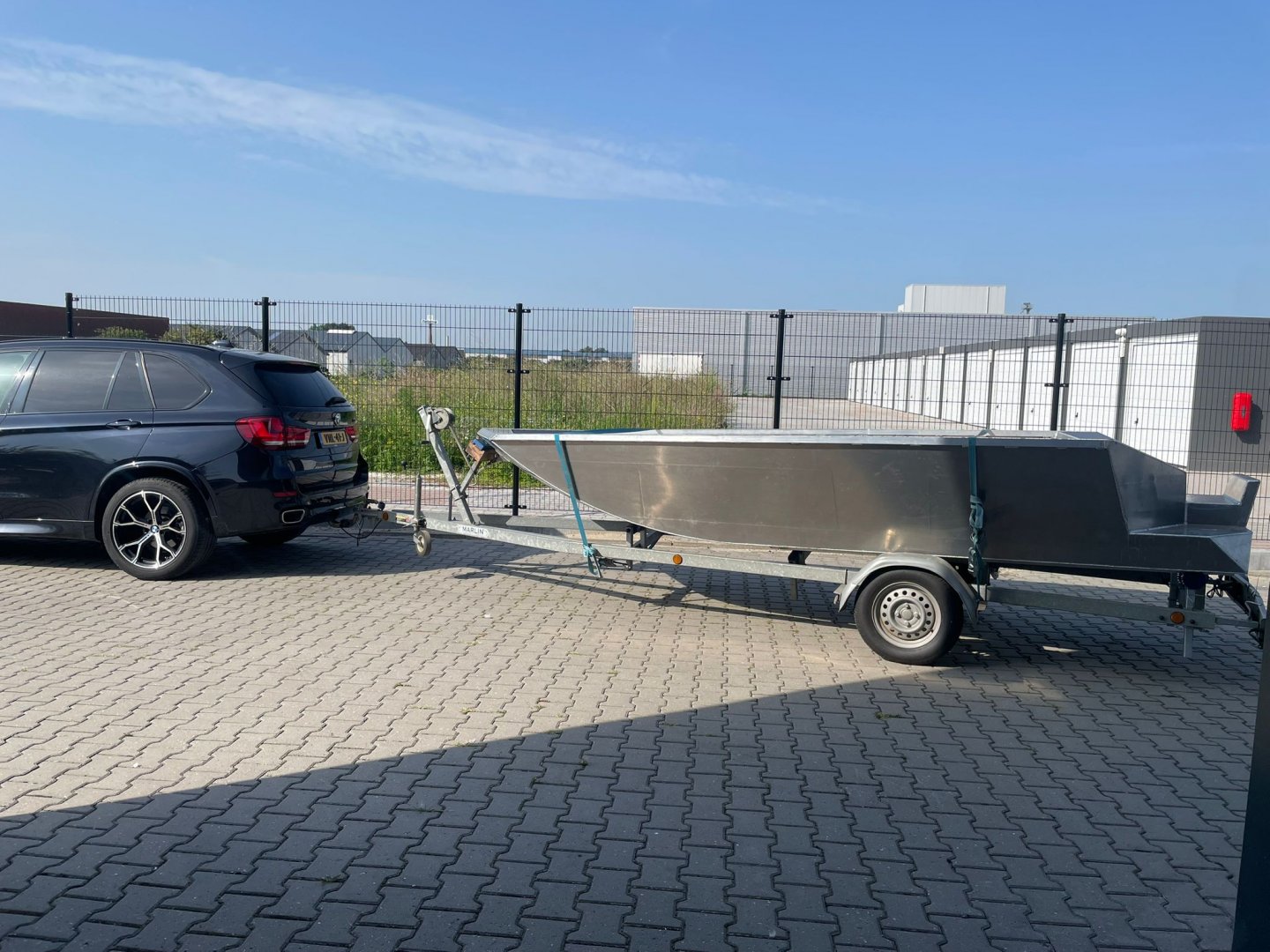

    Are you building these boats in Tuzla?
    If yes, what are the costs of completed boats, re the designs that you have posted on the forum so far?
