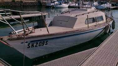

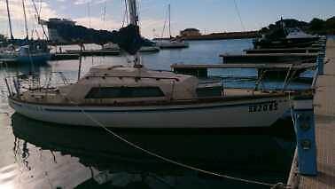

    Here are some more pics, the haulout pics are doubtless 7 years ago.
    I'll have more soon after I've done a prepurchase inspection.
    So I gather, they are a bit heavier apparently.
    I'm told they are easy enough to sail, but not easy to sail fast - hard to find the 'sweet spot' on the heel it seems and harder to keep on it. Go like a scalded cat downwind it seems with a decent blow behind them. We're mostly looking at weekend or 1-2 week cruising for 2-4, but might put her in the Tripolis next time around and maybe give some of the Trailer Sailers a surprise. Toying with some ideas about keel mods - seems the Scimitar is similar in that area - there's even one with a shortened keel with wings attached - as a former pilot might have a play at that and reducing her draught wouldn't hurt - it's really shallow around here at low water.
    I'll put up some more pics when I've been over her - and hopefully solve the '29' puzzle.
    Cheers
    Geoff

  12. GeoffinSouthOz
    Joined: Apr 2016
    Posts: 6
    Location: Port Pirie, South Australia
    GeoffinSouthOz Junior Member
    Yep, that's what I was looking at. I read them.
    As a former pilot it made sense to me, the original had what I would consider a critical leading edge, much like the F104 Starfighter (you could cut yourself on it) in short, high speed, low drag, but with a relatively shallow stalling angle of attack I'd say. Other factors too. So you could adjust that to make the 'wing' less critical and produce more 'lift' without too much effort. Some reshaping with a grinder and a MIG welder might be in order. And I live in a city with a lead smelter heh. So I'd certainly look at all that.
    It also occurred to me that you could fit retractable leading edge slats that would increase the lift on one side or the other depending on which side you deploy them - since the keel is a symmetrical aerofoil, you can't adjust the angle of attack to give more righting moment in the direction you need, but if you were to pop up slats on the lee side it would give more laminar flow and reduce stalling, with more 'lift' on that side without creating significant drag issues (more lift = more drag) on a run as they could be retracted for a downwind run. Not sure if that's practical - air is not water - but they are both fluids so....
    Don't disagree, but less critical to Giselle is she is all GRP not the lighter ply version or even GRP over ply. Several hundred kg heavier as I understand it. Not sure how that will affect her yet. My understanding is that the ply boat was lighter, faster and rather touchier, the plastic ones like Giselle are more of a plodder but not quite so critical - but the overall design is still good so plenty to work with, I don't think much consideration for this was inherent in the shift from ply to GRP hull, though there's still that as yet unexplained 29' business here - the current owner is quite definite she is '28 and a half feet' long, so I'm hoping he has some paperwork somewhere so we can finally solve this one.
    I'll look at that as well. Not my boat yet, but hoping. Crawl through inspection probably this weekend, then we'll hopefully make a deal.
    Whatever became of yours? Don't think I've heard of her around here at all?
    Cheers
    Geoff

    That looks like the standard interior layout, which mine has and which seems to work really well IMHO. We've had four adults for a week or so and three adults and three dogs for 4-5 days, and it all worked well.
    I agree about the keel section mods; I've been meaning to do it to mine for eons but we've barely raced her for (gulp) 15 years because of our cat, dinghy and windsurfer racing. The keel section is definitely too critical.
    When I was kid we had a light version of the 'glass boat, which had done JOG and a Brisbane-Gladstone before we got it. We weren't the greatest sailors and spent most of our time playing with the quarter tonners because of our lack of pointing - always an issue with that keel and the wide spreaders and chainplates. When I got into my early 20s I started looking for a cheap Serendipity to modify, because the basic boat has a lot of potential.
    My boat now carries an Etchell mast and main and a spade rudder off a JOG boat. She appears to be built to plan out of nice Bruynzeel ply and even before the diesel was taken out she was floating to her lines. The timber quarter berths have been replaced by pipe cots (not so much for weight, but because the space under the quarter berths is hard to get to for storage; it's easier to rotate the pipe cots to get into that area). With the fairly light displacement and narrow stern, the Serendipity seems very sensitive to keeping weight out of the back end. The info I have is that much of the extra weight in the 'glass boats is in the fitout and in the 1" thick 'glass around the bilges; obviously the latter is probably not too bad.
    The 150% headsail is a bit of an issue as far as I can make out. If you have a low clew, it's hard to get it over the high cabin top when tacking (although that was when we had dacron sails) and yet if you give it a high clew you end up running out of sheeting space aft. The good standard Serendipities (or lightly modified 'glass boats) seem to be about Sonata 8/Seaway 25 pace. Koa Atea (the original 'glass boat) went to Victoria where she had some minor modifications and (along with another modified 'glass S28) was rated at Sonata/Seaway/Thunderbird pace. Now under her current ownership she has dropped back a long way off that pace, as often happens with Serendipities.
    Once the new rudder went onto my boat she became similar in speed to the Peterson 30s; it's a very deep rudder and she goes upwind on it as much as she does on the keel. As Martin says, a new rudder can be a very valuable upgrade, and personally it seems worthwhile just because balanced spades feel so much better than skeg hung rudders.
    I'll do some scanning over the next few days if I can remember to find the photocopies or mags.
    They are a lovely boat. Mine is very scruffy indeed and logically we should just chuck her and go out buy something shiny, but it's just such a sweet little boat with so many memories, and in many ways so easy to own. The loads are incredibly light, the costs are low, and the handling qualities are excellent. I get the feeling you're one of the guys who will be able to get the Serendipity to perform to her potential.
