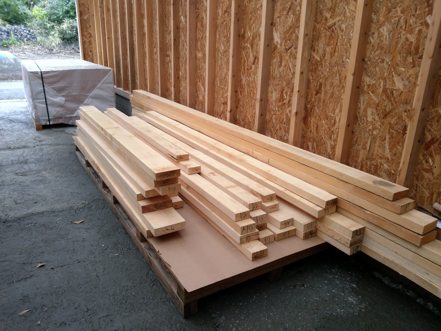

    There were so many delays and changes, but finally materials arrived to island. Shipping ended up costing much more than expected. Container shipping estimate by freight forwarded was completely off, but materials already were paid for and packed. Another big expense added due to tax being twice as high as estimated by customs initially. But at least i'm still within worst case scenario material costs, not happy but kind of expected something go wrong on first big import.
    What i'm truly not happy with is the timber from Edensaw, there are several pieces that have knots in them and if i'm not mistaken, it's meant for main beams. I was expecting all clear grain grade to be actually knot free and i did mention this specifically in order request too, that timber will be used for structural components in a boat. I will inspect closely when time allows. Right now don't have defect photos. Some small damage during transportation god knows where to plywood. But think should not pose any major problem.
    Now to some really bad news, at least for me. After the order was paid, preparations more or less ready my wife got really sick and was diagnosed with serious chronicall illness. 2 months in hospital and about a year left with relatives next to hospital with no guarantee to returning to somewhat normal life style, definitely no work anymore. Lots of complication from medication and huge bill to pay (yes, japan does have national health insurance, but it doesn't cover fully and has many exceptions that it doesn't cover) i'm trying to figure out how to continue. Returning and canceling the order at that point would generate way too big loss, i'm not even sure if that could be done at all. Anyway there is just no other option for me left expect to make this project work. One year sounds much less likely to happen now, with 2 kids to take care off, all house work and major financial extra expense can't really take time off for building as much as i wanted anymore.
    I barely managed to finish most of shed just in time for material arrival, in the end decided to cover floor with concrete, previous gravel-sand mix was just way too messy and most likely would add lots of frustration during building. Had access to free premixed gravel/sand that was used for temporal road filling, far from ideal ratio but usable. Living on a remote island, concrete is a luxury. So is simple clean gravel. Armed with small electric concrete mixer, shovel and a wheelbarrow i could finish covering 3.8m x 10m area in about 5cm of rough concrete with most places reinforced by 5mm thick metal mesh. At least no cracks during moving plywood pallet which weights over 1000kg.
    Only now i'm finalizing ordering tools, so update with actual build photos will come some time in future.

    The lumber looks beautiful. I would not be concerned with a small knot or two.

    5-6 knots 1.5-2.5cm wide that seem to go quite deep, one wide board about 15cm hollow spot at the end. I'm not sure if it's good or bad result for US market. But what i'm most concerned now is the amount, i went through all stock. Measured and numbered each piece since all of it is different. Instead of 444 board feet that was ordered i got 361, there is no room for any error now, in fact it's slightly less than what i have in BOM. There is also big variation in thickness. 2inch thickness actually varies from 4.5 to 5.5cm. Thicker pieces mean just a bit more work, but i'm not sure yet how to deal with 4.5cm since this is what i should be getting after planing, there is simply no thickness left to work on. I might go for lightest setting on a smoothing hand plane or maybe sand with fine grit paper on orbital sander to keep thickness as much as possible, sand until surface is acceptable.
    Most of tools i wanted arrived and now my 4*10m shed actually looks quite cramped. Will be a tight fit. Need some good planing to be able to rip timber and still walk more or less freely around the hull. But it's definitely fun work and i want to keep myself busy as much as possible anyway. I didn't rip such large pieces on table saw before, i've tried on cheap 4m 2x4 and need better support from both ends. Will try to find some roller solution to feed long timber more easily or just ask for help when going through bigger pieces, if someone helps to pull at a steady pace should give rather clean cut. Makita stock blade is more thick than i would like at 2.8mm, but right now can't really fork out more 200$ for a decent narrow blade with clean cut.

    Why would you plane the lumber?
    isn't al this lumber bedded in thixo? Or isn't the ply attached with thixo and screws?
    Using wood in a composite built would never require hand planing unless you use a plane to bevel a station frame or to do any other bevels not sawn
  12. xellz
    Joined: Jul 2017
    Posts: 124
    Likes: 6, Points: 18
    Location: Japan
    xellz Senior Member
    From BOM there is such a line "All timber is "PAR", or "Planed all Round". Thus sizes given are nominal, ie 2 "x 1" has a finished
    planed size of approx 45mm x 20mm." So i think of all surfaces being smooth as necessary step. Right now surface is really rough and not even, why i thought to go with a hand plane for thinnest boards, it gives me most control with least thickness loss.

    No!
    This is not needed. Planed all around is just a definition.
    You do not need to plane that lovely stuff down!
  14. fallguy
    Joined: Dec 2016
    Posts: 4,468
    Location: usa
    fallguy Senior Member
    Epoxy and thixotropic mixes bond well to rough surfaces.
    As long as you are using thixo mixes to bond things; don't start planing all that down.
    You need to cut for yield.
    Planing is ONLY down at this point for bevels needed.
    Please heed my advice. A sawn rip is a much better epoxy surface than something planed.
    If you watch TallyHo rebuild, then you will see some expert planing, but that is for a boat where only mechanical fastenings are used.

    Planning maybe required to square up or correct surface irregularities. Or only one surface mated to the plywood with the remaining exposed.
    Xellz
    You are victim of a supplier who figured you couldn't return the fallty wood. Edensaw may send a second correcting shipment, but don't hold your breath.
    One of the problems with remote building sites.
