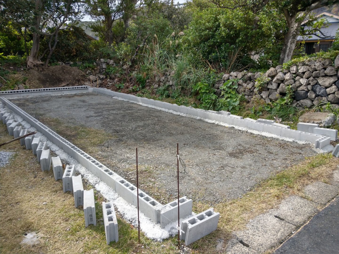

    And to add some photos in here. Instead of pipe framework garage with soft fabric building a simple shed using 2x4/structural osb. 10mx3.8m. There is a lot more work to do, but the price is quite close to pipe framework garage and i'm not running the risk of a sudden major leak with our weather. Run out of gravel/sand mix for the base, ground not perfectly level yet, but for now this will have to do. At least could replace right side soft soil layer with gravel/sand. First row of blocks is done, all pieces for trusses are also cut by now. It's time for second row and anchor bolts. Screws and polycarbonate roofing sheets somehow are delayed by quite a bit.
