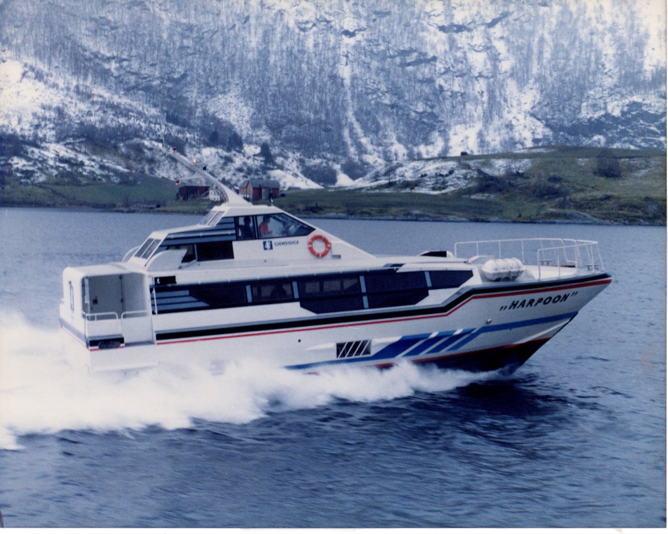

We built a small surface effect ship that had two of the early "Levi Drives" installed. Late 1980s. The take-off performance of that setup was terrible, and despite several changes to the propellers (Levis was directly involved in the project), the craft never behaved well. This picture is, in fact, one of the only ones ever taken of the craft "on plane", moving along at over 40 knots. It was quite light but with a number of 55-gallon barrels full of water placed on the deck in forward part of passenger cabin. Only moments after this picture was taken, the craft executed a hard-over uncontrolled turn directly in front of the 35-meter surface effect ship that I was taking the pictures from. The barrels full of water went nearly through the side of the passenger cabin...
And those steering shrouds..ugh...not very effective as it turned out.

Not having those drums tied down sounds like negligence.
In hindsight...it probably was. Nobody was anticipating any violent maneuvers or motions in the flat calm conditions. Fortunately, the only injury was to cabin bulkhead.
