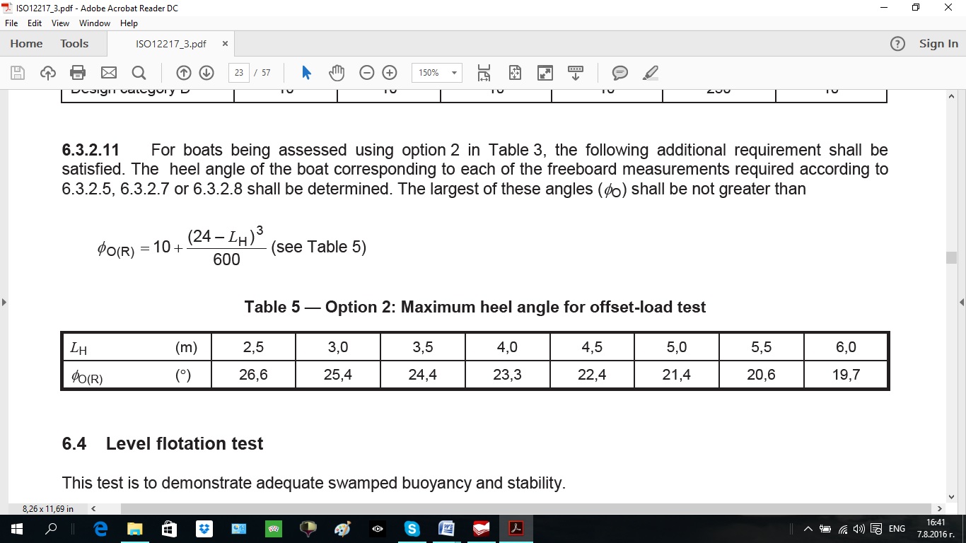

    Hii Everyone,
    Can any one send me the ISO document as mentioned , I'm currently working on a boat of 5.5 m AL , what will the max heeling angle permissible while conducting heel test ?

  5. valber
    Joined: Feb 2006
    Posts: 56
    Likes: 5, Points: 8, Legacy Rep: 97
    Location: Ukraine
    valber Naval Architect
  6. Rabah
    Joined: Mar 2014
    Posts: 247
    Location: Bulgaria
    Rabah Senior Member
