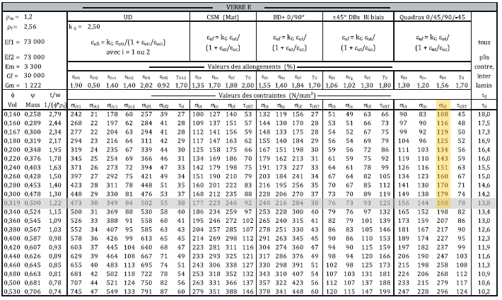

    Only one question is still above my head; calculating final properties for composite, I can`t find and get results as you, because I am obviously missing formulae designated as 7, picture in attachment.

    Yes you're right, it's my fault. This is a series of articles related to the use and understanding of ISO 12215-5 and I did not realize that in chapter 9 some formulas are mentioned that appear in chapter 7. I attach chapter 7.

    Thank you, now the story regarding composite Young`s modulus is complete, progress is slow but it is exists :)
