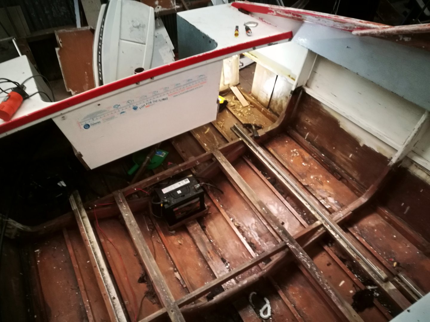

    This is a 1970's 17ft Pelin Plywood "Nomad". Not sure how globally popular they were but here in New Zealand they were well known. This is a family boat with a bit of sentimental value more than actual.

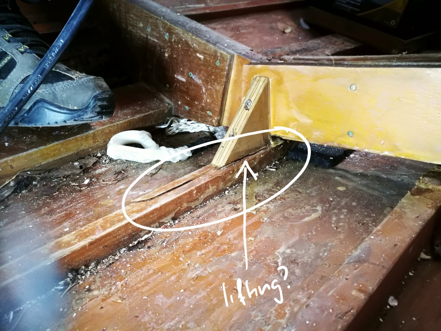

    I'm part way through replacing some rot in the outer ply and giving it a general once in ten years tidy up, repaint etc. Today I lifted the floor and began to climb around checking the frames etc, and to my horror, they seem to be mostly shot to heck.

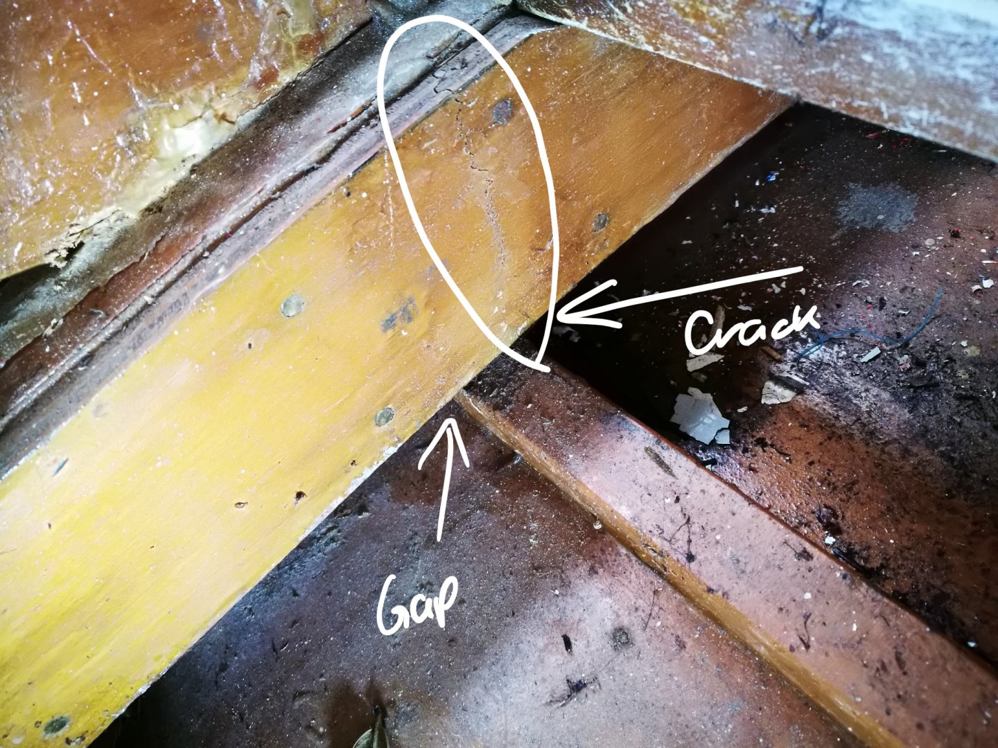

    Frames 1 & 2 (going forward from the stern not counting the transom) have multiple cracks in them and on the port side, the ribs seem to be separating from the frame to the point where I have a 1/8" gap between the frame and the rib in some places.
    Frame 2 has had some plywood attached to it at some point I guess as additional support which is also now cracked.
    Attached is a set of photos showing the various offences. I wonder if someone more knowing than me has any thought on how serious these are? where the frames turn to go up the sides appear to be intact as do the sides.
    I'm now trying to decide if this is now firewood, albeit that i love this boat and it would feel criminal to scrap it, but I can manage mildly complex issues on the boat (rot etc) but frames and the likes worry me about seaworthiness.
    Any and all advice greatly received, this is a gorgeous boat and sits so nicely in the water, but I don't want to get into it over my head or unsafely once the family is aboard.
    Thanks
    Brian

    You are wise to ground the boat if you have any uncertainty.
    From the pictures; it looks like something that could be repaired, however, it is extremely difficult to understand the root cause of the problems from these pictures; at least for me.
    The good news is modern chemistry, aka epoxy, can really support old wood boat repairs.
    But as far as I am concerned; root cause is simply too hard to define for me from these pictures. Another forum member might have seen this before.
    If you have rot; all of it must be repaired or replaced with good timber. A frame can be repaired with laminated sections rather than replacing the entire part. It all depends on how extensive the rot is...no rot can be left in a structural component.
    Find a wood boat guy locally.

    If you look in the back of one of the photos the rot was isolated to one area where the port joined the transom. I've cut it all out plus a safety margin of about 10% and have no issue in repatching the ply and reskinning the transom part with appropriate materials. That is reasonably easy to fix.
    I can't find any sign of rot in the frames, just some hard cracking and separation from the frame. I can replace the cracked ply "laminated patch" on the frame shown, those don't worry me so much. I am not so confident however on removing the screws in the rib joints and "re-fixing" them to the ribs as I just know nothing about the physics going on with ribs/frames related the structural integrity. I'm also concerned about what might be causing it, the old symptom v cause issue.
    Is the gap forming possibly a symptom of something I can't see? Aside of a couple of dock rashes the rest of the hull is in good condition. I'm really struggling to find any local help on this as everyone in NZ owns a boat and no one wants to look at the older ones. I was happy to pay a boat builder to fix the rot for me, but none were interested, it wasn't even a price issue, they just weren't interested so off to youtube and forums I went.

    If you hang or push on the gunwale near the frames in question, can you see if the gaps are moving or changing?
    My hunch is something else weakened and caused the gaps.
    Like a problem either at the gunwales or the stem.
    Sometimes it takes more than one person. One would push or pull on the hull gunwales or stem or keel from underneath or the sides while the other watches the areas in question.

    Yes. You want to understand what is allowing the gap, so you are looking for other areas of trouble, like the keel or some more rot.
    The strapping might fool you. Better to watch while a 200 pound fellow hangs on each gunwale.
