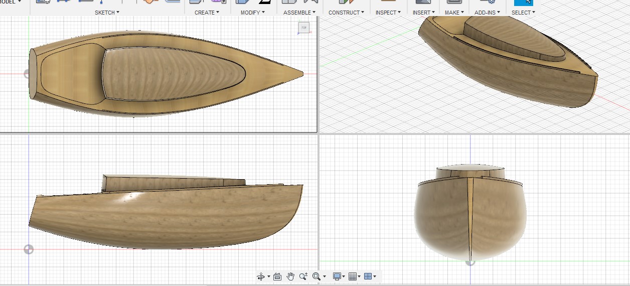

    Hi, i am a novice naval architect. I try doing a sailboat design for fun and self-development. But i can't assess whether it is adequate for a ocean crusing or or not. I would ask for your opinion based on your experiences. Thanks in advance.

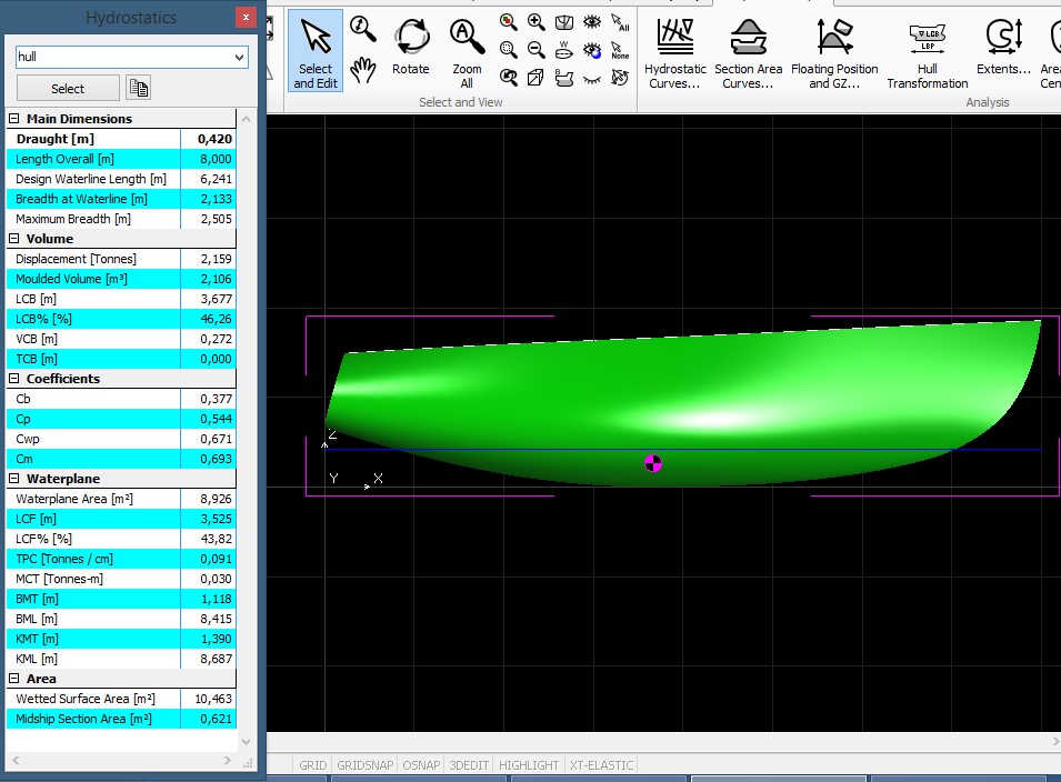

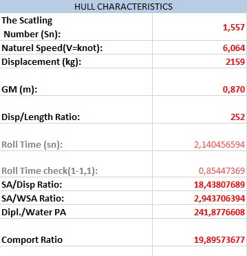

    Here is the some spesifications:

    It looks like you're getting the hang of the design program nicely. If the waterline is that blue line then the boat will be dry but bobbing around and slow,...safe and uncomfortable. Everything you add to the hull to make it a sailing boat will obviously effect its sea keeping, but more waterline length and a little less freeboard, more beam, and a little less rocker would help, it's like a scaled down 50 footer, it looks good though. I have a lot less experience than many on here and no qualifications, so happily choose to ignore this if you like, cheers.

    A boat being a three-dimensional object, it is best to show it in 3-D.

    Thank you so much for your answer (both of you). 'trip the light fandango', this answer is so valuable and instructive feedback for me. I will try to apply those advice to the hull one by one. Yes 'blue line' is water line. When i lengthen LWL and Beam, won't it cause a decrease on Comfort Ratio?

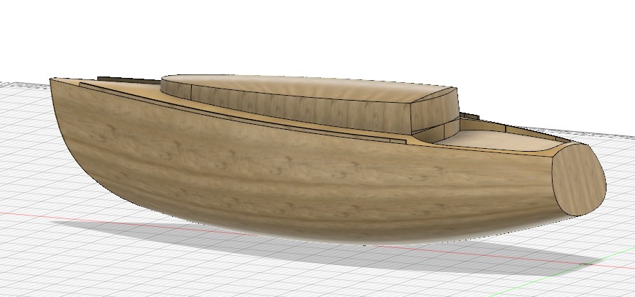

    Mr Efficiency, my first aim is to develop myself about what good spesifications of a boat are, rather than its appearance... (i feel i have a lack of knowledge about naval architecture), but here are other pictures: (i continue the design). Have a nice day.

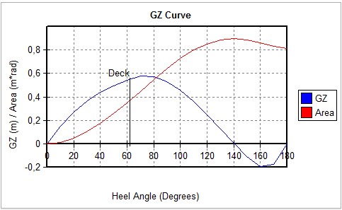

  6. Pammie
    Joined: Dec 2015
    Posts: 109
    Likes: 16, Points: 18, Legacy Rep: 10
    Location: Eindhoven, Netherlands
    Pammie Senior Member

    Your design so far is lacking a keel, skeg or centerboard. A hull form with so little lateral resistance will not sail to windward very well.

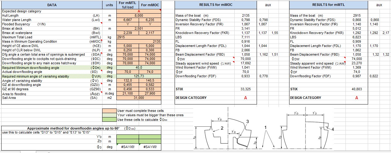

    You are right Pammie, Gz curve is no meaning unless checking it based on some rules. Thanks for that you lead me to some informations. I have read and used it. When i calculate the STIX number, the hull drops to catagory A, but it doesn't meet Required Minimum Righting Energy :), i think i need to increase diplacement.
    Waterwitch, The keel issue is in my mind also. i think it is next thread topic:)

    Yes, but it will be more satisfying because you will travel faster and have more room. Study up on the best modern cruiser of that length, look at the best , study the masters chronologically, and work out why, appreciate them.. Outright speed is nearly always less comfortable, but sitting out in bad weather in a small boat when a faster craft would have you back in sheltered water hours ago would also be uncomfortable. I live near Bass Strait. Beam seems to the best compromise though, wide sugar scoop sterns, room and speed, ..or a folk boat,..

    No disrespect intended, but the boat has gone from looking like a snow pea, to a clove of garlic. Progress is being made !
    :D

    Mr Efficiency, i accept with your opinion completely:). It has no a good view for now (maybe never if i can't evolve my skills). I think i have so long way:confused:
