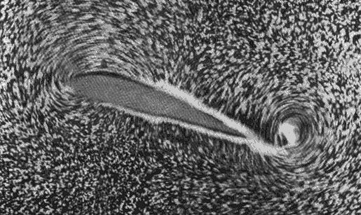

    Theory of lift plus calculations, after he'd described how it works. I also recommend his 2D shot of flow visualization of the (horses shoe) vortex formation on the leading and trailing edges before lift is developed.

    Hydrodynamics is the continuum statement of Newton's second law. This is not like a model. Circulation is conserved. Circulation cannot end in mid-stream, it can only end on a solid surface or other boundary like a discontinuity between two different flow strams (or water and air). The tip vortex from a wing, shown in flow visualization, extends over the wing (providing the lift) and ends on the fuselage. Prandtl's 1930s era flow visualization is valuable: in the rest frame of the fluid it shows the horse shoe vortex forming near the leading edge and near the trailing edge. This vortex extends around the wing tip and ends on the fuselage near both the leading and trailing edges. As the wing speed increases the trailing vortex slides along the fuselage, because it experiences a downward lift and is not 'pinned'. It slides and finally slips off the fuselage to form the tip vortex , which experiences no lift because it moves without hindrance in the free stream. There is no substitute for circulation conservation.
    Prandtl's flow visualization photo can be seen in von Karmann's 'Aerodynamics', Dover.

    I don't know where all the confusion comes from. What Wagner ref. do you mean? I add that I have no interest in unsteady flows at large attack angles. I'm interested in steady flow at small attack angles.
    A vortex sheet forms on the planing hull bottom and extends backward as the wake on the water surface after the trailing vortex is shed (that's when the entire transom becomes dry). A vortex sheet is a velocity discontinuity, and is described mathematically by a density of vortex lines transverse to the flow direction. The velocity discontinuity gives you half the circulation you would get from both sides of the mean camber surface. There is nothing difficult about any of this.
    Where in hydrodynamic theory is there any case with flow equation from where large L/D is generated without circulation-?!
