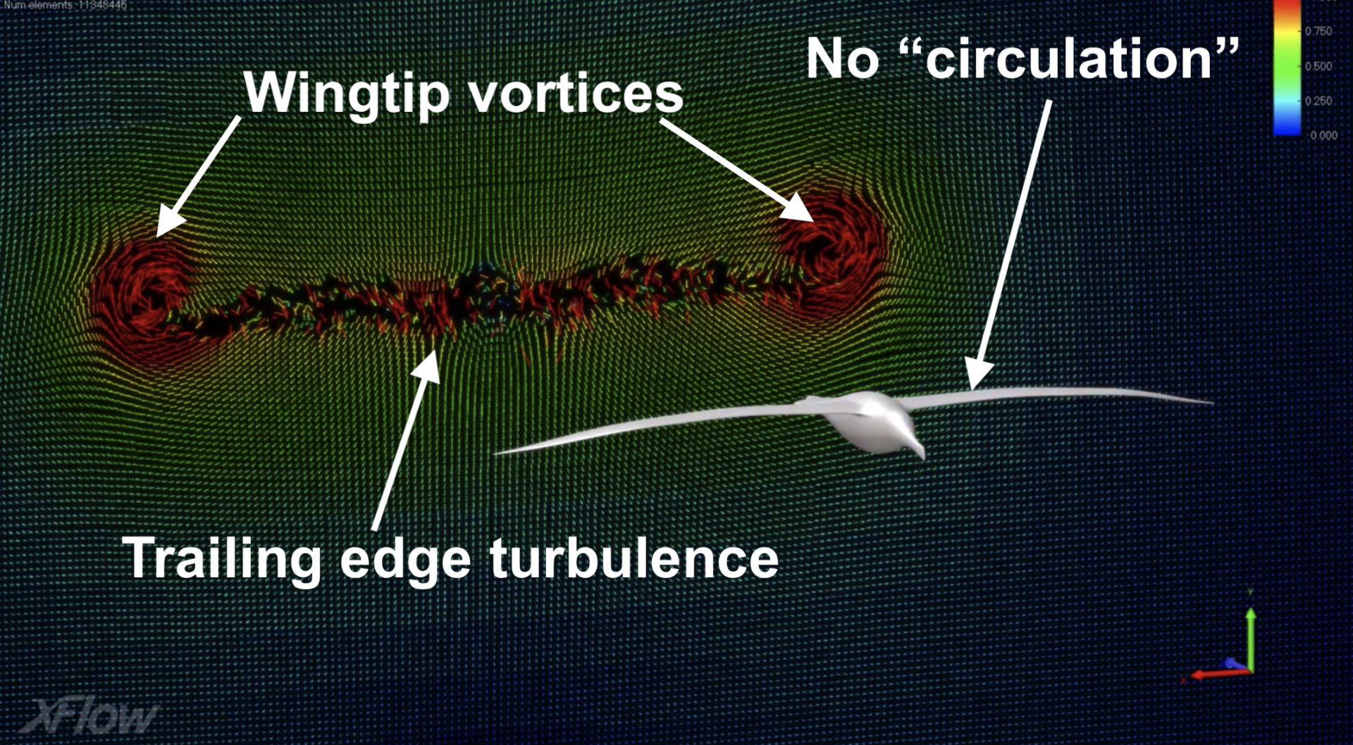

I don't have the Tawny owl, but this albatross shows the same thing, enough to convince me that the world's most respected CFD code is accurately reproducing reality. I could post the video so you can see the similarity of the tip vortices rolling & the downwash.
I don't see any "circulation" around the albatross's wing, just wingtip vortices and some turbulence behind the trailing edge.
Now you're showing a CFD image that doesn't even contain the phenomenon to demonstrate a non-existent phenomenon!
I'm starting to realize how all time spent speculating with you is time wasted. "When you use a CFD model to demonstrate a physical phenomenon that doesn't exist in nature, you are just demonstrating that the model is wrong." Just showing you that XFlow is quite capable of demonstrating natural phenomena.
Here's "circulation", well, "the flow pattern", demonstrated around the mid-body of the same albatross... I'm sure you'll find something offensive to comment about it, too.
