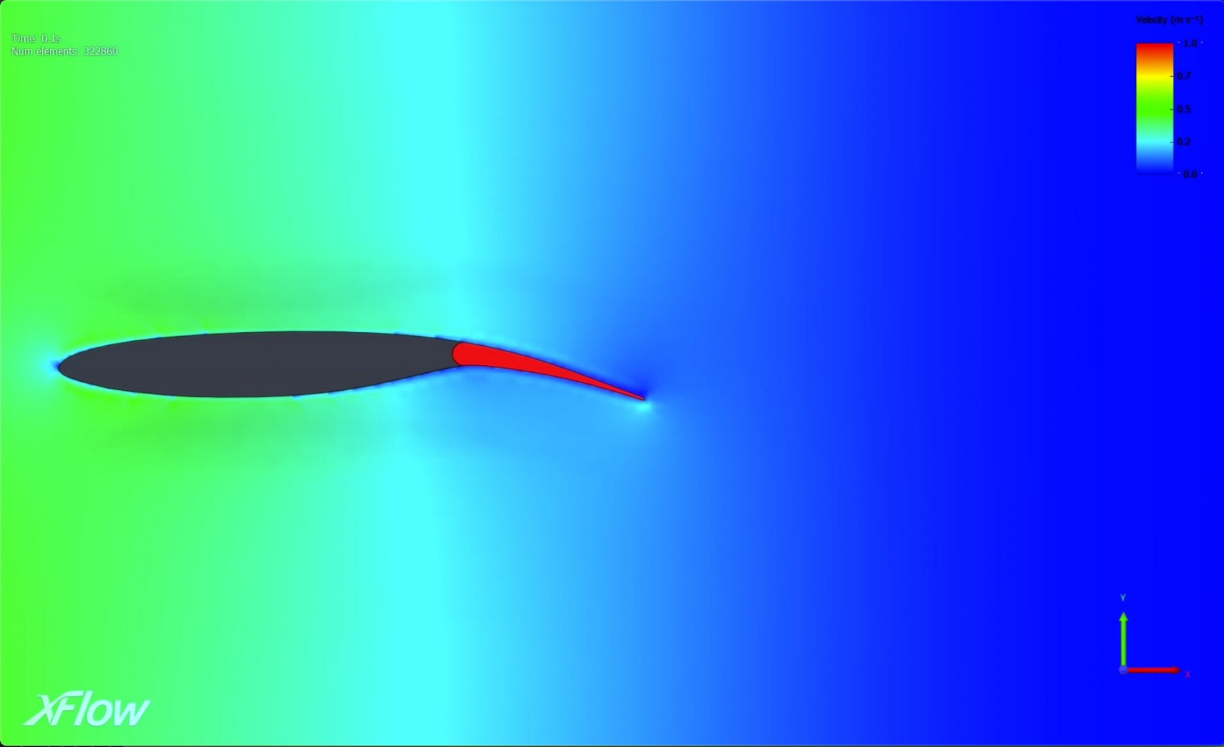

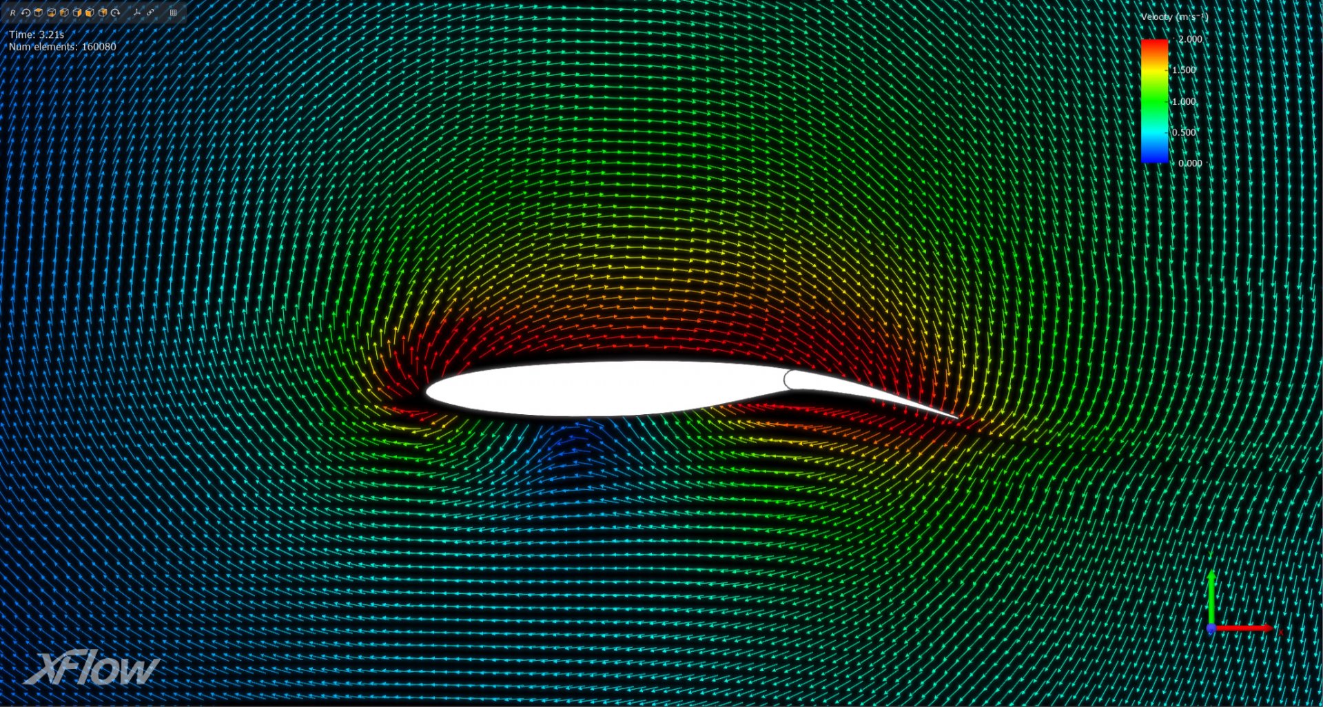

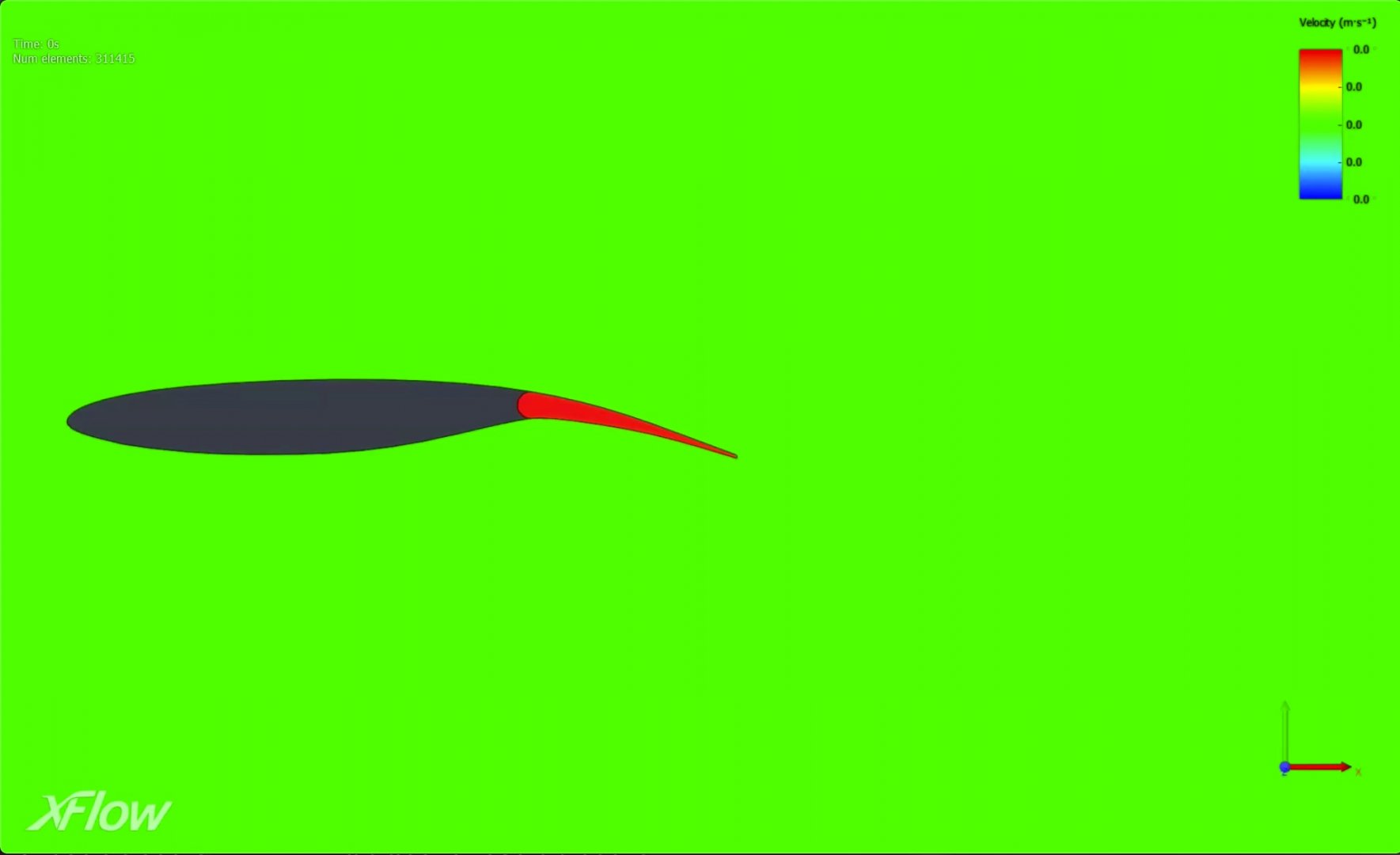

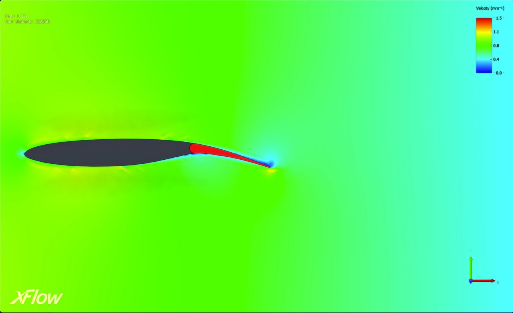

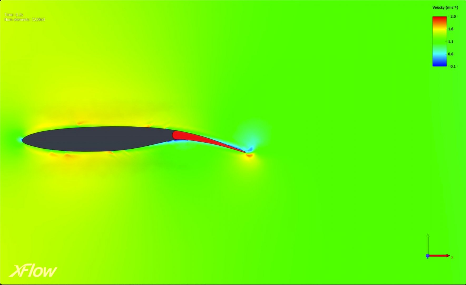

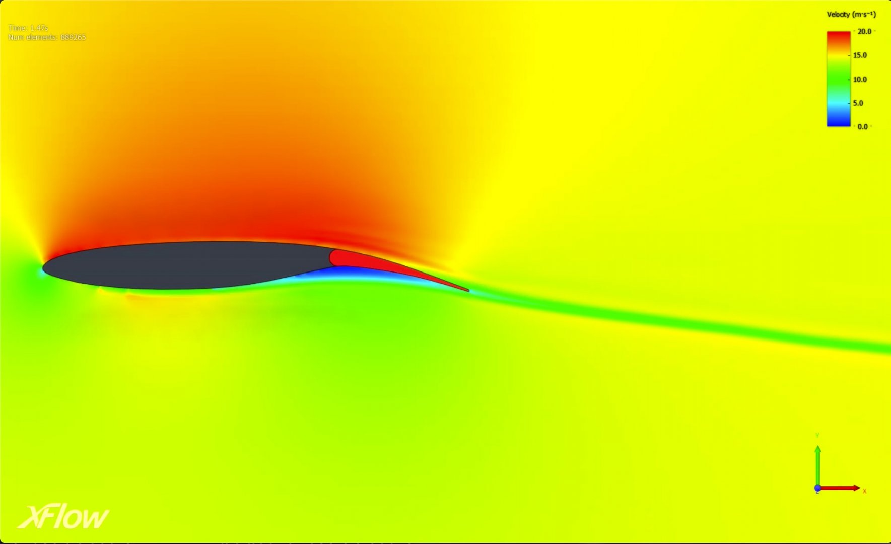

@DCockey I beg to disagree. Once again, you've educated us in the art of aerodynamics, corrected my misinterpretation with regard to the necessity of a starting vortex, and inspired me into running some new simulations around the topic of circulation. I enclose some screenshots, more later when I find the time. This is in an accelerating flow, from 0 to 20 m/s, the number at the end of is flow speed at the inlet of the flow domain. The profile is courtesy @tspeer, one he designed to study cavitation on the latest AC75 foils, I mean to do some more work with it later.

@Mikko Brummer Initially you said:
..and the starting vortex creates the circulation in the opposite direction, around the foil, while itself being left behind.
Then
The very simple answer is the starting vortex does not "create" circulation.
And now you reply:
@DCockey ...you've educated us in the art of aerodynamics, corrected my misinterpretation with regard to the necessity of a starting vortex, ...
@Mikko Brummer Having had the foundation of your interpretation ("the starting vortex creates the circulation") identified as a misinterpretation by @DCockey, I just don't see how you can continue to claim validity of the circulation theory.
Are we still talking about circulation as the mathematical construct from vector calculus ( "the line integral of the vector field around a closed circuit") or are we talking about something more general that can be measured and observed?
Having had the foundation of your interpretation ("the starting vortex creates the circulation") identified as a misinterpretation by @DCockey, I just don't see how you can continue to claim the validity of the circulation theory.

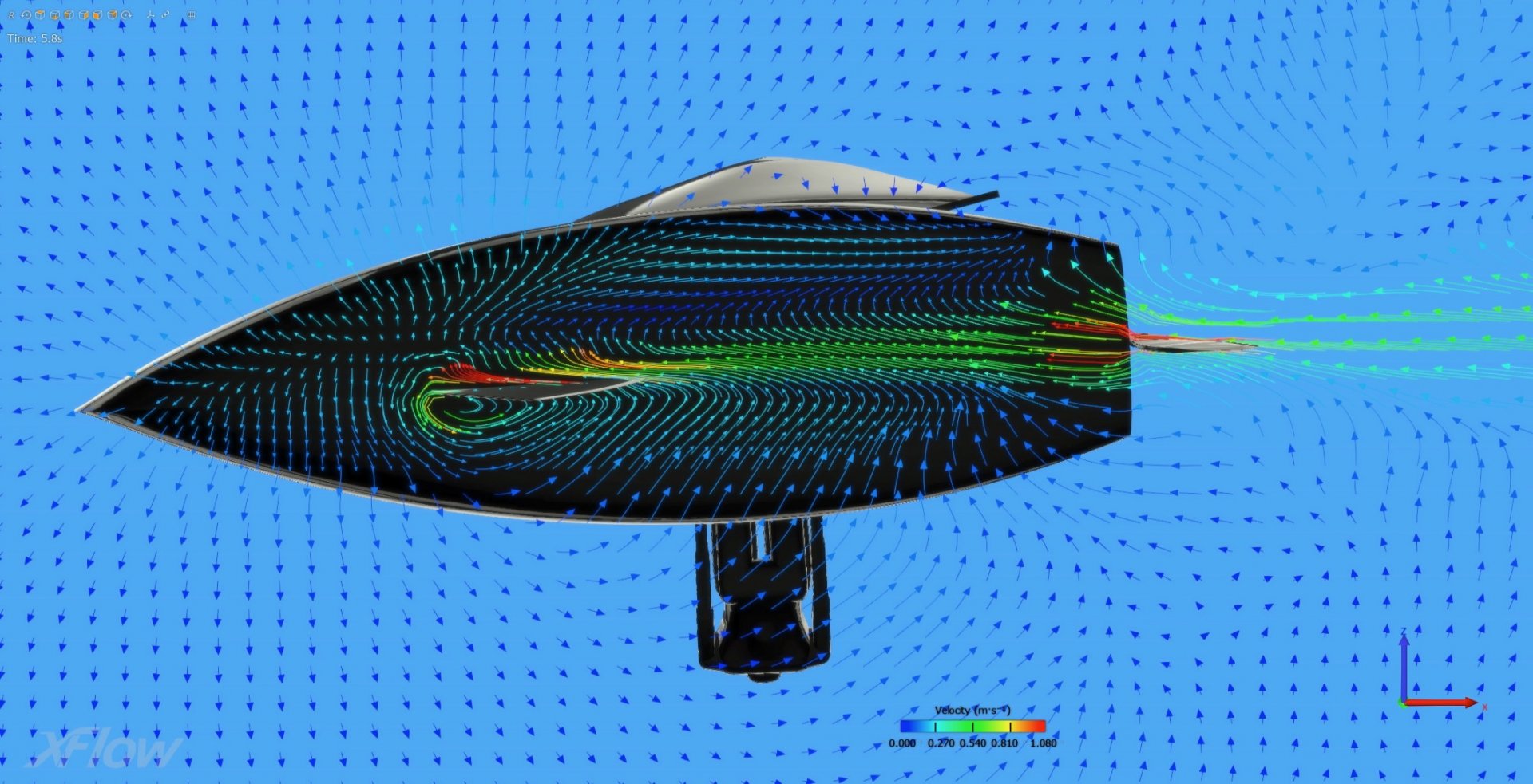

The starting vortex is by no means "the foundation of my interpretation of the circulation theory" ;-). I used to think it was just a mathematical theory, but during the years I've learned through simulation that the physical flow around a lifting surface actually has a resemblance to what the mathematical model of circulation theory describes. Please read my first few postings at the beginning of this thread (and then all of the thread). Attached see "circulation" around the flat centreboard of a Finn dinghy. The simulation software (XFlow, the state-of-the-art Lattice-Boltzmann flow code) has nothing to do with the theory of circulation, yet it shows a similar flow pattern.

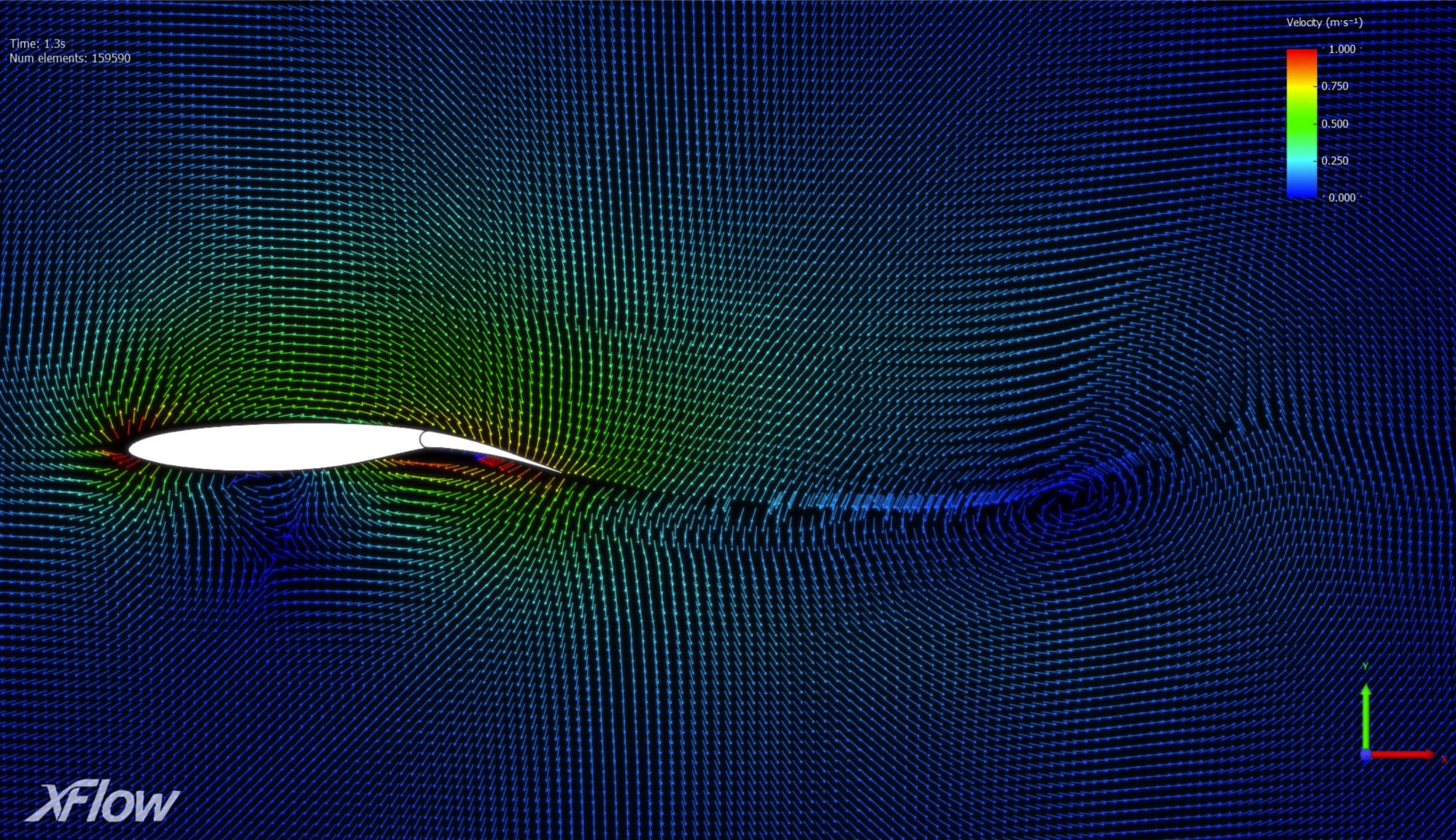

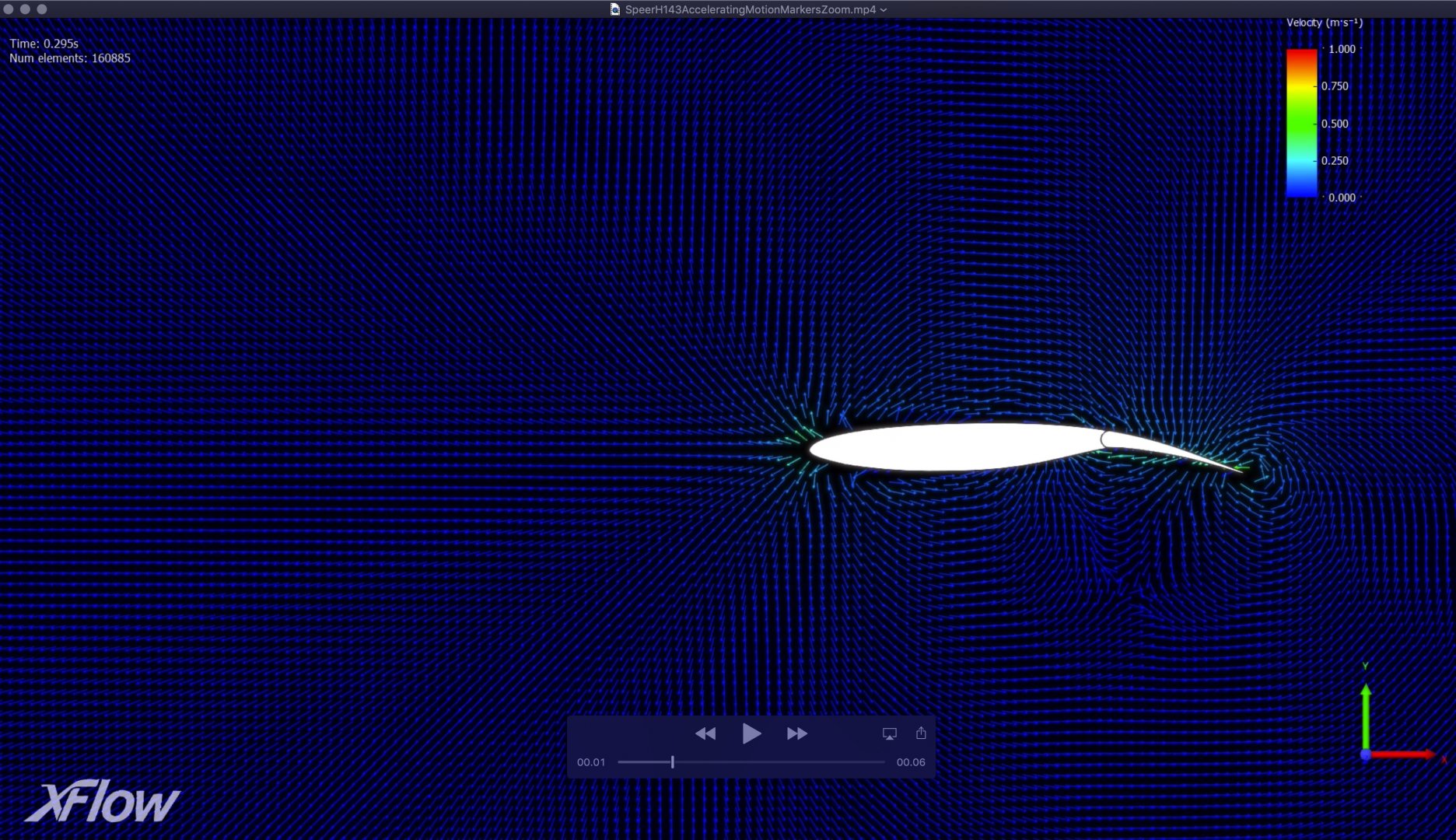

Here's from a simulation of the Speer profile, accelerating from the rest in still air (or water), at the rate of acceleration time^2. In the first pic, the speed of the profile is 0,09 m/s, in the second 1,7 m/s. Something is happening at the trailing edge of the profile, and something is left spinning in the location of the starting of the motion. The little arrows are velocity vectors of weightless "markers" moving with the flow.
One more about the fully developed flow at 10 m/s. Note that the "circulation" velocities of the markers are not huge - red colour is 2 m/s.

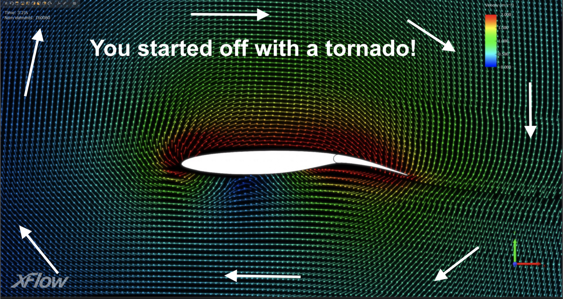

Mikko, the velocity that the picture shows must be the perturbation velocity. That is the snapshot of the velocity, that an observer at rest sees, when the boat moves past him. If you superimpose to the perturbation the boat speed, you get a picture that is more like the ones, that we are used to see in a wind tunnel, or when we move with the boat. If my interpretation is right, then I would think, that the vortex at the tip of the centreboard shows a separation bubble. This separation vortex can create a lifting force through the pressure field at the leading edge, if the leading edge is sharp and the flow reattaches (see Leading-edge-suction-analogy by E. Polhamus). The total circulation, created by the centreboard's sharp trailing edge, is difficult to spot, because it is disguised in this picture by the drag of the hull, which creates a perturbation towards the front (slowing the incoming flow) and to the sides (displacing the incoming flow).
Your last picture #193 is much better suited to show the circulation. All the arrows in the picture, the complete perturbation velocity field that is created by the moving airfoil, are describing a circle around the foil. The further away from the foil, the more perfect is the circle. This is exactly the potential flow solution of an airfoil that creates lift. The equations for potential flow enable us to calculate the lift-force if we know the strength of the circulation, or vice versa we can determine the strength of the circulation if we know the lift-force. If you add the vectors (arrows) in the picture to the vector of the incoming flow, you get the picture that you see, when you are sitting on the foil. So the circulation is real. The total flow is the superposition of the incoming flow and the circulation around the foil.
