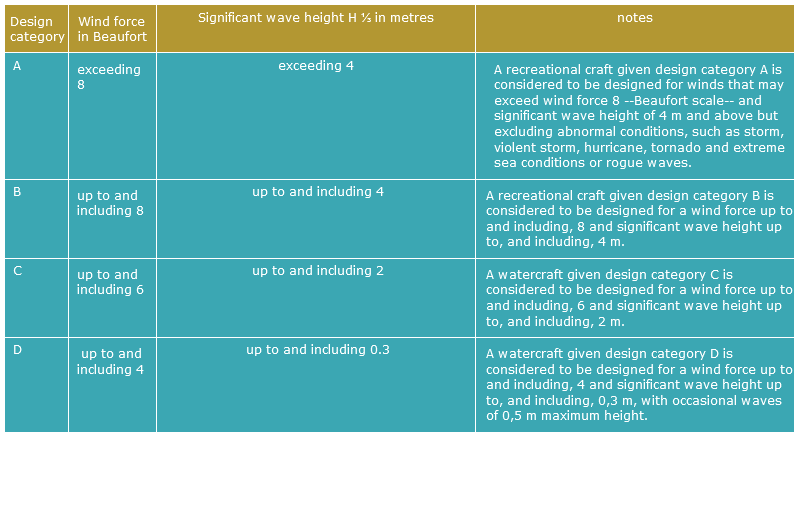

    Does this mean that ALL of those means of prevention listed must be included, or is this an example of some means of prevention that could be used. For example, if there are hooking points are guard rails still reqired?
    Also, what determines the "design category" of a vessel used in those tables?

  12. Waterwitch
    Joined: Oct 2012
    Posts: 172
    Likes: 44, Points: 28, Legacy Rep: 20
    Location: North East USA
    Waterwitch Senior Member
    A quick internet search will describe each design category, A being ocean crossing vessels D being inshore protected waters with different wind and sea states to be operated in.
  13. Alan Cattelliot
    Joined: Jul 2021
    Posts: 524
    Likes: 220, Points: 43
    Location: La Rochelle (Fr)
    Alan Cattelliot Senior Member
    Yes, you're right Waterwitch. Please find downbelow the definition of all the design categories :
    To use the tables 3 and 4 given in the post #22, you shall :
    - determine the design category of the boat ( ! Besides being related to the navigation conditions, the stability index of the boat, called STIX, establishes properly the design category of a recreationnal craft <24m )
    - choose an option
    - verify all mean of prevention marked in the table.
    For example, the very beautifull 15' sailing monohull "Sally Gee", showed in the post #3, may be in D design category ( a feeling... only stability calculation can tell ).
    Only one option in available, the option 6. So to be ISO compliant regarding the man-over board prevention, the deck of the boat should be equipped with :
    Slip resistant surface -> present on the roof top, so roof top is part of the deck
    Handholds -> in that case, It may be considered that the bulwark can be used as handholds. De facto, it may be used as is. Are the handholds on the roof really usefull, or are they more used as footstop ? I don't know.
    Mean of re-boarding -> Considering the low freeboard, it may be considered that it is not necessary to add a specific re-boarding ladder. You may use the rudder and adjacent rail to re-board.
    It should be noted that, with option 1, hooking points & gard rails are mandatory, if the boat is intended to be ISO compliant.
