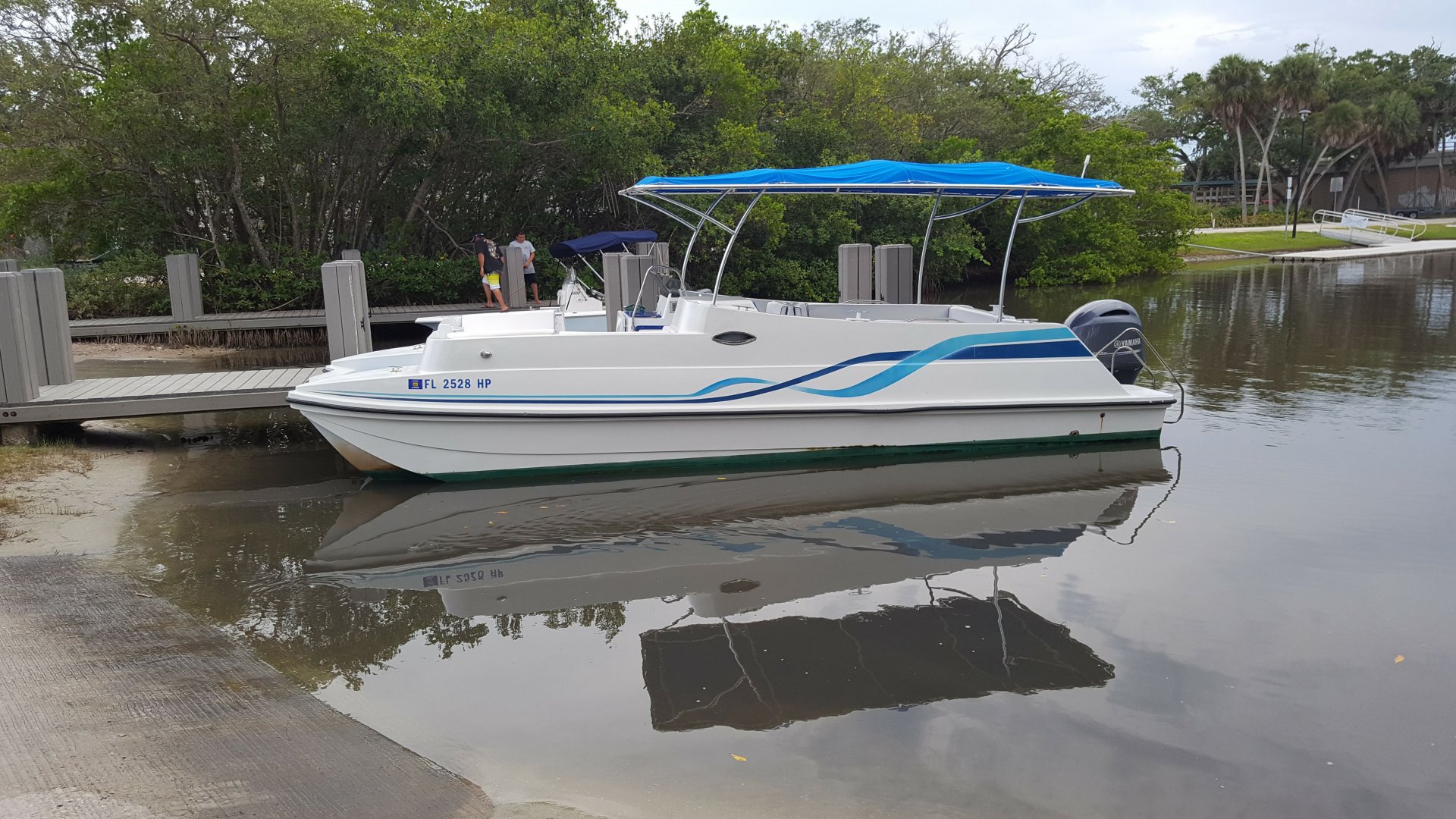

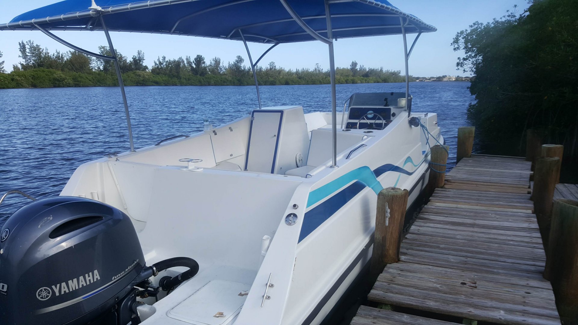

The boat will be used for private tours .. the marina it is jeep at can not facilitate a vessel more than 32 ft .The shallower the draft the better ...it is extremely shallow in the area .my current vessel draws 18 inches which works well and is a 26ft catamaran . And I really like the set up on my current vessel except the not being able to have more than 6 pax.
There are a lot of boat builders where I am ...but none of them wants to mess with a commercial vessel under 40 ft .
I will post some pictures of what I am thinking.
Yes I can buy the pontoon style boat....but they are not nice enough for what I am doing .
The bottom boat is my existing ...i will post a better pic

Ok, so we have a maximum length of 32' for your marina - are there any limits on the width of the vessel?
For example, could you have a 32' x 16' power catamaran?
Re '10+' passengers, how many do you want the boat to be able to carry, bearing in mind that the rules get more rigorous (I think) once you go beyond 12 passengers?
Is it not possible at all to get your current boat rated to carry more people?
What make is she? Do / did the Builders ever produce a slightly larger version?
What is your proposed budget for this vessel?
If you need shallower draft and more carrying capacity, a monohull is the only solution. Depending on the operating conditions a flat bottom or a very shallow vee. Can you use a jet-drive?
