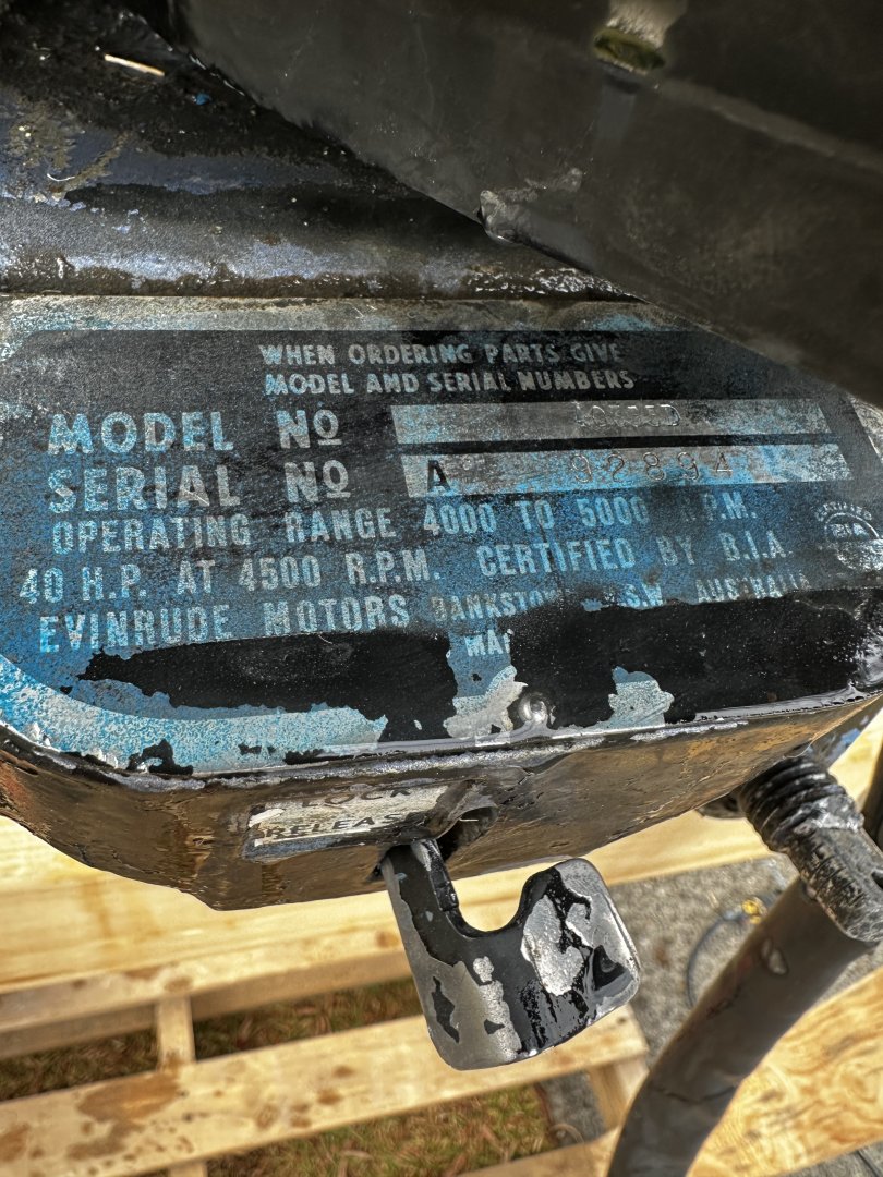

    Ronnie I'm wondering if you're focusing on the wrong thing? That motor is bred from 28hp's in the 1950s, and your's would have to be early 1970s, 50 years mate, and most of us wild colonial lads don't have the luxury of fresh water running. The manufacturer went bust in about 2000, and parts will be a hassle, not to mention spending 2 bob on it will exceed the value of the motor. Have a look at the Parsun 4 strokes, they aren't bad at all.

    Somebody has painted the cowling and put some vinyl decals on it, so impossible to date from the lid. Do you have a model number on the transom bracket? Serial no. is irrelevant with Johnson/Evinrude, except for insurance etc.

    I know it has been painted. I have a rough photo of the serial number. Mother has compression spark and I’m assuming the previous owner did an oil change as I checked that and it was good clean oil with no signs of metal shavings in it.

    Probably no bearings in the gearbox anyway, a lot of them had sintered bushings. Plus the split gearcase makes resealing a breeze if necessary. They have points and condensers, and we used to use a factory tool to set each piston at the correct point. I reckon some Youtube whizz has a home built tool for setting points. Very prone to seized splines between driveshaft and crank. Give it a new impeller annually, grease relevant bits etc, splines never seize.
