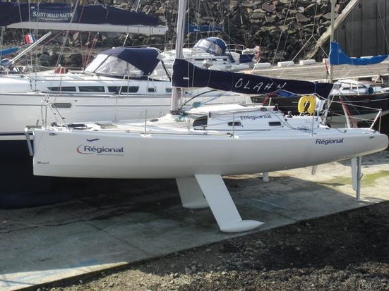

    As for double keelers, the only one I sailed was this handsome racer:

    The second tween keeler above (9,60 meters) won the "transquadra"(cross atalntic amateur race), will rent it for a week in September I think.

    It's the "Olea 32" (previous name was Bongo 960), Architect Pierre Rolland , you can also rent a smaller Olea 30 (8,70 meters), similar design also twin keel in la Trinité sur Mer :
