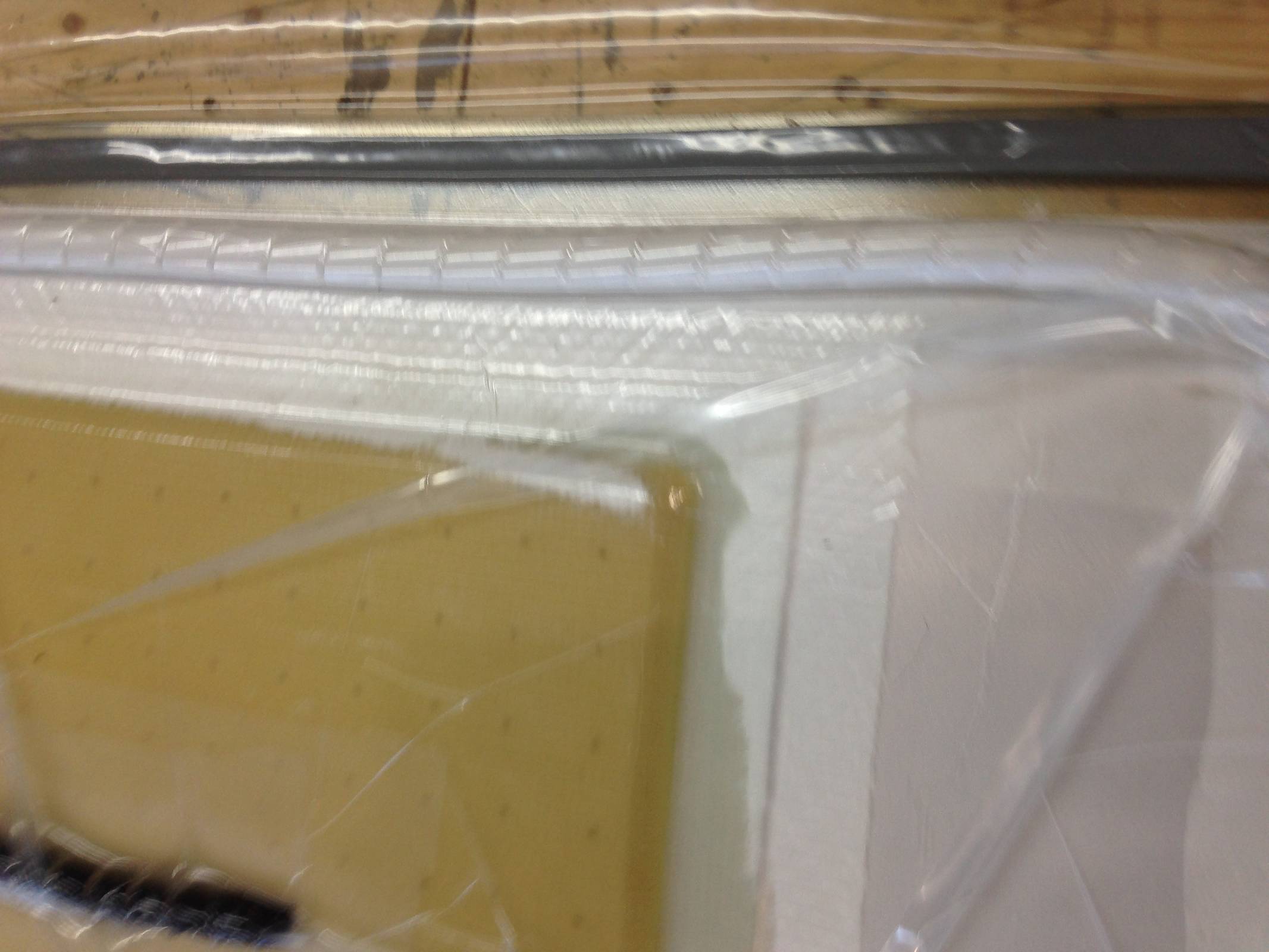

infusing groove cut foam
Bottom/groove side hitting the resin break. Was 2" all around still filled pretty quick with just perforations and peelply on the top side

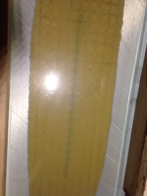

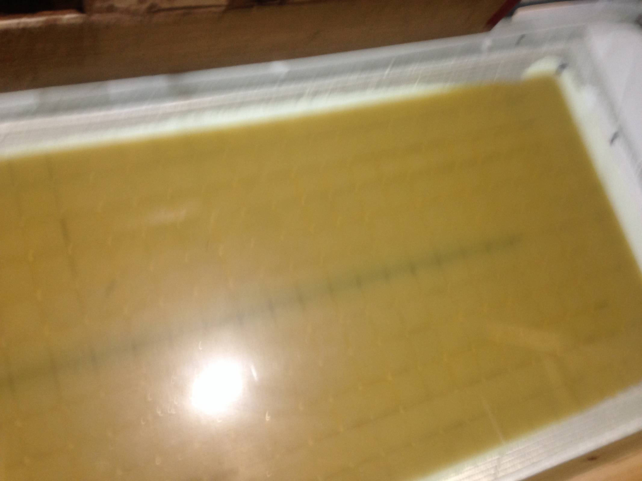

Finished in 6 minutes, piece is 14" x 30" mold side 1600 gsm top side 800 gsm
Nice, first time I see an infusion using grooved foam. It's what I want to try next. You save so much plastic too flow media and per film.
Ya less resin used and by the looks of it it will go a long ways.
Less resin total perhaps, but more stays in th panel so slightly heavier. Unless the panel is extremely weight critical, the the grooved foam is by far the best option... I did the entire cabin top of my boat and maybe the floor too- can't remember now- and the infusions were really easy, quick to setup, less plastic waste in the bin, etc etc it's just better all round... Over here the difference in price for the grooved foam vs plain sheets is only a few dollars per sheet... So it's a no brainer really unless your building a full on race boat where your trying to save every ounce of unessesary weight... On a large boat the difference could be hundreds of kilos...
You can pull the resin at least 2 meters across via the grooves- probably more but I know at least 2 meters... With more experiments I'm confident it might go 3 meters?
