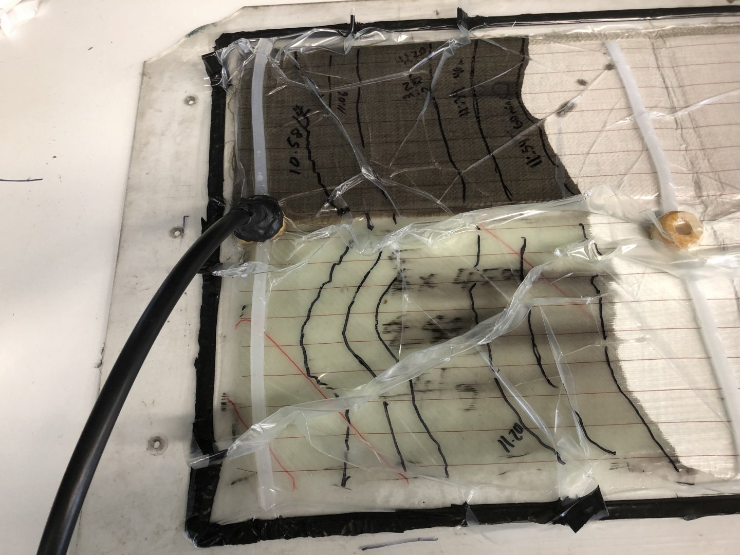

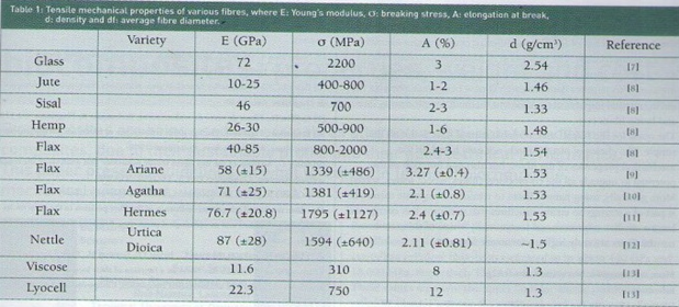

    Thank you. Seems that the idea can work. I like the idea of powerdrills. I have one without a battery, I could use that and attach some lithium batteries. Would be probably enough for what I need.
    He mentions that the fibre choice he did wasn't optimal, but I can't find which fibre he has used.
    Also he tested with just a single layer of fibre and it was super stiff, which is what I thought.
    Thank you again! :) I was really discouraged insofar for testing the XPS/epoxy/fibre idea.

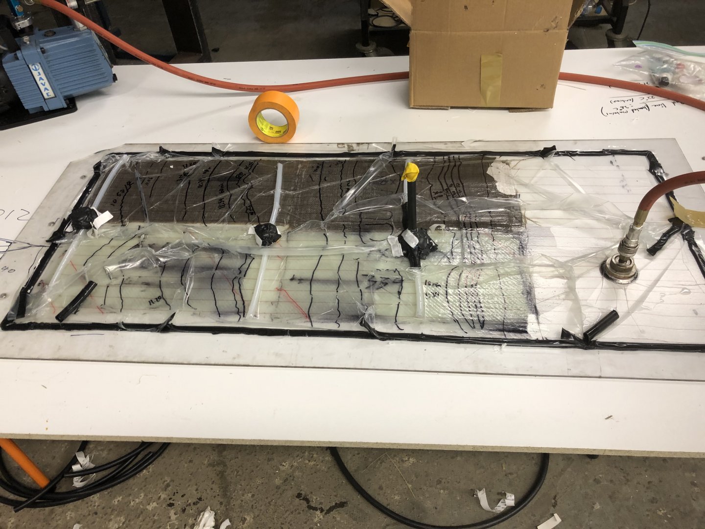

    An another idea I've found, regarding "canoes" (and a bunch of other ideas). Video of a sailboat version:
