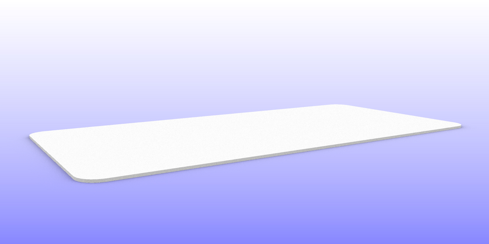

    This is a sketch of what I want to produce:
    The borders are exaggerated, I would like them just 3-4 mm thick.
    My idea would be to shape an xps foam for the base and lay a plexiglass so that at least the bottom will be smooth.
    Will it work if I apply another plexiglass sheet on the top?

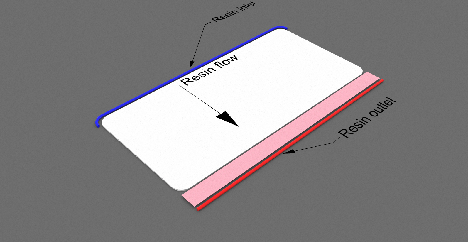

    Something like this?
    I will do some research on this

    Yes, but think of it as vacuum outlet, not resin. There should not be any resin in the vac line, or need for a catch pot if you do it right..

    Yes, I should have written vacuum outlet. As this will be my first infusion, a catch pot is mandatory otherwise it could become my last one :D
    How many feeding lines in the inlet do you recommend, just one in the middle or more?
    Same question for the outlet, thank you :)

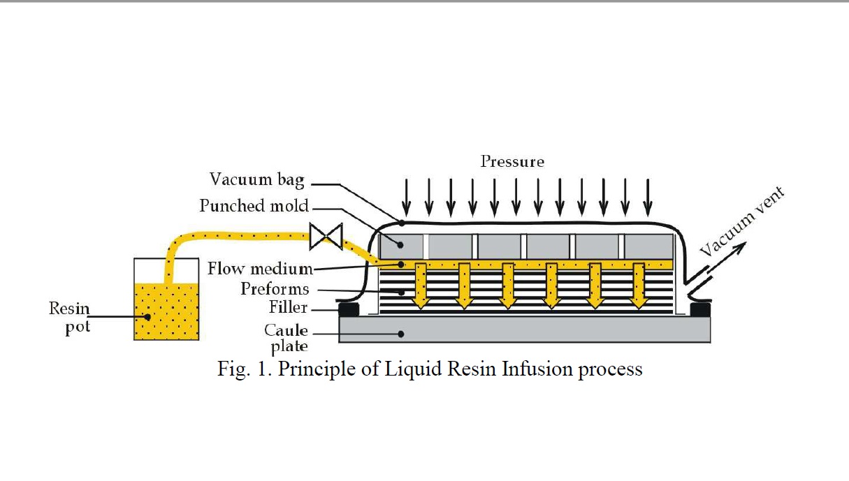

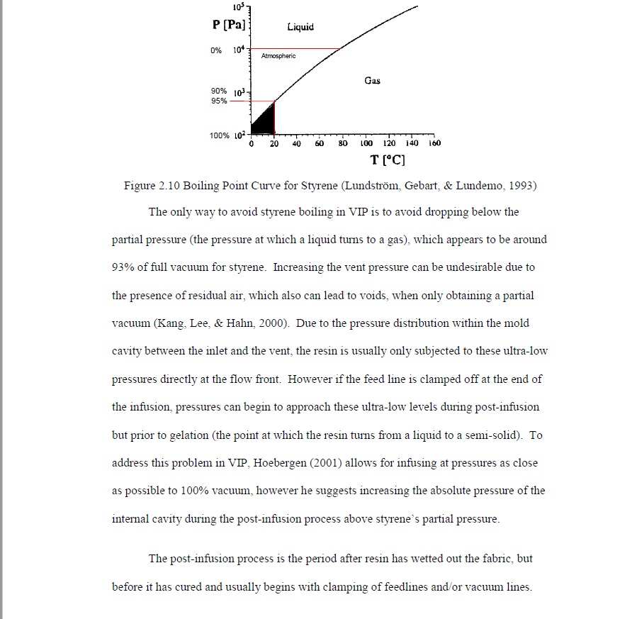

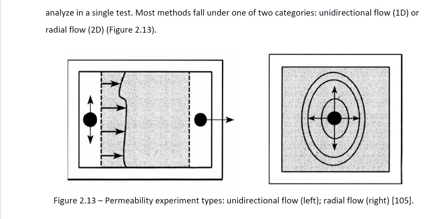

    Resin Flow is always radial and the best result is the feed is at the bottom and resin is pulled by vacuum from the top edge. If you want it from left to right with two side simultaneous, You must have a resin distribution/flow pipe/spiral tube from the feed line so that both upper and lower fibers are fed at the same time. On the opposite end is a flow medium a vacuum cut off and a resin trap. The diagrams should help you figure it out.
    Just watch out for styrene outgassing if you are using poly as illustrated in the article.

    Thank you very much for the schematics rxcomposite. I am going to use epoxy both for strenght and no vapors.
    I will try to refine more my drawing for the intended placement of resin distribution pipes

    Always use more vacuum ports than resin feed so you can have more control over the resin front. Say 1 resin port= 2 vac lines. 2 resin port=3 vac lines. Once the resin flow has reached its destination or the resin catch can is starting to fill, close the connecting vac off.
