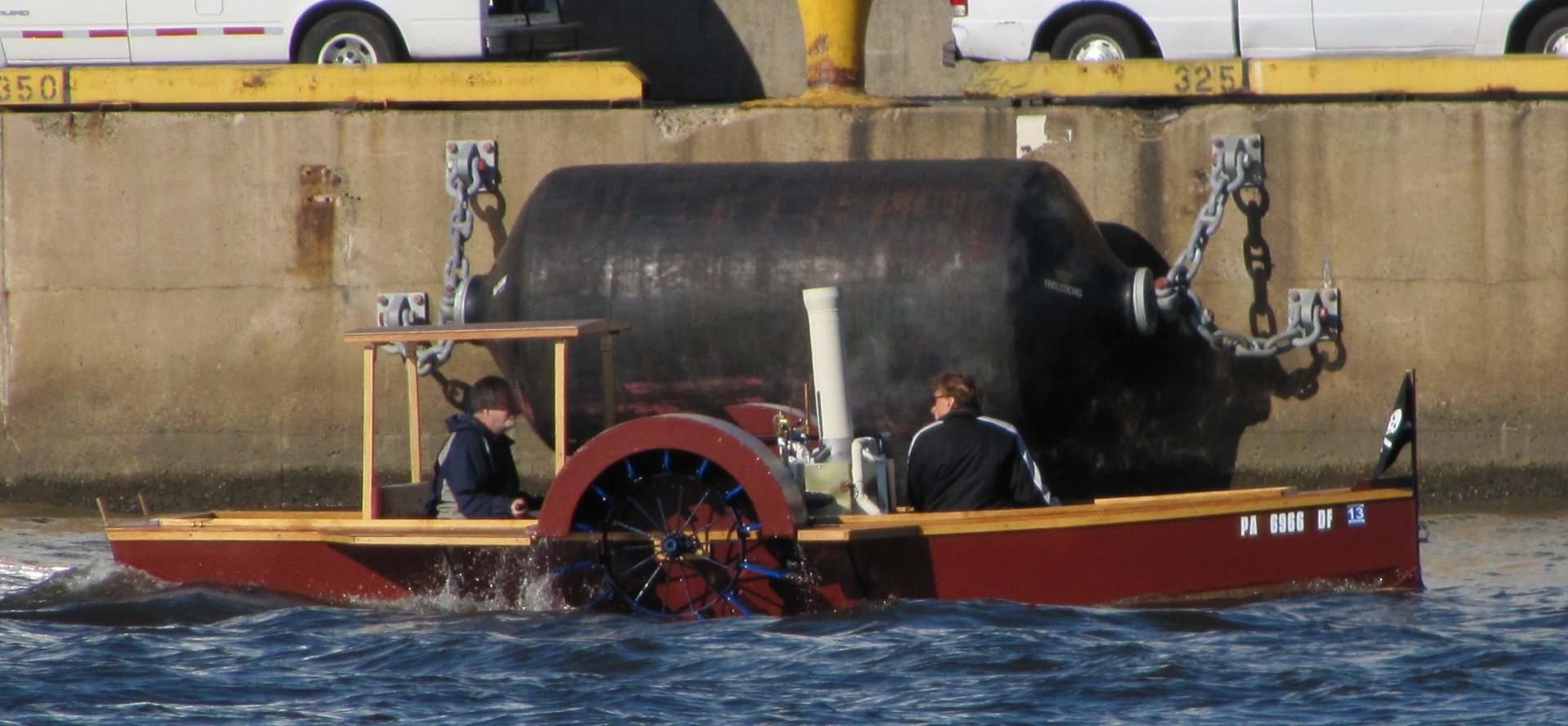

    what is that big black tank for at the dock? Pure water for a steam boat?
    or fuel?
    giant fender for ship?

  11. DCockey
    Joined: Oct 2009
    Posts: 5,308
    Location: Midcoast Maine
    DCockey Participant
    Looks like a ship size fender.

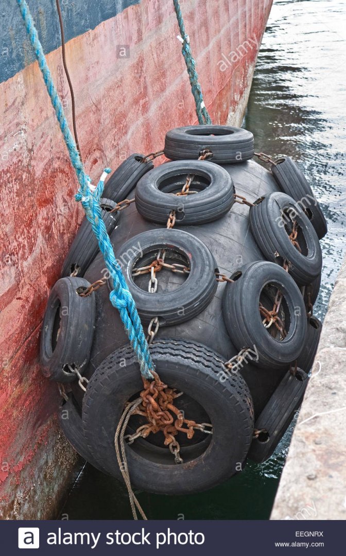

  12. rxcomposite
    Joined: Jan 2005
    Posts: 2,829
    Likes: 654, Points: 113, Legacy Rep: 1110
    Location: Philippines
    rxcomposite Senior Member
    Big ship fenders
