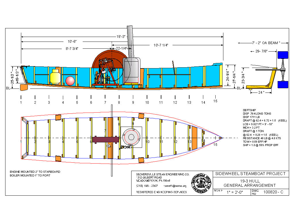

  13. fredrosse
    Joined: Jan 2005
    Posts: 393
    Likes: 55, Points: 38, Legacy Rep: 56
    Location: Philadelphia PA
    fredrosse USACE Steam
    I built my 20 foot sidewheel steamboat, a simple plywood hull similar to a typical "Sharpie" hull, with Raka Epoxy. The hull is covered with 10 oz fiberglass cloth, and I used 9 gallons of their epoxy to build the hull in 2010, and it is entirely satisfactory in my view. The Raka epoxy is 100% solids, a feature that should be specified for boat building I am told.
    bajansailor likes this.
