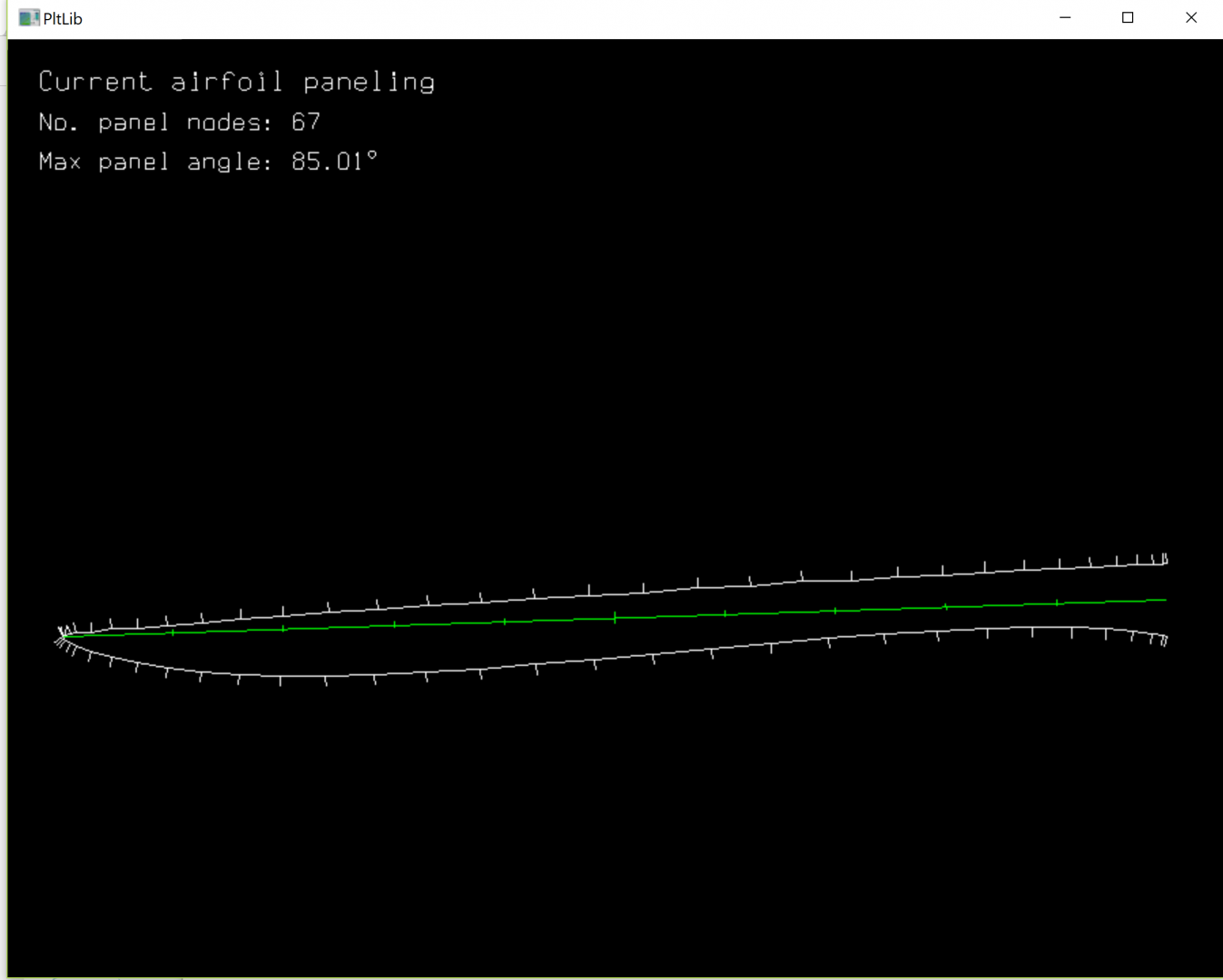

    Thank you i have just tired this and taken the tabs out and the foil produced is now this ? and has not produced the desired profile?
  8. tspeer
    Joined: Feb 2002
    Posts: 2,317
    tspeer Senior Member
    That shape is what your coordinates say it is. Here's a better set of coordinates.

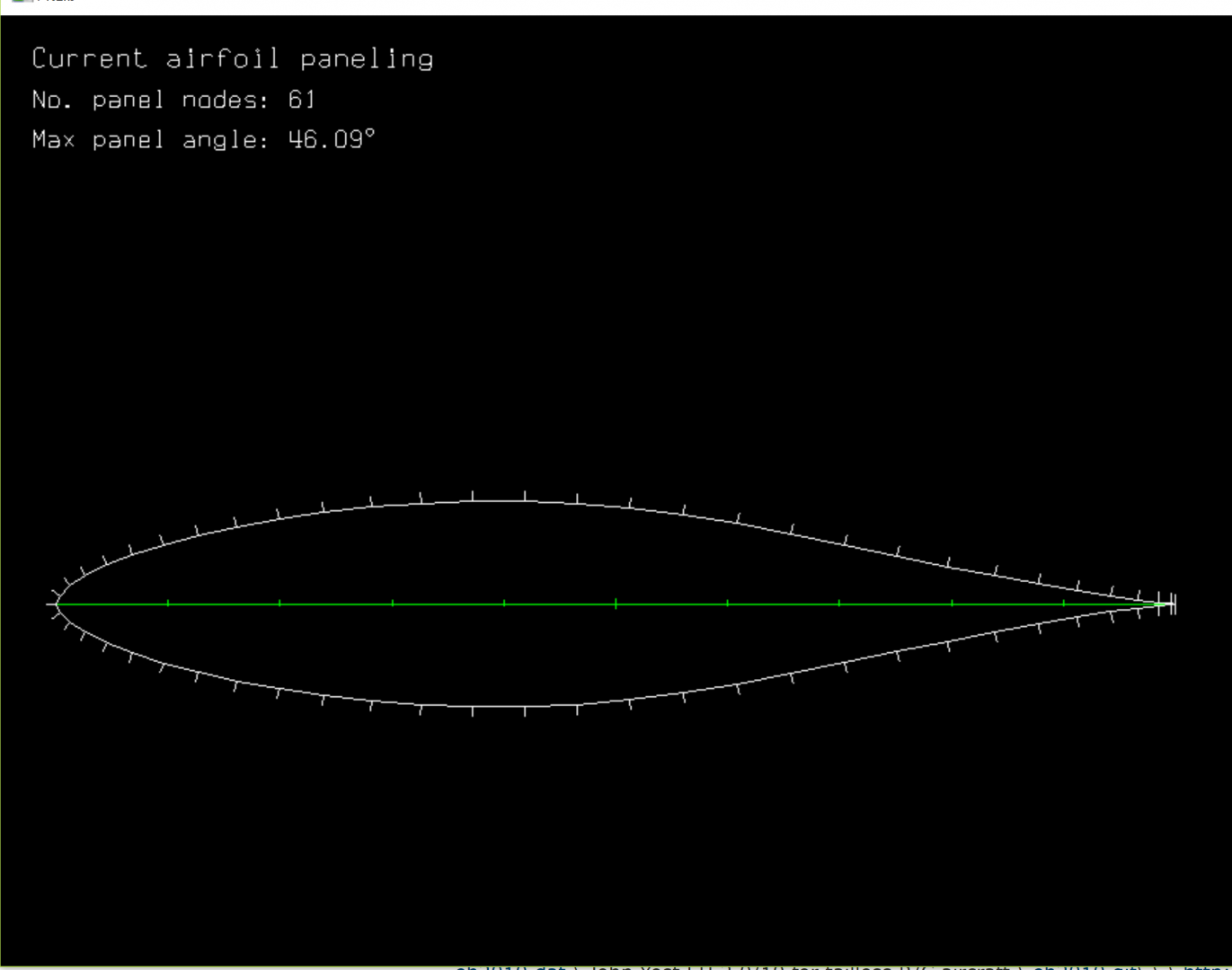

    Hi i managed to make a similar file too and both of them are now working thank you, im going to try and do the same for the other three profiles now, i need to then run the simulations and compare the Cl nd Cd to find out which profile i will be taking forward into the final 3D design in solidworks

    hi i have managed to make the e838 work now, thank you i will post the documents up incase anyone else would like to use them, i will now try and convert the others and run simulations, thanks, Ross

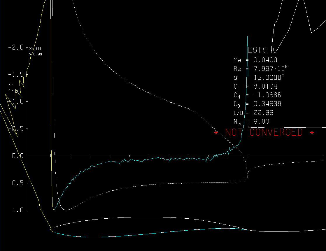

    whilst i have run the XFOIL simulations i have increased the iterations of the simulation to get rid of the NOT CONVERGING but this is still here do you know why this is ? many thanks, Ross

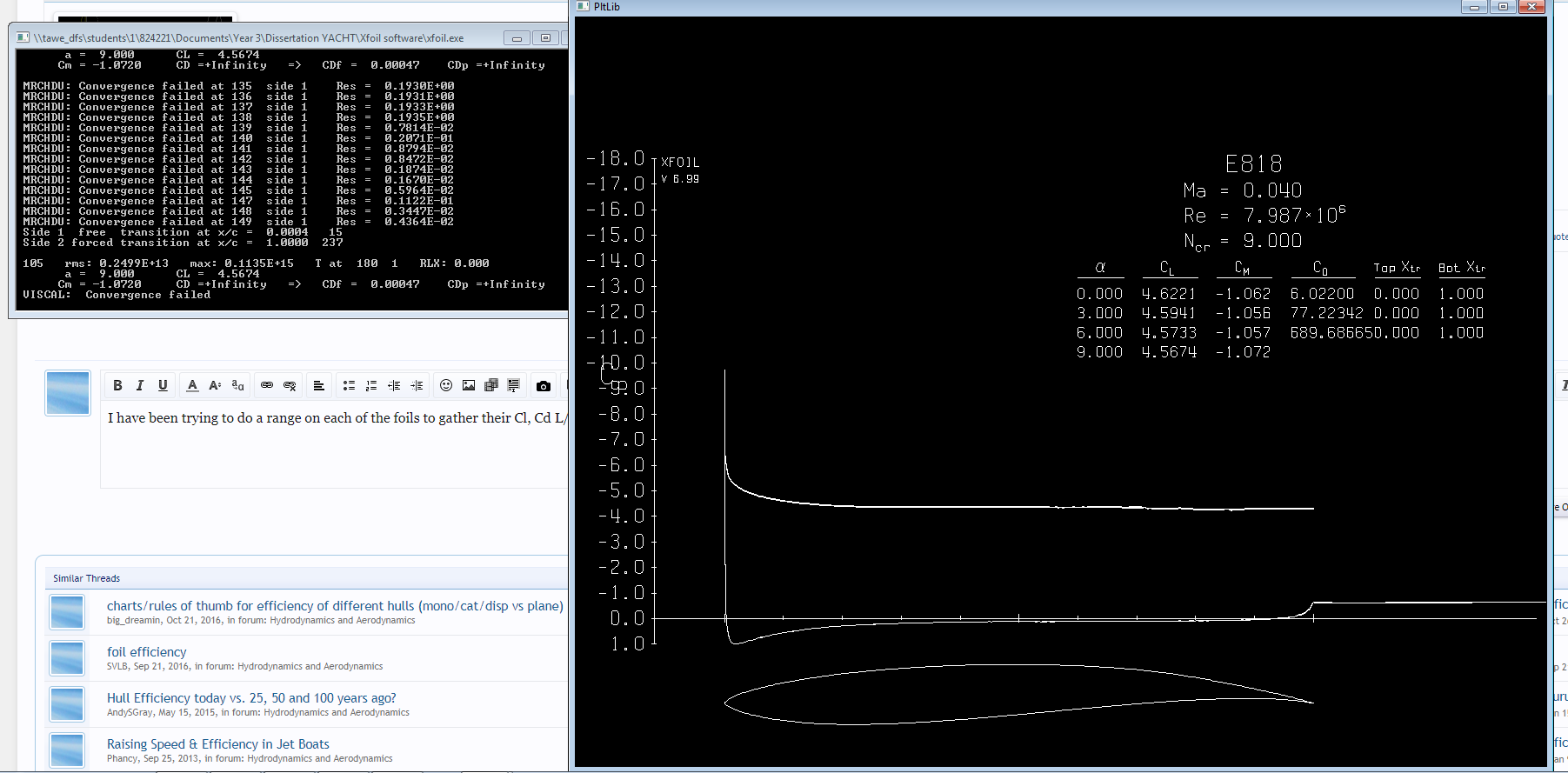

    I have been trying to do a range on each of the foils to gather their Cl, Cd L/D ratio but on each foil there are always converging errors, do you know why this is as this is really halting my design as i need to get blades 3D printed next week ? many thanks Ross
  14. Erwan
    Joined: Oct 2005
    Posts: 401
    Likes: 19, Points: 18, Legacy Rep: 97
    Location: France
    Erwan Senior Member
    You should try with alpha<6° instead of 15°
    Cl=8.0 seems a bit unrealistic
    I am not surprised it doesn t converge
