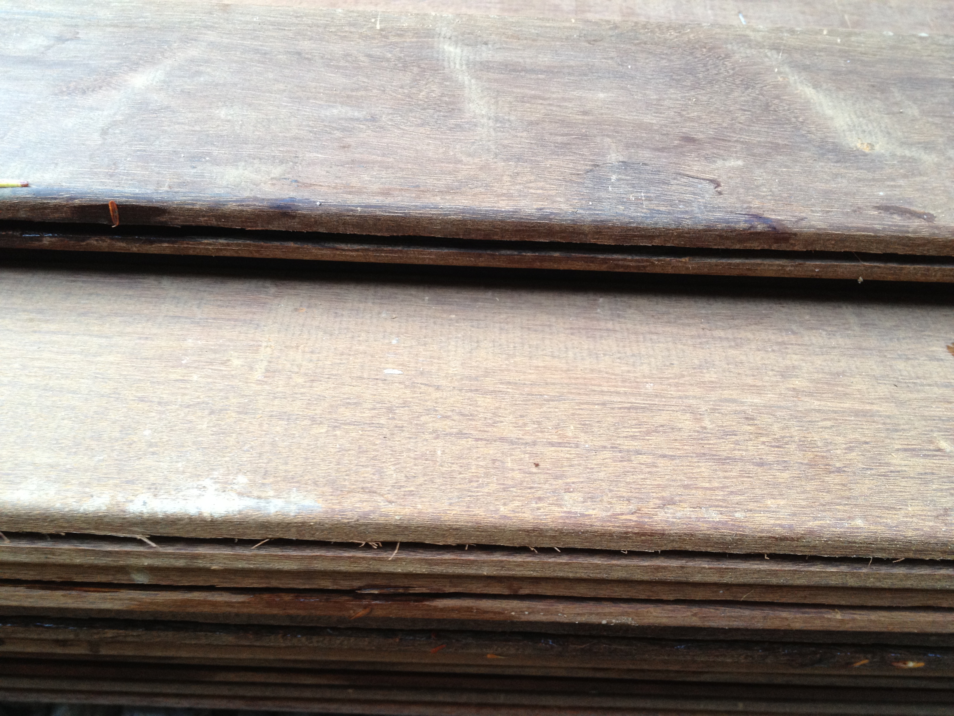

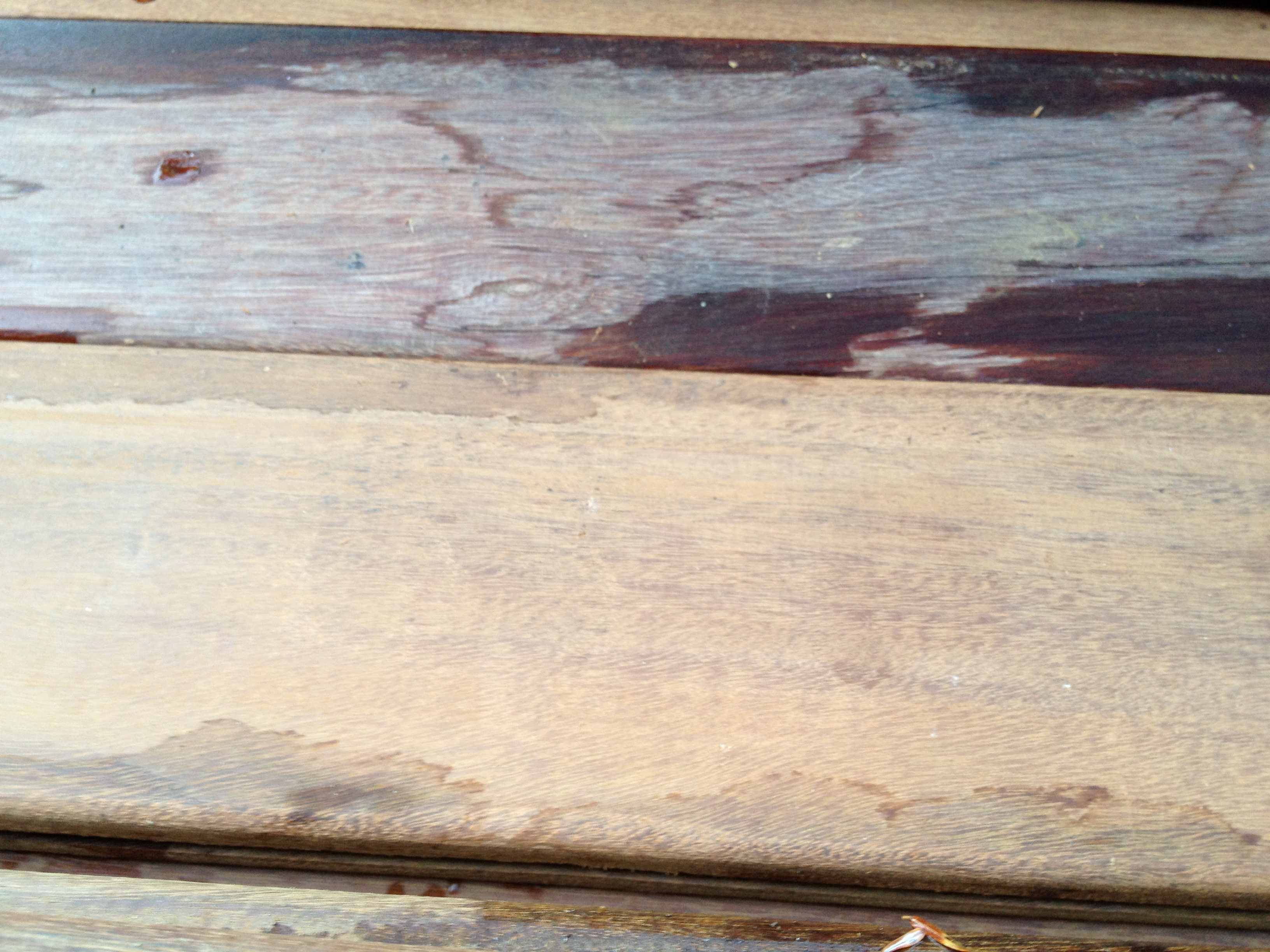

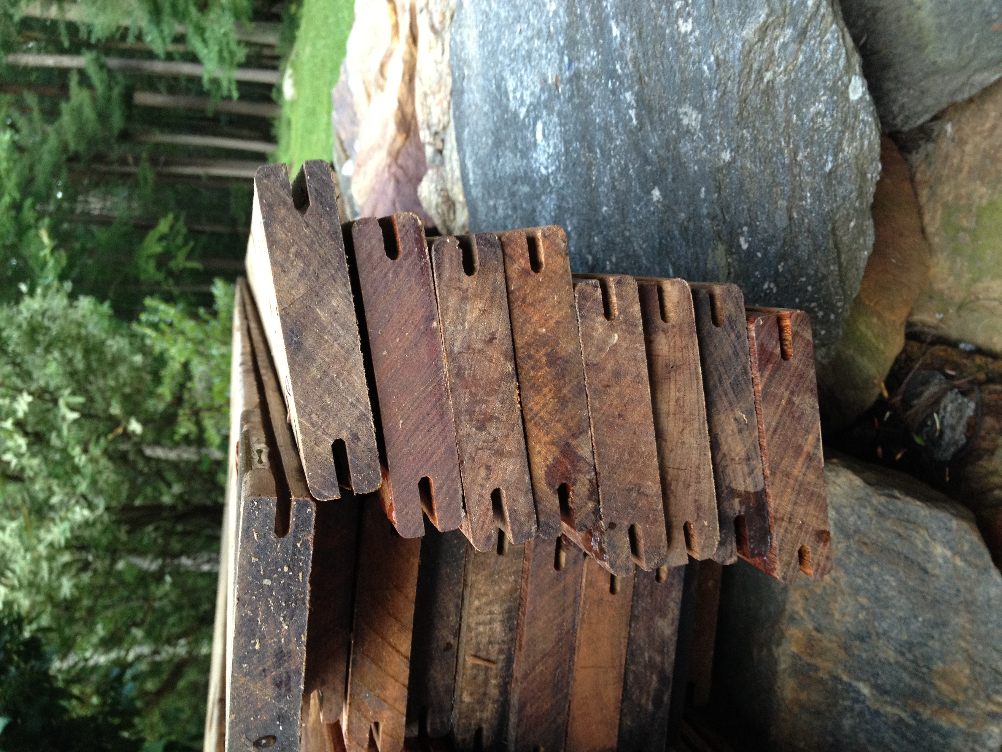

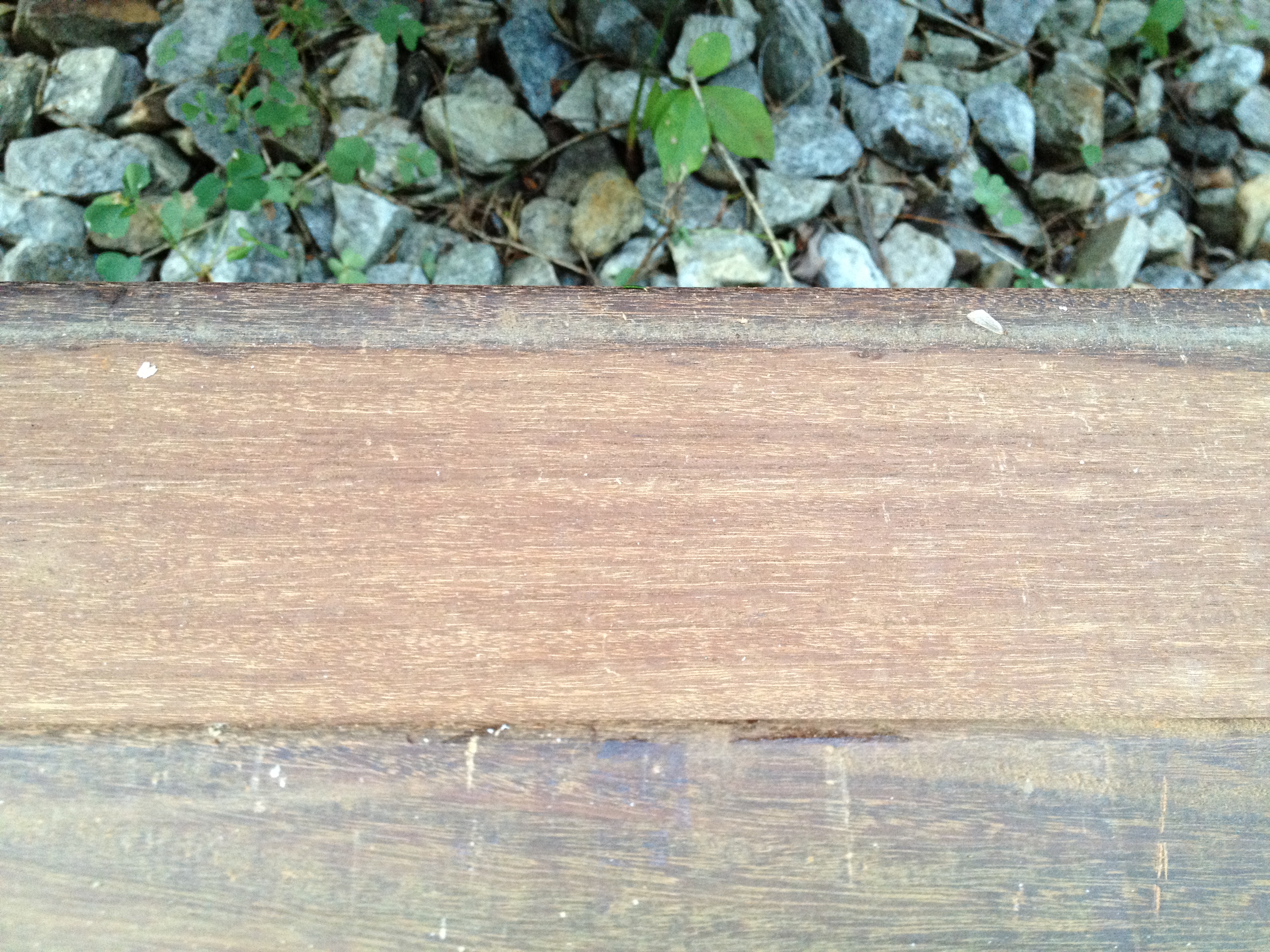

  9. nbehlman
    Joined: Aug 2011
    Posts: 63
    Likes: 3, Points: 8, Legacy Rep: 50
    Location: CT
    nbehlman Junior Member
  10. PAR
    Joined: Nov 2003
    Posts: 19,126
    Location: Eustis, FL
    PAR Yacht Designer/Builder
    That appears to be dark red shorea, commonly known as meranti, lauan and Philippine mahogany. It's not a real mahogany, but is quite durable and pretty when varnished up. It's an evergreen and very commonly found in many products, including plywood. It's not common to be found as solid stock in the USA generally, as native species dominate, but is available.

    Looks like Ipe (greenheart) to me...
    The planks are milled for the fastener-less decking clips.
    You will know when you go to pick up a board- Ipe is HEAVY.

    +1 for ipe...especially at that price. in my experience its easy to distinguish from mahogany just by pure density. ipe is wood that doesnt float. i once tossed a stick of it in the pool so my dog could cool off and she just gave me the stink-eye cause it went straight to the bottom. ive installed acres of the S4 edge-grooved ipe decking. its hands down the best wearing residential deck stock. beautiful, will not rot, nicely greys over time, stable and hard hard hard. eats up carbide tooling and flat-out destroys standard saw blades. ive been cautioned the dust and smoke are particularly toxic but have no specific info.
