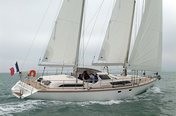

    The transom needs detailing for tender handling, swim ladder and boarding plank.
    Perhaps study the Jongert style. It is simply the best thought out stern detailing in the business.

    The transom like you show it is option for this boat

    20 meter motorsails , with all the "stuff" onboard , become short and fat. The transom extension makes the boat look longer and is very functional.

    Oh, and the BIG windward staysail is a nice detail. Keep the sheet leeds inboard. No reason why a cruiser cant sail to windward.
