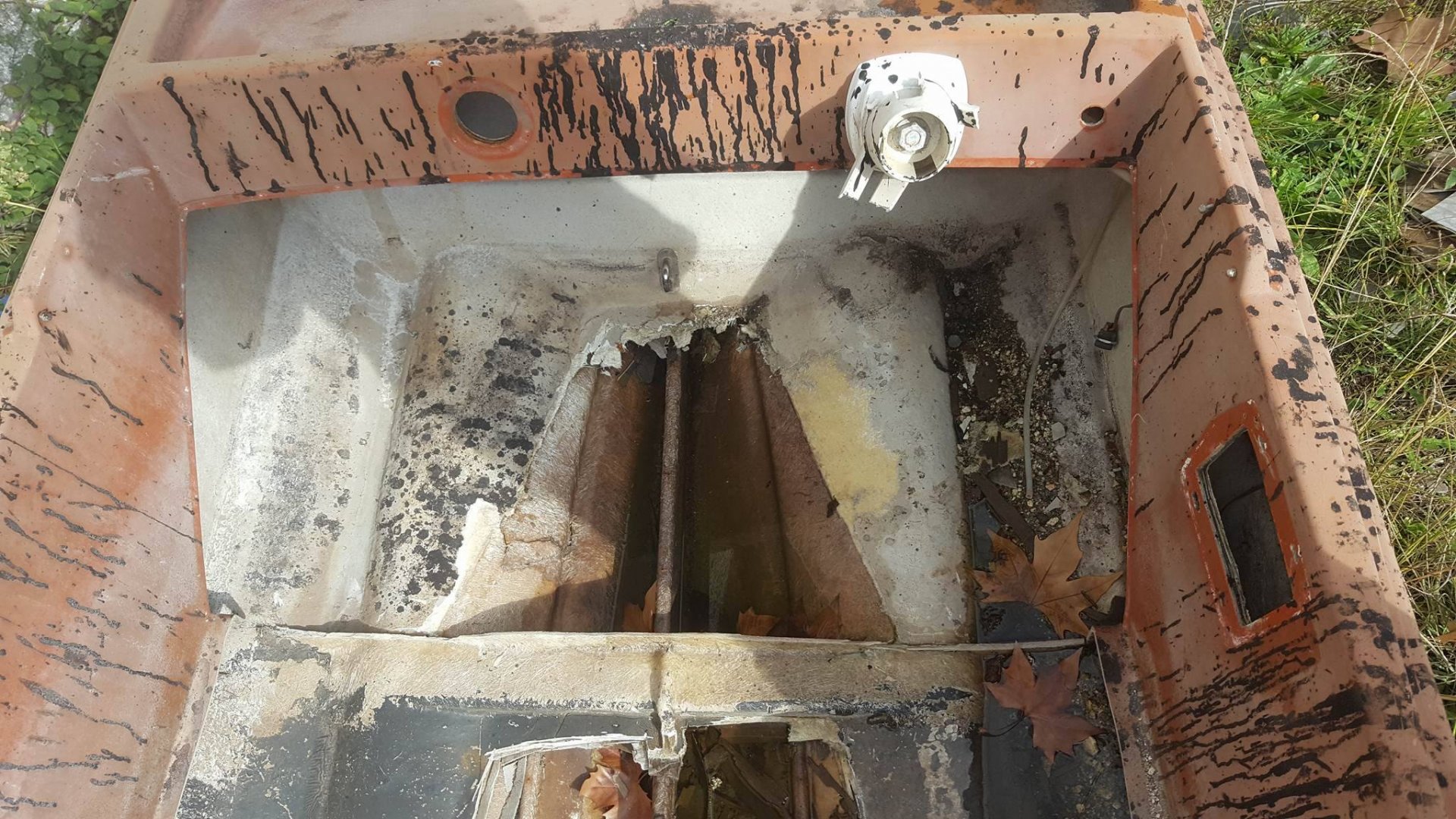

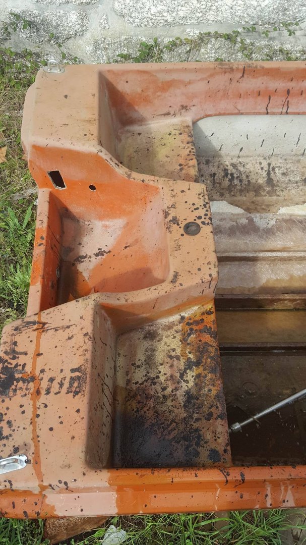

    First of all, hello to everyone, I'm new to this community as much as I'm new to boat building. So to make the story short:
    Me and a few friends got a boat, the unfortunately was beaten up pretty badly. It's ruined now and we'd like to work on it together to make a great boat out of it again(well, for the first time since it was never that great a boat before). We have the willpower but we lack the knowledge. But we're eager to learn and will do our best to explore and learn according to what you can advise us to do.
    We have already done a bit of work that was absolutely needed like removing the bottom floor which was broken and a sponge like material that wasn't looking too good either.
    Sponge material found in boat.
    We had to cut out the front seats in order to properly remove the floor bellow.
    24138902_1532615276773634_74199561_o.jpg 24139006_1532615796773582_2091446938_o.jpg
    We thought at first it'd be possible to split both sides(red and white) of the boat to ease the workflow but after removing a bit of the "fiber?" we concluded it was an impossible task.
    We need to fix the affected areas.
    We removed the old protection around the boat(don't know the name of that in english) and the boat's missing the windshield, which was some kind of plastic.
    Other than that we'd like to add a few more personal things, maybe a cover in order to make some shade, a few storage spaces, a place to put the battery for the electric motor it'll run on, maybe an extra battery to add speakers, phone chargers, w.e., with maybe a solar panel. You get the idea, nothing's pretty solid now, we are welcoming any ideas.
    We also have no experience working with fiberglass and we do not know the strengths of the resins used, neither do we know how to properly cure them. If it's important, daily temps range from 0ºC 18ºC around here. We'd like to keep the investment to a minimum, while making the best out of this boat.
    So, what should be our next step?
    I appreciate in advance your much valued assistance.

    The boat is not seaworthy.
    I would not spend 10 cents on it.
    However, flip it upside down and use a screwdriver and check every 50mm square of the bottom and see if you find weakspots. Mark all weak areas with a colored marker and take another picture.
    A better website for boat repairs exists. Pm me and I will redirect you.

    The boat appears to be structurally supported by the seats/sole that you cut away.
    First thing is to get it dried out. You can't work on it wet. And it'll need to be upright, so tent the boat all sides and maybe someone here will help you develop a structural plan with a new sole.
    Take a pic of the tenting and some closeups of the bottom you cut away.
    Personally, I would build a wooden cradle to support the bottom when getting repaired; avoiding the saw damaged area. The cradle would be strong enough to support you standing in the boat above the cradle without hull movement.

    When it is dry; start on a small area and repair the saw damage first. I can tell you what I'd do, but others might have a better plan. But fixing the saw damage would be where I would start after you have a repair plan.
    Also, with your closeups; take a closeup of the saw damage and measure the hull thickness there and report.
