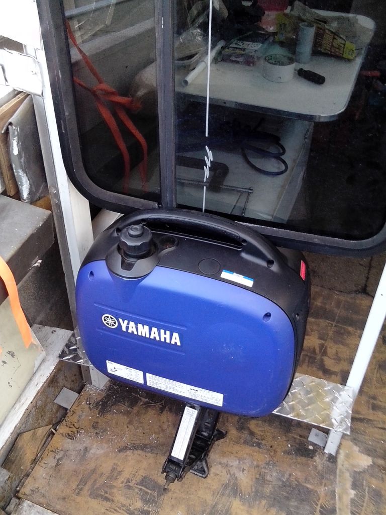

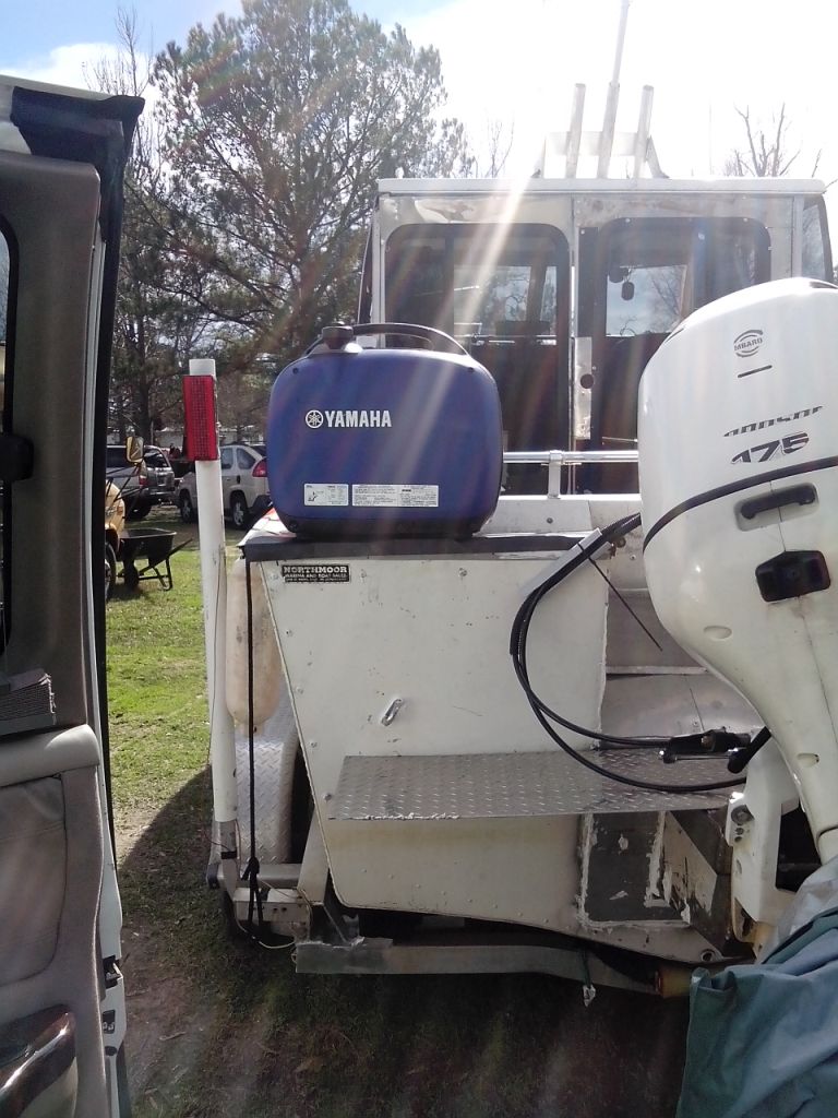

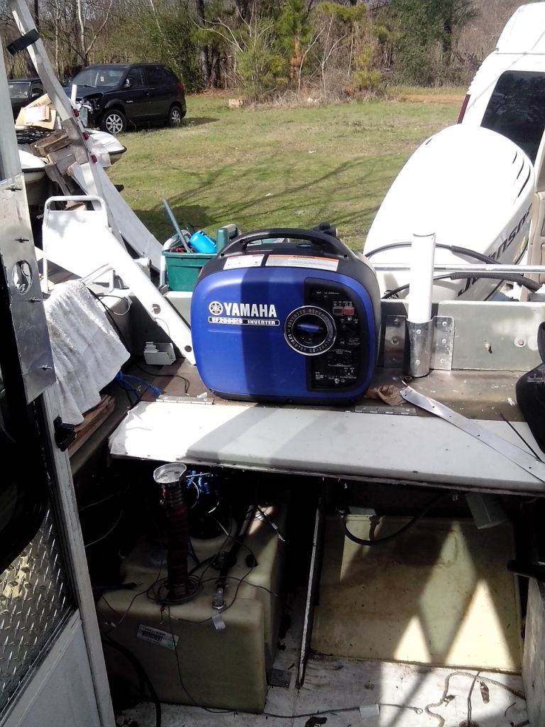

    images of planned generater install.
    probablley start using gen straped to rear deck

    Brain
    With the utmost seriousness, this is the absolute worst place with the exception of putting it in your cabin that you could place this gen set. The exhaust will probably kill you.
    The exhaust exists and the CO will fall into the bilge. Even the gases coming out and mixing in the air which you breath will can cause death.
    Even if you close the back door when you are using the gen, the backdraft will bring these gasses into your cabin area.,
    Its like playing Russian roulette by yourself

    yes you are correct the fumes are dangerous when I initially used it on the rear deck it stunkup the area quickly.
    I've already covered the opening under window. so Yamaha will run on dive deck or roof or on closed bow

    Bolt on a shelf on the exterior transom to the side of the motor and mount it there with straps.
    Take it into the boat when driving.
    Advantage, gen is out of the way, gen is exhausting outside of the boat. May even be quieter.
    Might even make a vinyl cover to protect from splashing when underway so you could leave it mounted outside of the boat.
    Disadvantage, rough water would get it wet.
    Slipmate with sailboat had a Honda gen like that and he would run it on the aft deck.
    I wonder if you could run yours on a forward deck, would the exhaust then be blocked from entering the cabin?

    I think the dive plateform is the safest place to run the generater
    can I get away w/ running a thick extension cord under gunwale into cabin?
