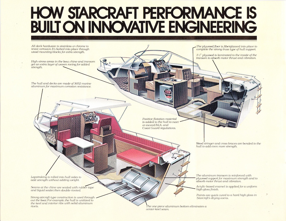

    I noticed a lot of rivets in the back of the boat. I assumed that this boat was a welded hull.
    The joint between the sides and the bottom, is this welded or riveted only?
    Many of the older aluminum boats were purely riveted. On the side to hull joint, they would overlap the two pieces of aluminum and put in a mastic tape , and rivet them together.
    The problem here is that if you run a bead of weld near the mastic, the mastic would "melt out-disappear" and create leaks.

  11. the brain
    Joined: Sep 2016
    Posts: 360
    Location: AL
    the brain Senior Member
    I'll check on the voltage output however I plan to keep both sys. indipendant of each other.
    attach image of the construction of my vessels exploded view.
    STB

    So in the lower rhs they make reference to the mastic tape.
    Do not weld close to this or any riveted joint.
