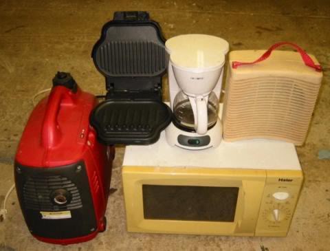

    I attach a image of some 120V AC devices this stuff was being powered w/ a Honda generater curious what the device in the upper right is maybe a space heater?

    what do you think about using gaoline as a cooking fuel like the coleman camp stove?
    what do you think the device in the upper right of the image I post maybe a space heater? what else could it be?

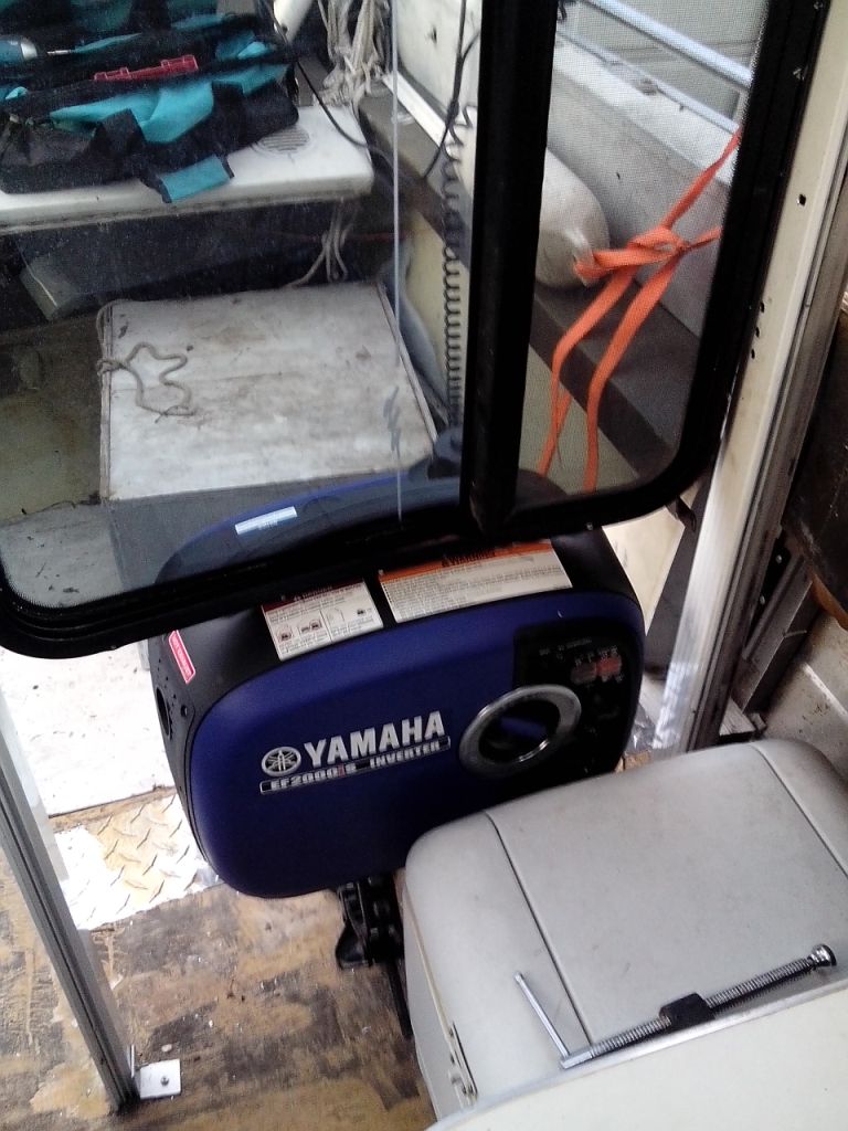

    I just pulled the trigger on a Yamaha 2.5 HP generater inverter type. 2K watts
    plan to fab into the rear wall on boat and fab into the rear door of tow vehical. so it will have dual uses.

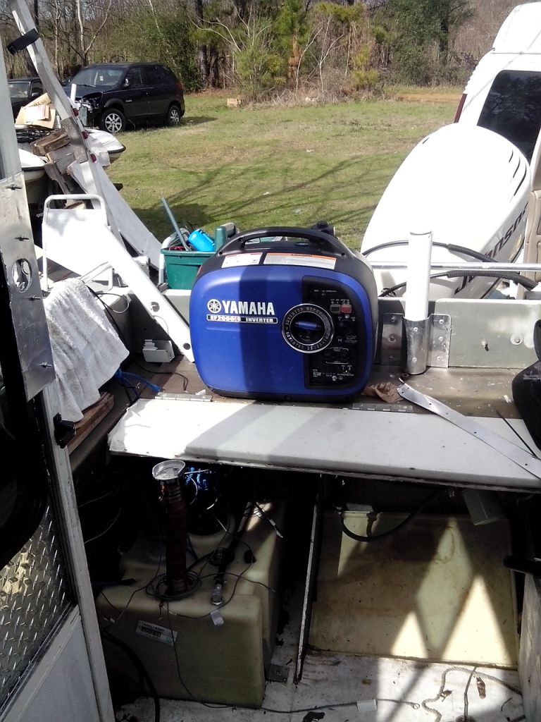

    fabbing generater into rear wall basicalley a box outside the cabin that the gen. slides down into there will be a hole in wall so I can acess the gens panel and start cord.
    OK what do you Guy's think of the generater being close to the unairtight door I made?
    I would like to have the gen. kindof stowed and usable when it's onboard meaning I would be fabbing a container where ever I decide to mount/use the gen.
    option
    roof mount
    rear swim deck
    rear transom cap
    rear inside bench seat/cover.
    this container will be a box w/ hinged lid side holes for exhaust/intake.
    roof mount would involve fabbing a weather proof box.
    either box will need a layer of insulataion to reduce the nosie output.
    easiest method of using gen onboard would be strapping it down to the rear bench seat or rear swim plateform, installing a premament power panel inside cabin at dinnete.
