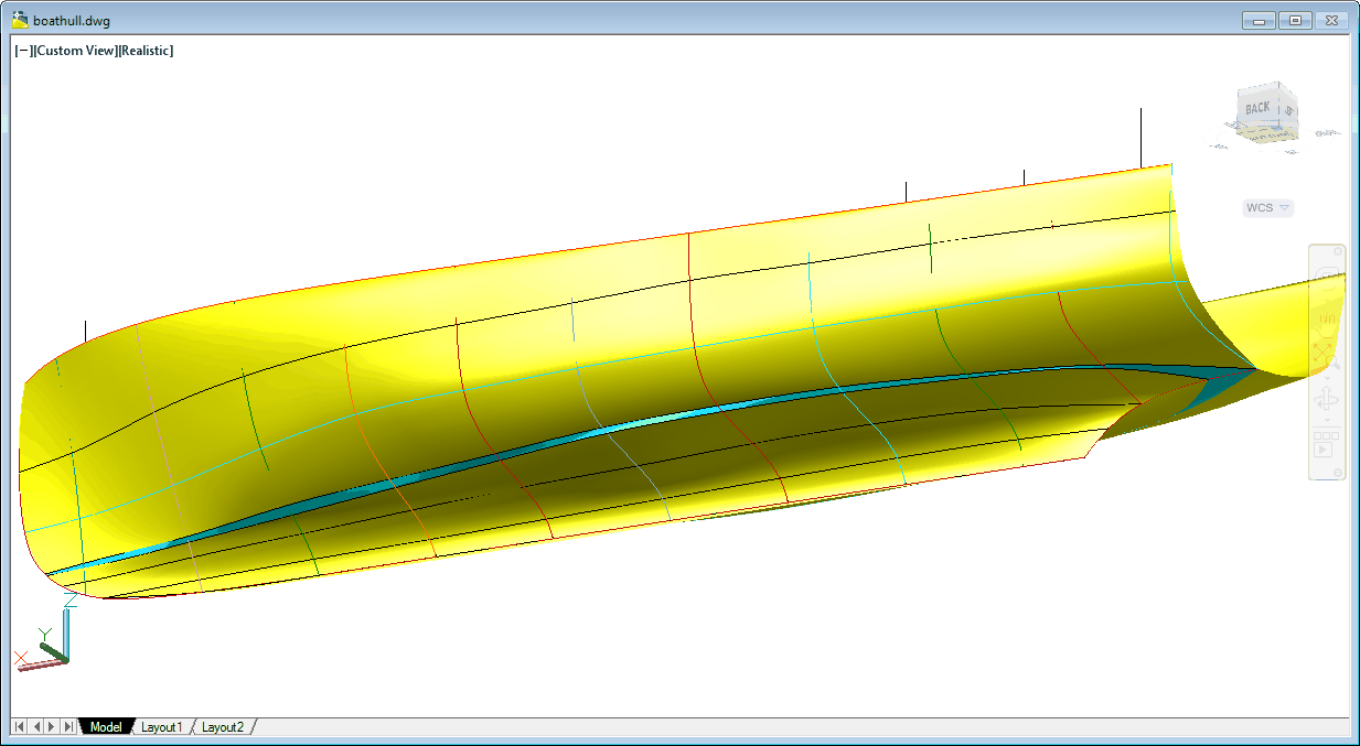

    How to create a fair hull surface for this boat. I created a surface using patch command but it is not usefull for engineering .

    I think you dont understand my problem. Thank you for answer but my problem is not that simple. if you look at attached image there is a sharp corner. And this corner causes discontinuity. My question is that how can ı deal with this problem . I need a single and fair hullsurface. Is there any way to do this ?

    From my point of view, trying to create a single surface is a serious mistake, it can make impossible to create a good model of the hull.
    In this type of hulls can be more convenient to create the surfaces by lofting water lines, instead of using the cross sections.

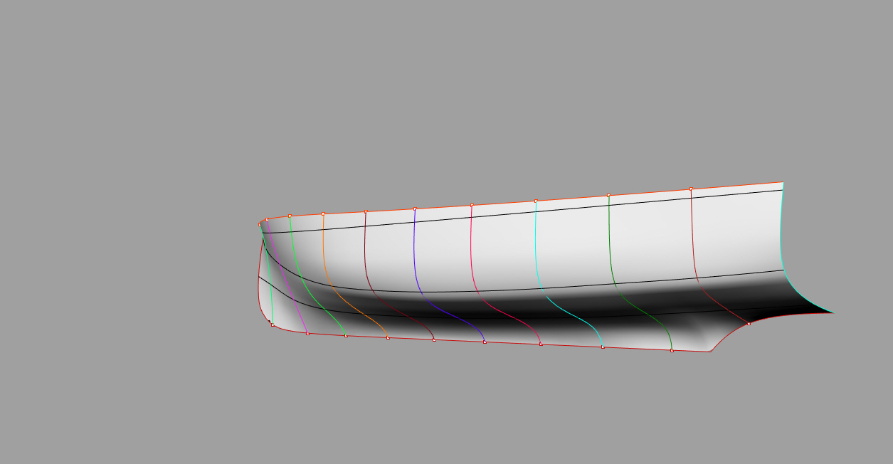

  9. TANSL
    Joined: Sep 2011
    Posts: 6,558
    Location: Spain
    TANSL Senior Member
    This is what you can get with what we have. It can be improved, no doubt but, have to start somewhere.

    As I said in post # 4, use water lines instead of cross sections. Trace water lines by splines, not polylines. The shapes of your boat, as you can see in the file of my previous post, are quite smoothed, they require some improvements, but that's normal. Perhaps it would be enough with some changes in the forward frame. For naval architecture calculations, it is more than enough what you have at the moment.

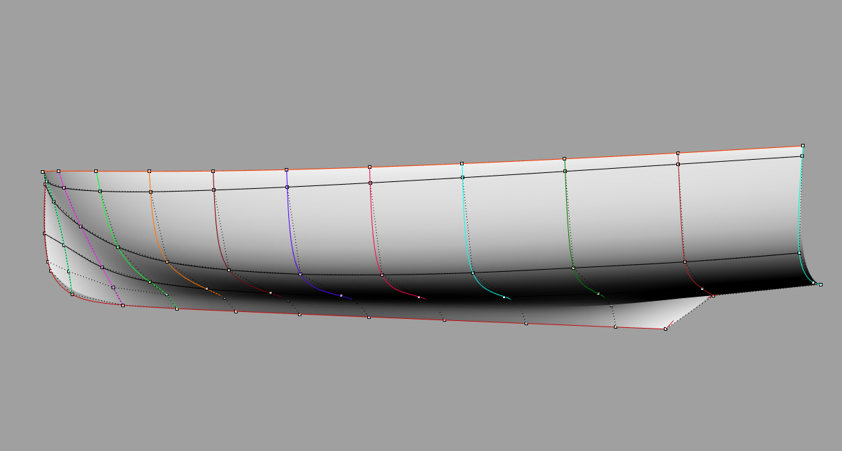

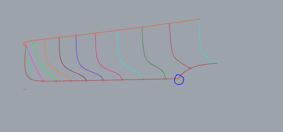

    Hey!
    I attach a file for you where I created two surfaces. The key thing to both methods below is to first run curves along the hull as close to perpendicular to the sections as possible. using waterlines and buttocks usually doesn't work well here. While method number two benefits in accuracy from having many diagonals, method number one usually gives best results using few.
    The first hull was created using the Surface from network of curves function in Rhino. It gives you a very accurate surface but it creates quite a lot of control points so it's difficult to point edit afterwards. This command has some limitations when it comes to deeper keels, say a full keel traditional sailboat as all the vertical and horizontal curves must intersect but two vertical or two horizontal curves must not. This surface took 4 minutes to create but it would benefit from some editing at the trailing edge of the keel.

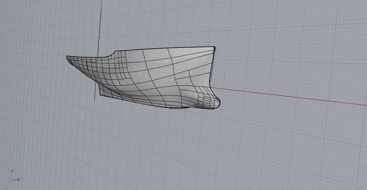

    The other surface is much less accurate but control points are few so point editing to perfection will be easy-ish. Surface number two was created using the t-splines plugin for Rhino. I simply appended faces in the areas between the curves.
    There is also a picture of a third hull. This one was created exactly in the same way as your number two hull, using t-splines. I wanted to add a bulb to a previously designed hull. The old hull was designed using just curves, no surfaces whatsoever. When I wanted to add the bulb so creating a surface from the curves and sculpt the bulb into a NACA 0025 foil shape using yet another set of curves as templates seemed the easiest way to fair the bulb into the hull. I spent maybe 4 hours point editing and refining it and it could use yet another hour.
