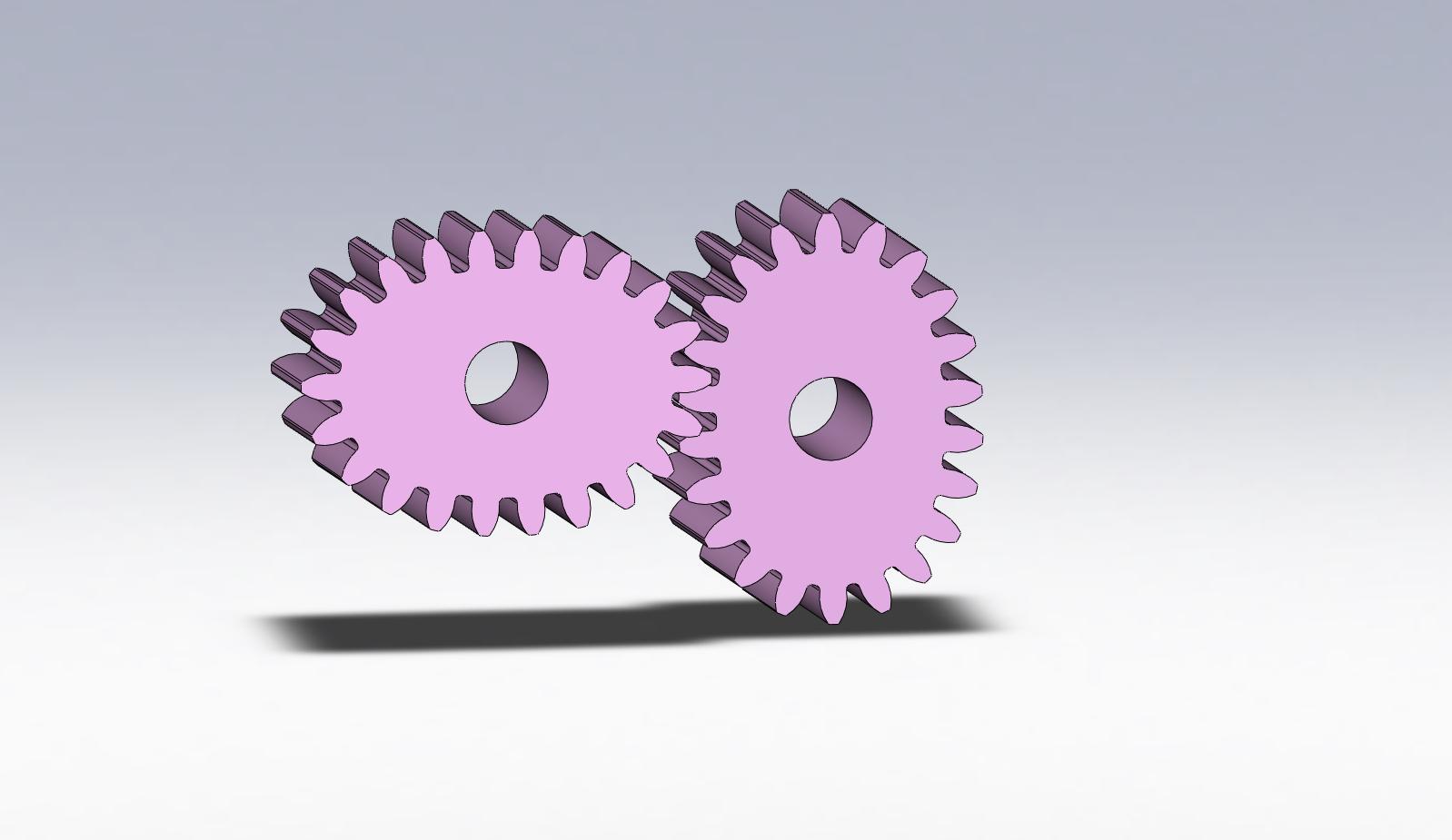

    But to the vibration or undulating output of crank force. Instead of a flywheel that really just softens the changes howabout a set of two oval gears that would spin a flywheel. This unevenly geared flywheel would accelerate at peak torque and slow down at the low force part of the cycle. All the while keeping the output shaft speed even.
    Probably not worth the complexity.

    I’ll get back on the oscillation solution. Will do a sketch.

    kerosene Senior Member
    Here pictured the moment when the muscles provide the peak torque to the crank. Elliptical gear accelerates the flywheel even if the crank (and power output) axle is rotating at steady rpm. This acceleration of the flywheel puts an additional resistance, lets call it negative torque to the crank.
    When the axles turn 90 degrees the force from pedals dips to it’s minimum. Yet the flywheel tries to maintain steady speed and provides positive, assistive, torque to the crank.
    Essentially you store peak torque and release it 90 degrees later.
    This should even out the bursts of force much better than a simple flywheel. And in case of pedal boat steady the prop rpm. Naturally the ratios would need be optimized.
    rxcomposite likes this.
