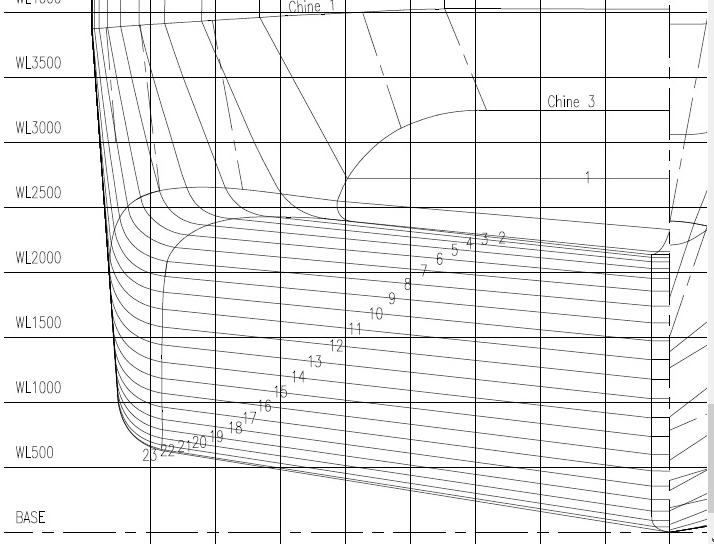

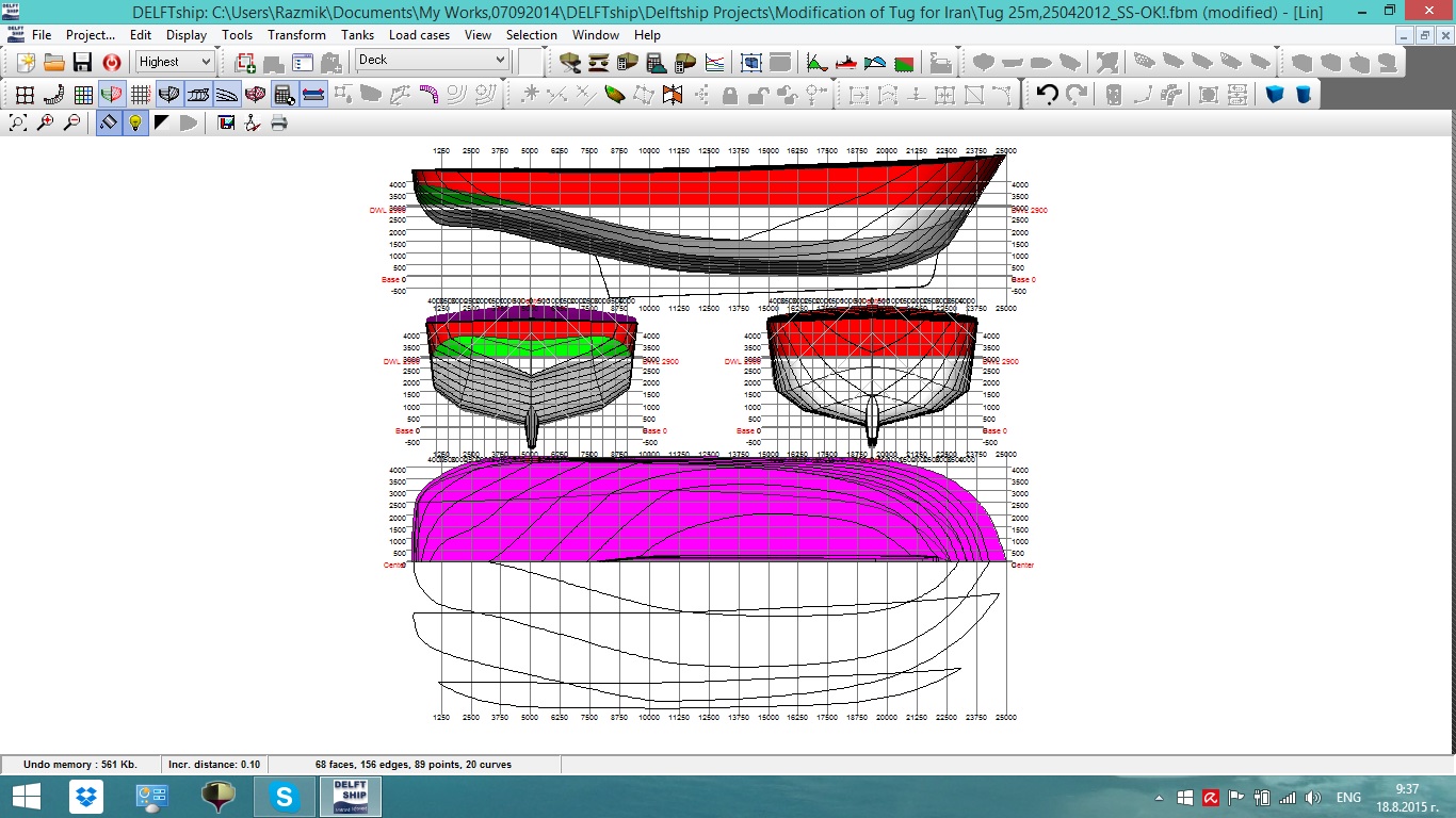

    I want to acquaint you about one updating a tug 25m.
    The original tug is in operation in one of ports of the Asian states.
    The version offered to your attention differs from the original bottom and sides. Out-to-outs of the tug are reserved, as well the deck line and the line of keel in CL.
    Original bilge it is carried out by radius of rounding-off. Updating offered me has two chines for a bilge part.
    This new version has major advantages - the hull to make from the technological point of view easier that is the production expense will be decrease.
    The model is created by me on program Delftship Professional. The hydrostatics are carried out on Orca3D, by means of export-import IGES file from Delftship Professional in Rhinoceros.
    The attached files illustrate the model and calculations on hydrostatics.

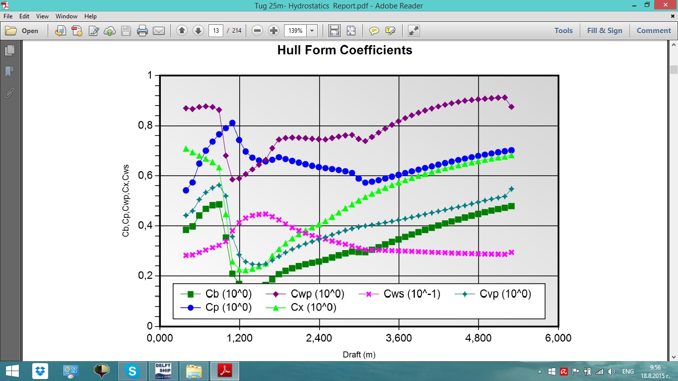

    The main sizes and characteristics of the tug:
    L=25m; B=8,9m; T=2,9m; D=284,8t; LCB=LCG=13,56m; VCG=2,8m
    Coefficients / by Delftship Professional/:
    Cb=0,486; Cp=0,638; Cwp=0,8407; Cx=0,7618

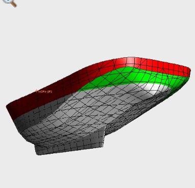

    Why is this design easier to build? Is the plating developable?

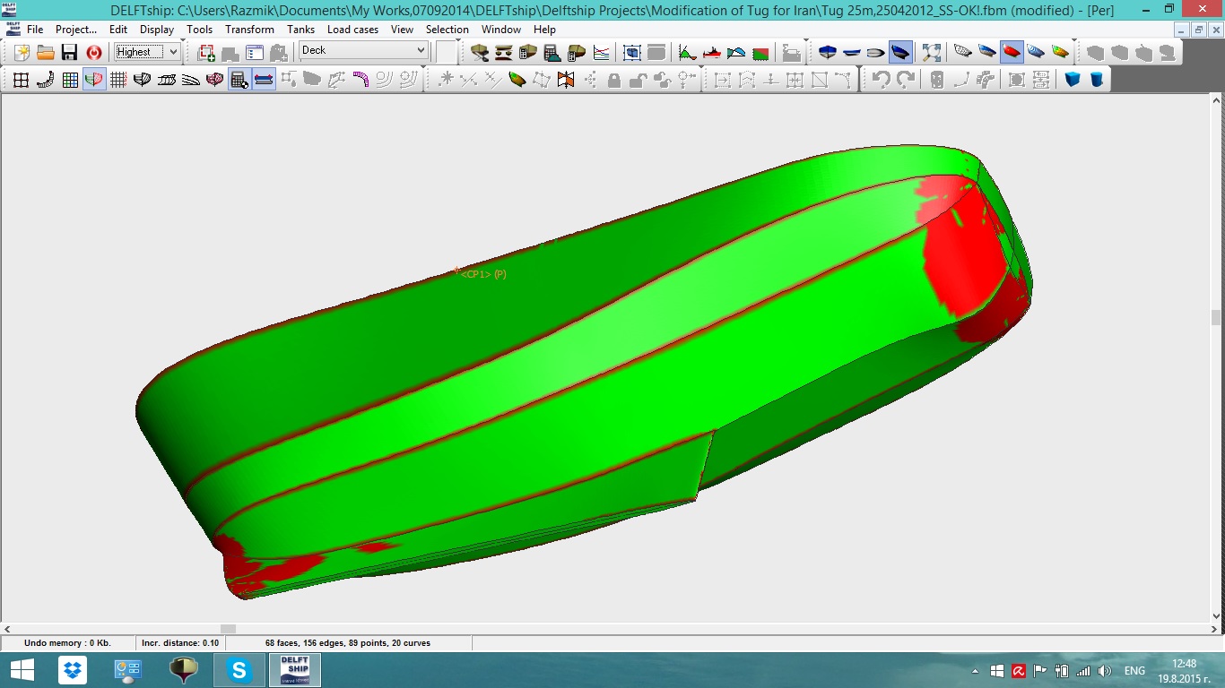

    Rabah Senior Member
    Hi David,
    From the enclosed file it is visible that only areas marked by red color do not satisfy the conditions for developability.

    Don't you think those areas could be fixed?
  5. DCockey
    Joined: Oct 2009
    Posts: 4,936
    Location: Midcoast Maine
    DCockey Senior Member
    What software and criteria did you use to determine developability?
    Several years ago I visited a designer and builder of tugs in the US. Their designs had straight frames and non-developable surfaces. It is easier from them to shape plating then to bend frames.

  8. Rabah
    Joined: Mar 2014
    Posts: 247
    Location: Bulgaria
    Rabah Senior Member
    Hi every one,
    I shall try to answer all arisen problems.
    1. Fixation of zones in red color has no important value in initial design stages. It is made later on the following stage in nesting documentations.
    2. The criterion for developability is only one - whether have the surface/or separately taken shell plate/ a bicurvature or not. The program itself determines it. Particularly for Delftship Pro it is a function calls „ developability shading mode”.
    3. Single or double chine of bilge it is usually applied at high-speed ships- gliders and ships with legs.
    For river displacement ships it is applied irrespective of the length- for example sectional structures for pushing.
    For displacement see going ships is applied usually for auxiliary fleets for example like this tug.
    4. If not we shall speak about double bilge chine in remaining as the stern and keel / buttock-line CL/ are precise copy from the original project of the tug, which now it is successfully maintained.

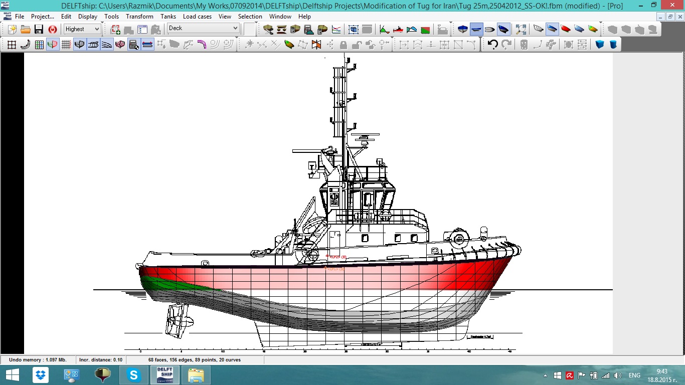

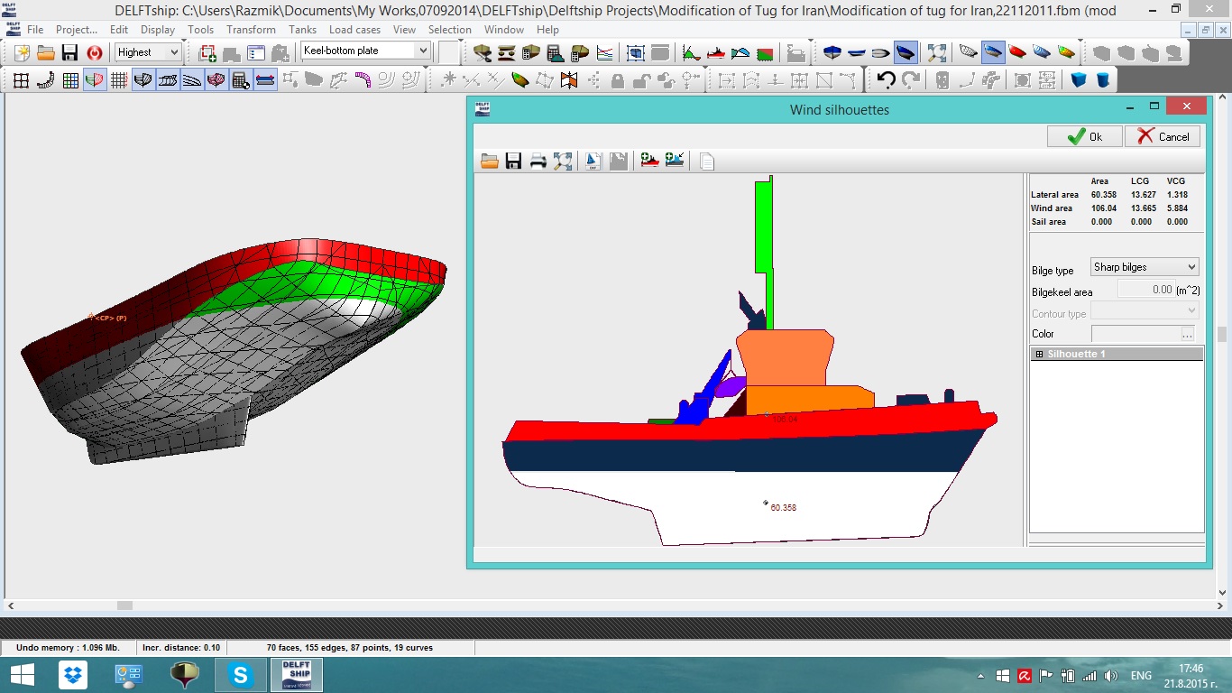

    Let's go on further with calculation of Intact Stability.
    From the attach files you can see the coordinate system and critical points:
    - Deck immersion points in middle CP1 (P/S)
    X, Y and Z =12.5m, + - 4.432m and 4.406m
    - Downflooding Points CP2 (P/S)
    X, Y and Z =12.65m, + - 2m and 5.2m
    In the Silhouette you can see the following data / by draft T=2.9m from BL/:
    Wind area Aw=106.04 m^2
    Zw=5.884m from BL
    Xw=13.665m from AP
    Lateral area 60.358 m^2
    Lateral center of effort:
    X=13.627m from AP
    Z=1.318m from BL
    For Full displacement we have:
    D=284.79t; LCG=LCB=13.561m from AP; TCG=0; VCG=2.8m from BL
    We calculate the Intact Stability with program Delftship Professional using criteria of International Code of Stability IMO A.749.
    You can see the outcomes in the Stability Diagram and Table to it.
    In the total have received:
    Ratio of Area A / Area B = 0.136
    Or coefficient of weather criterion Kw=Area B / Area A = 7.35> 1
    by Wind pressure 51.4 kg/m^2=504 Pa for operation in an unlimited navigation area.

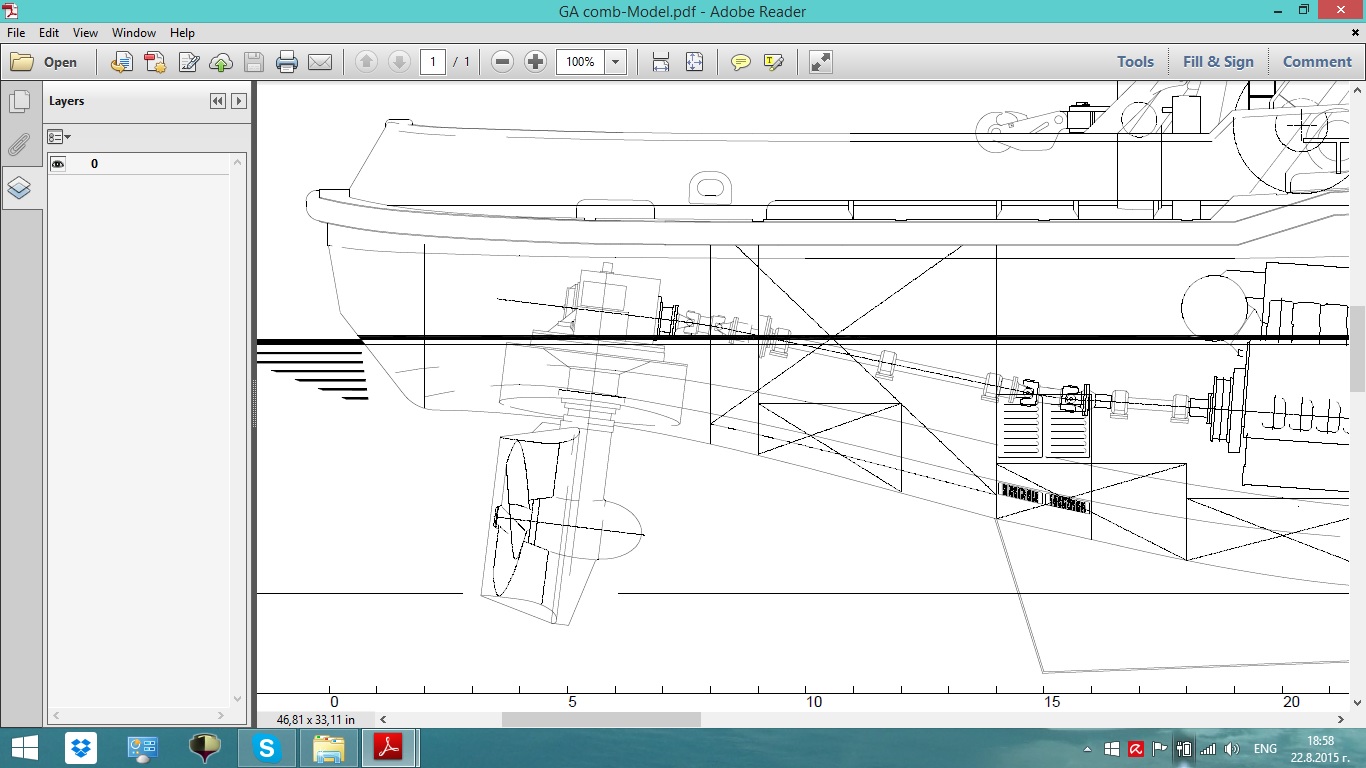

    Joined: Sep 2011
    Posts: 6,565
    Location: Spain
    TANSL Senior Member
    Dear Rabah, thanks for your patients words. Perhaps I am quarrelsome, I do not know, what I do know is that those are different sterns.
    The ship on which you have based has normal stern in such type of tugs. The model that you have done has a stern that is not correct for this type of tugs.
    And the keel that you've invented is "curious", useful ?, I don't think so.
  15. Rabah
    Joined: Mar 2014
    Posts: 247
    Location: Bulgaria
    Rabah Senior Member
    Hi Tansl,
    Why do you misrepresent the things?
    I do not say that I want full identity of the stern. I have made only identity of the contour of CL on whole perimeter.
    The stern is very good even perfect!
    Concerning the keel - really the aft edge is sharper. But it can be corrected on the following stage if it is necessary. But now there is no sense.
    Thanks for the comment, but all the same it is only your personal opinion. Only words unstiffened by arguments.
    _________________________
