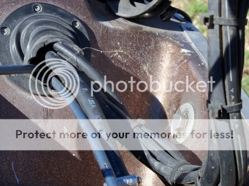

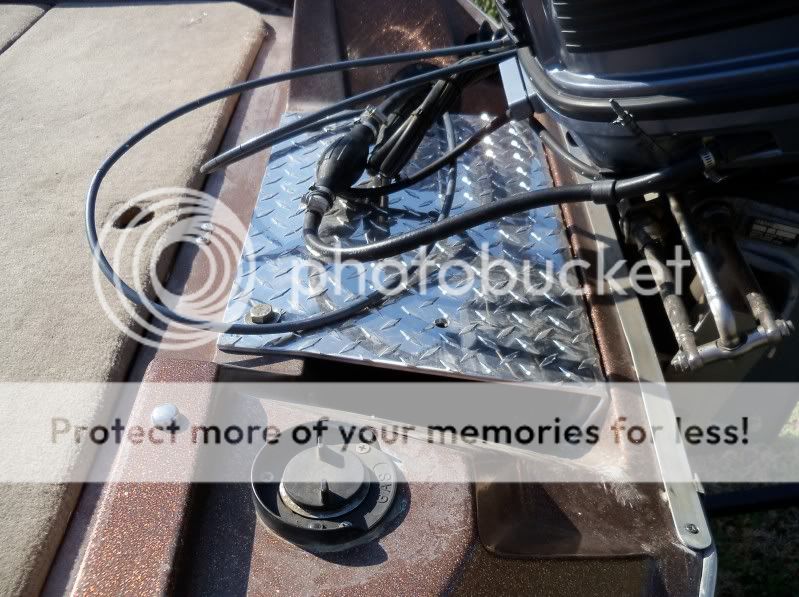

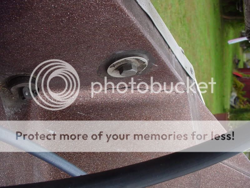

    I could show you several pics with cracks near transom in splashwell,others said couldnt be repaired,so prior to trashing tried my hands with fiberglass not internal external,one coat disappeared so put two on the worst side,discovered it isnt hard to do,and one should wipe away from mat never coming back as you build a ridge up.Wanted to see if it would hold so didnt even sand it down,then had a 1/4 diamond plate made bolted thus it wont ever seperate.Hydrosport made some of the first kevlar boats didnt put near enough support towards that transom,most have craze cracks.Now im wishing had sanded it down a year later,ky lake is a rough on boats.Normal one runs 20 ft here or more this is 17 1/2.

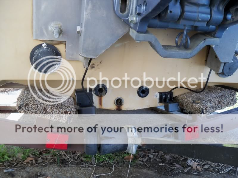

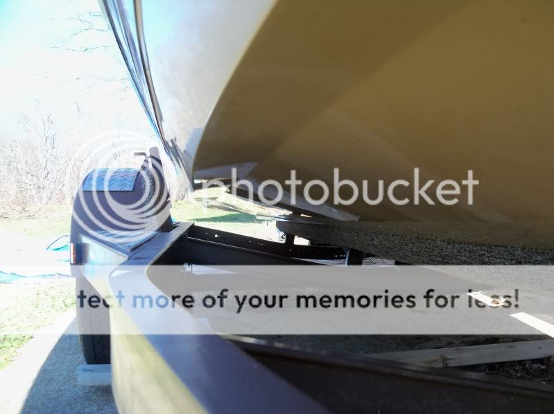

    Heres the back end
    http://i414.photobucket.com/albums/pp228/lilmule12002/pad001.jpg
    Then a shot from front to back those short tunnels exist back only look close the strake is next to the trailer bunk and bunk takes up the room in the tunnel ,kinda small.
    http://i414.photobucket.com/albums/pp228/lilmule12002/pad002.jpg
    Right side crack
    http://i414.photobucket.com/albums/pp228/lilmule12002/DSC00460.jpg
    Right side side repair
    http://i414.photobucket.com/albums/pp228/lilmule12002/Picture007-9.jpg
    Left side repair
    http://i414.photobucket.com/albums/pp228/lilmule12002/Picture005-16.jpg
    Plate
    http://i414.photobucket.com/albums/pp228/lilmule12002/Picture001-18.jpg
    Not going anywhere,hydrosport made some of the first kevlar boats thought was indestructible didnt put enough support in near transom,almost all have cracks there in splashwell
    Been 14 months since repair holding fine,ky lake norm is 2 1/2 -3 fters 8 months a year,even though not sanded sort of out of sight.

    I don't know about these small tunnels or how they work. I'm not sure if they're tunnels or steps. I've never had a boat with them. How many inches or feet forward do they go?

    Center what looks like a pad starts at front very thin much smaller like a hanbys gets wider and deeper as it comes back ending in what appears almost to be a pad.
    Each small tunnel only exists about last three ft of boat.
    If they existed all the way thru would look like a gull wing then.
    Front is like a deep v bottom,rear is a three point cat.
