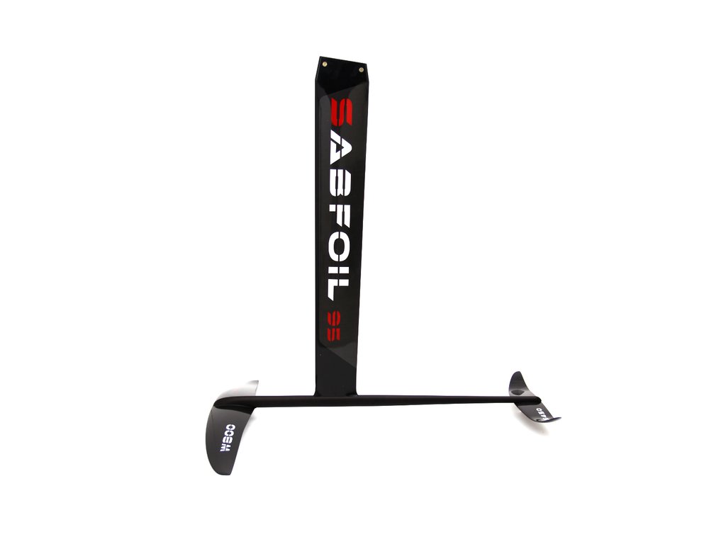

  7. FoilAddict
    Joined: Mar 2021
    Posts: 6
    Likes: 0, Points: 1
    Location: Maui, Hawaii
    FoilAddict Junior Member
    No we don’t, here is an example of a fast downwind foil, since the vertical strut is so far back it’s hard to run an active control system without significantly increasing the fuselage diameter
  8. tspeer
    Joined: Feb 2002
    Posts: 2,319
    Likes: 305, Points: 83, Legacy Rep: 1673
    tspeer Senior Member
    A flexible trailing edge, or flap mounted with a flexure, can act passively to transition smoothly and automatically between high and low speed positions without any control system. There are basically two design points to consider. The first is the high speed shape you want to have. The second is the flap deflection at takeoff.
    Start with the high speed shape and calculate the hinge moments. The moments will be mainly a function of speed and only secondarily a function of angle of attack. From the high speed hinge moments, calculate the deflection that resulted to get you to the high speed position. Subtract the deflection from the high speed shape to get the zero speed jig shape. Adjust the stiffness of the flexure to get the desired deflection at the takeoff speed.
    I like to additionally calculate the point load on the trailing edge that will result in the same deflection as the high-speed distributed load. This load can applied to the foil in a jig to tune the stiffness of the as-built flexure to get the right deflection.
