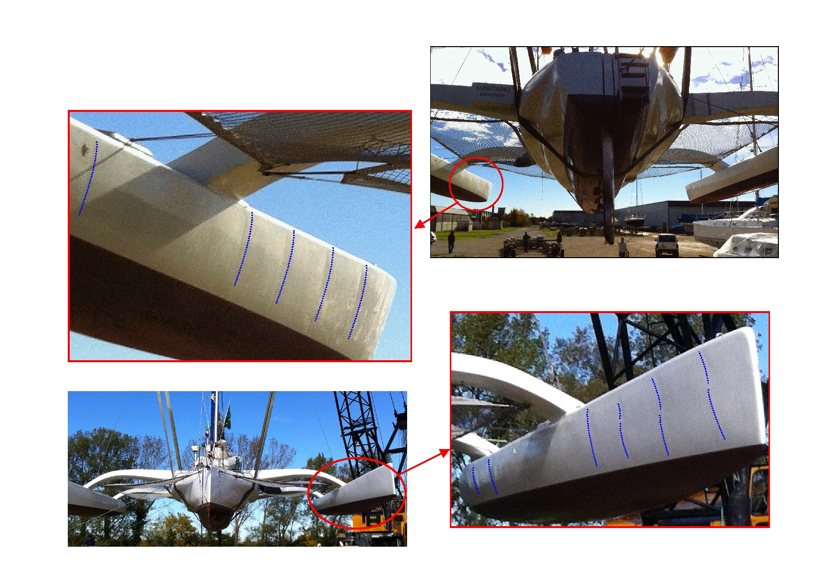

    okeys... we have looked at the starboard ama with humidity from outside and inside. Now comes part 2: the portside ama.
    With some photos I received of the trimaran I have noticed something. Over last months I have looked hundreds of photos documenting different trimarans. But never I found it on any Trimaran.
    Maybe its the special light during the photos had been made. So lets take a look at. As I am not a boat builder, pls give feedback what you see.
    (Rec.: I have marked it with "blue doted lines". Pls click on the attached image or PDF so you get it in "high reslolution".)
    Regularly every hull of a sportive yacht should have a very plane surface.
    in wooden boat building, it is a method called "fairing" which means: all little nuances of uneveness, wrinkles and bumpyness are being corrected during the planking (e.g. by slicing) to get a plane surface as the boat material itself (wood) has a natural shrinking process by drying.
    In the photos we see the "frames" shining through the painting. This isnt "normal". Not on a Trimaran. - The ama port side from bow to stern has a "wave structure" horizontally and vertically.
    So I ask myself: why isnt the surface plane ? - Was it already a mistake by the boat builder (16 years ago) ? - Which then even might be the reasons for the humidity and water inside the starboard ama, too.
    I only know this battered surface from steel ships being produced by welding of metal plates because the high temperature evokes such "waves".
    A fast cruising-racing trimaran should have plane surfaces ! Did the boat builder make the mistake to use "not completly dried" planks ?
    Tks in advance giving feedback !

    The images shows "oil canning" and likely because the bulkheads and internal furniture wasn't bonded to the hull over foam spacers, before the tabbing went down.

    Tks Par ! I first had to learn what the "oil can effect" means. :) I got it. Remembers me "sub marines" diving too deeply. - And yes, its very logically... simple "mechanics".
    Some interesting input I found here too for understanding the "foam spacer" thing... http://www.yachtsurvey.com/HullFailP2.htm
    About this picture:
    [​IMG][​IMG]
    So then I would say the port side ama (and probably same the starboard ama + main hull) have been produced all in "bad quality" and the whole boat has a bigger structural problem.
    Very, very pitty.... for this beauty. I dont like to say it, but it more now looks like a "wreck" with a total damage. Right ?

    These things can be fixed, but it's a commitment. Tabbing isn't more flexible, so much as it makes a gradual transition from one plane to the other, so point loading and stress risers are eased considerably. The best way to think of this is "density change". The density of the hull shell is consistent, but the abutting structures, dramatically increase this density locally, which creates a hard point where stress concentrates. If the bulkhead or furniture has tapered tabbing, up to and proceeding away from hard points along this panel, the density change is gradual, so less impactful on the hull shell's ability to transmit loading strains.
    I'ts likely the bulkheads/furniture didn't fit the hull shell very well or were not placed very well, maybe slid off to one side more than it should have been, before the tabbing was placed. Foam (and other) spacers help eliminate these issues, before the tabbing is applied. I've used tile floor spacers previously for this reason.
    The solution is to cut the tabbing off one side of each offending piece, back cut under these offending boat bits, foam if desired (not not entirely necessary), then re-tab the side that was cut. Yeah, a bitchy thing to consider, though a huge bargaining chip with the owner once pointed out, possibly enough to make repairs worth it.

    Is it my eyes, or are the 'hard spots" indented ? This would mean that the bonding on the frames is holding on to expanded plywood sides.

    The floats look like cylinder molded rather than tortured ply. If they are suspect I'd look to make new ones rather than restore. If you were looking for a professional quote you could contact Thain boatworks they have built some big CM hulls of recent times and their staff are familiar with the technique.
