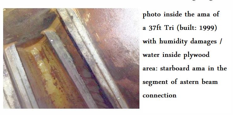

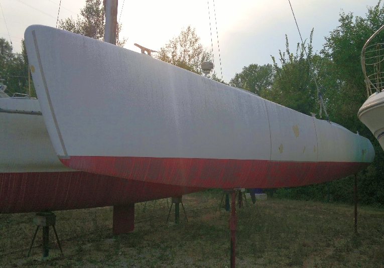

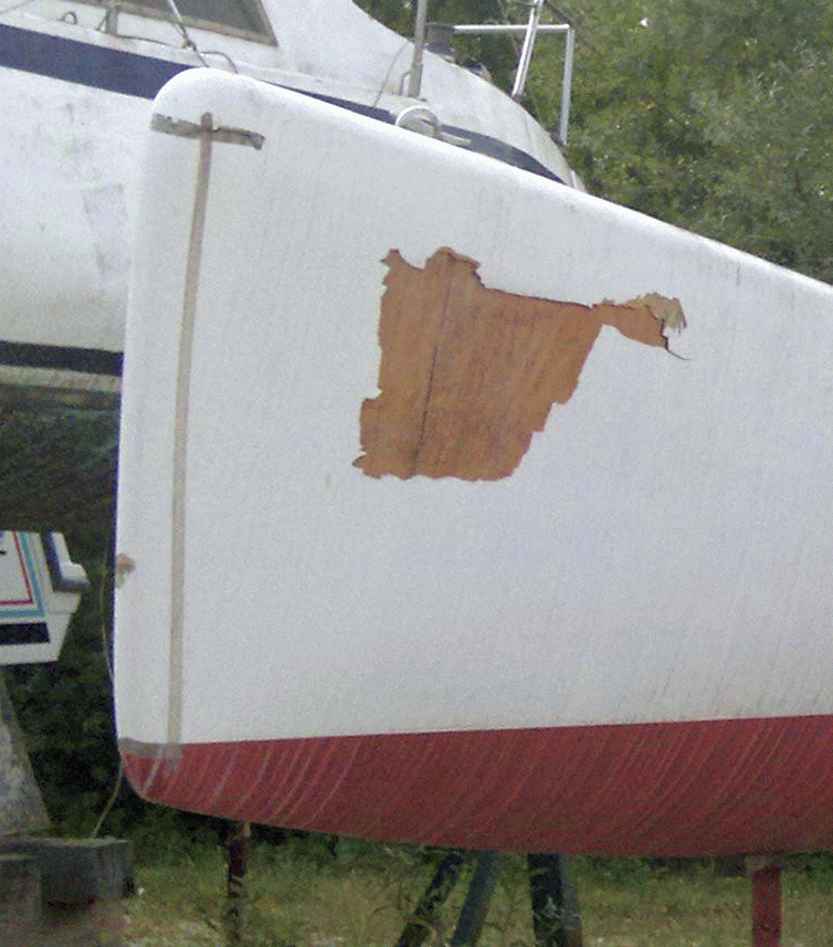

    Hi, folks ! - I hope to post in the right segment. :) as the 3-hull boat I have some questions was built with different materials:
    1. mainhull: airex sandwich with uni directional (U.D.) glass type "E" epoxy carbon reinforced
    2. beams: red cedar strip planked with U.D. carbon and U.D. Glass type "E" epoxy
    3. Amas: compressed shape in plywood marine, for deck was used sandwich airex with reinforced "E" glass epoxy
    I have some very basic questions about this racing-cruising trimaran which was built 16 years ago by a small boat warft in South Europe. The boat is for sales now... and is deposited on land since end of 2013.

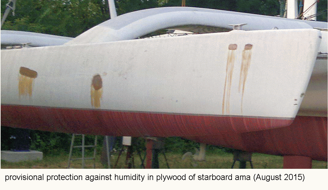

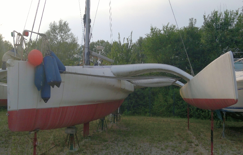

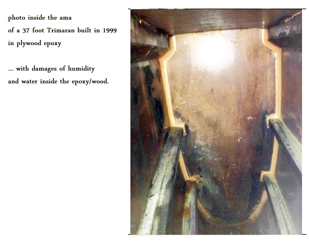

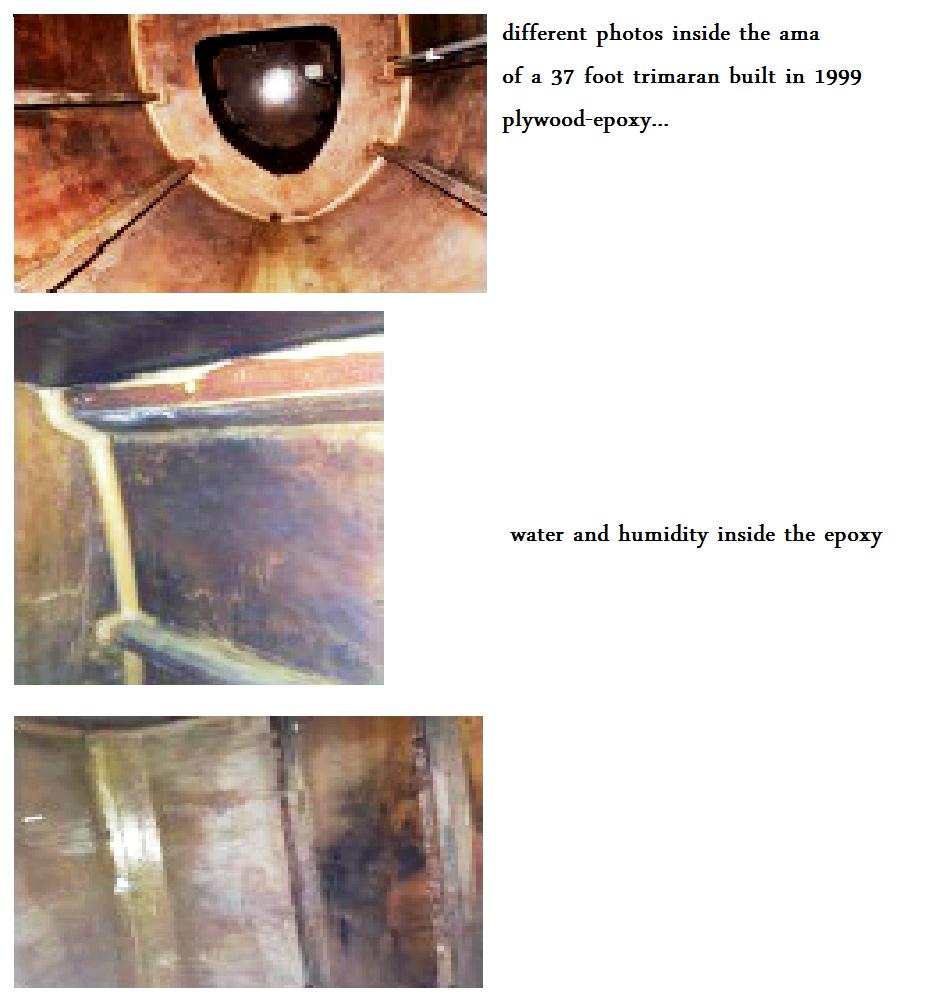

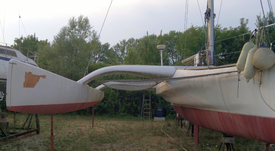

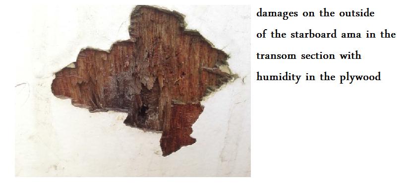

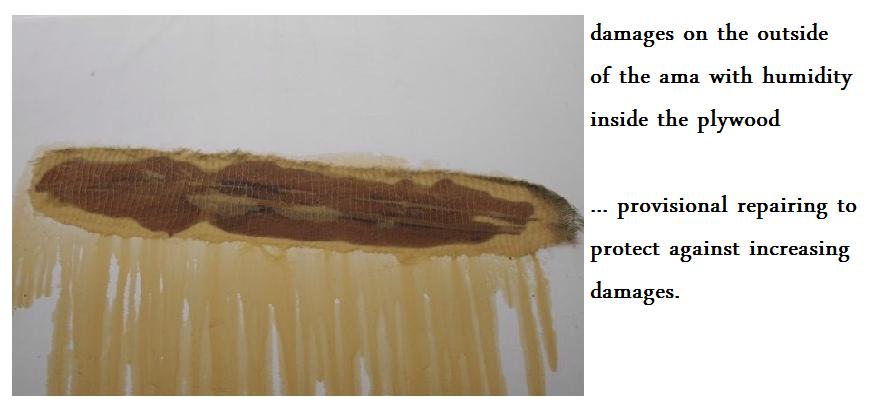

    Shortly (in August 2015) during an inspection the owner found different parts of the amas (outriggers) with humidity and water, same outside as inside. I just got the photos, see attachments...
    The prize for this 38 footer has been dropped down heavily (-70% of the original sales prize) as the owner neither has the mood nor the nerves to repair all the different damages.
    As I look for a Trimaran "living + working" it would be a good starter project, as it has astern cabin (double berth) plus foreship cabin (double berth), with fully stand hight of 1.9 meter in the saloon.
    I know that at least 3 other boats of this type had been built (USA, Belgium, Netherlands). So I have some other videos knowing about the seaworthyness and potentials of this boat.
    The boat in the pictures got the European CE classification, the highest class A (Ocean going vessel with up to 4 meters wave). Very astonishing for a single built Trimaran. Not too bad, as some European insurances demand a CE certification.
    So the simple question for now before I order a naval engineer to make a detailled survey:
    • Is it worth to think about buying this boat and refit the amas ?
    (Rec.: As the owner says there are many different segments to repair. He already gave me a pre-calculation for the costs. The investments would be roughly 50% of the reduced sales prize. So in total after the repairs I'd got a boat with 45% of the original sales prize.)
    Mostly there are hidden traps. So I seriously have the question:
    • Would it make more sense to refit the damages or build two new amas ?
    (Rec.: New built amas can be re-designed with wave piercing bows and foils. As for now the boat has a central daggerboard with wing rotation mast.)
    Now comes the cold winter in Europe, and I wonder what will happen with this boat during freezing coldness standing outside unprotected ??
    • When can the boat be repaired earlierst ?
    (Rec.: I have my doubts that there is anywhere a warft with a big hall to heat it over winter. So the plywood can dry out. I suppose earlierst the boat can be repaired after European spring time in 2016, right ?)
    Clearly I cannot repair the boat by myself. Neither I have the time, nor I have the knowledge, nor the infrastructure. I could learn all this as I come from engineering, but as my profession in medias does not allow it, I'd have to overhand it to a specialist/warft which can handle such "sensitive boats".
    Tks for giving attention and some feedbacks...
    P.S.: In the photos you see some text comments to get a better understanding. Some of the damages from outside have been protected provisionally.

    Those floats look beyond economical repair. I'm thinking from your description that they are "tortured" ply with an airex deck. I would base assumptions on having foam sandwich floats recreated at a quoted/estimated price and a generous allowance for fitting. Given that that might be a 80-110k boat up & running that a 60-75k offer might be accepted on.... if the seller has dropped 70%.... say asking 25/30k?....... I wouldn't look at it unless it was in the 12-15 range.
    Depending on location & skills available custom composite fabrications cost upwards of 600 per meter square starting with simple contact molded off melamine sheet... once curves are compounded with fairing & painting process 2-3k pm2 can be typical of reasonably weighted foam e glass laminates which add up quite quickly.... this make a typical secondhand tri or cat great value if structure is fine but repair/s come at new cost plus big F factor in pulling the old stuff off & putting back at that "add on" assuming that plans & laminate specs are available for the new works at a reasonable rate or if original plans available for that option.
    If you got it for 10 & enjoyed it on the mooring & locally respecting the shortcomings... and employed directly a tradesperson/tech in low cost premises to recreate the hulls required for fit up in the yard later it could work at some risk.... multis are just that, on a multiplier of square meters & therefore $$/.
    If some joker in the yard tells you they can sort at low cost.. be very wary... they just may be the next barnacle to attach to you and that boat.
