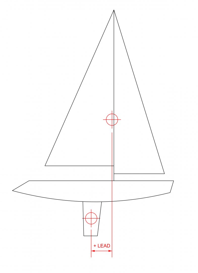

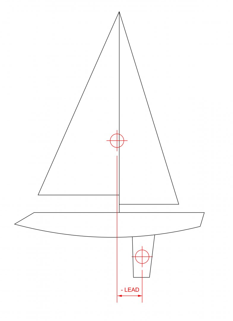

  6. FerroCementTho
    Joined: Jun 2017
    Posts: 6
    Likes: 0, Points: 1
    Location: Florida
    FerroCementTho Junior Member
    What I'm getting at is that your center of effort diagram will look like what I've attached labeled "Negative Lead Example," while it should look like the one labeled "Positive Lead Example." If you're adding another fin aft of the mast in order to equalize keel area fore/aft of the mast, you're really just adding unnecessary appendage drag in order to have the boat perform as it should, when you could just arrange your centers of effort in order to have a proper amount of lead and save that appendage drag.
    Your design seems to have a pretty low aspect-ratio rig. Have you considered the possibility that in ocean conditions, with 5m waves of any period, such a low rig will actually be dwarfed by the height of the wave, effectively becalming the boat every time it dips into a wave trough? Sure it won't be a total absence of wind, but it will be a very different sailing dynamic once the height of the swells go beyond the height of your rig above waterline.
  7. upchurchmr
    Joined: Feb 2011
    Posts: 3,287
    Location: Ft. Worth, Tx, USA
    upchurchmr Senior Member
    Very nice explanation of "lead" between the air center of effort and the water center of effort.
    And "positive lead" is absolutely critical to proper sailing. Perhaps not quite so much, though.
  8. FerroCementTho
    Joined: Jun 2017
    Posts: 6
    Likes: 0, Points: 1
    Location: Florida
    Thank you! More of an illustrative example than a literal one :) Meant to say please excuse the crudeness of the sketch.
