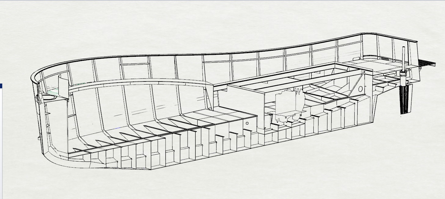

    The examples in my post # 19 correspond to structures of boats that I have developed with AutoCAD. They are really built boats, not an exercise in rendering. The 3D models were made to provide data for the workshop but also calculate the weight and center of gravity of the whole assembly.

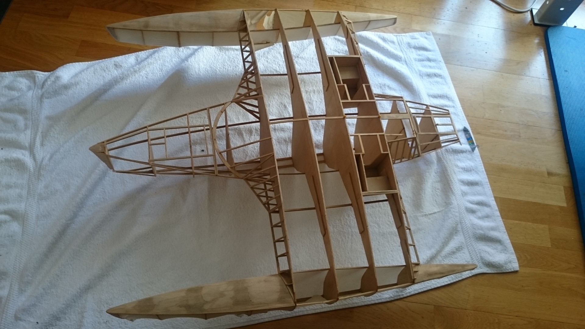

    Hello
    Thank you all for your comments and advice.
    Yes it was my hope to find a program another than Autocad(AC) and Solidworks(SW) that could do the fairing for me, a more boat specific program.
    I don't know any of the programs mentioned here, but I guess a design program for hard chine boats would be the best to do the job for the hull and then do the interior in AC or SW.
    Regarding the lofting and outer skin creation in AC/SW what would the the preferred workflow be?
    - draw the half with bulkheads at each station
    - draw the splines from bulkhead to bulkhead at every hard-chine
    - pick the splines for the surfaces and use the stem and transom bulkheads for guide-curves or visa versa?
    I remember seeing a video online that say one have to create the splines first, then the bulkhead to get a dynamic drawing with movable relations(in SW), but that would be hard to do without having the points of the bulkhead to snap on? How do I get the right curve? https://www.youtube.com/watch?v=C18kB35vyvY
    I have tried some times in SW to make the skin, but it fail at the transom do to the lines in the transom being used by the hull-side, any way around this problem?
    Also when it comes to making the hull-panels, do you start with etch single panel when you lay out the surfaces of etch hard-chine, taking into account the size of the plywood sheets? This would be a major task I think.
    I have attached a photo of my old 1:100 scale model that's been sitting at my loft fore some years now, not looking to good after some moves.
