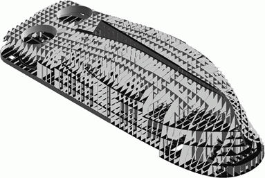

    Thank you for the comment and picture, this is what I been trying to do. Yes when I drew it up I new nothing else then 3d-polylines. I get what you are saying with less points, but what lines do you use to lay out the longitudes to connect the points. May I also ask what program you used?
    I have gone back to start and are laying out 2 dimensional half breaths in Autocad and will concentrate on one half without deck to start with, then I have some time to decide on what program to use for laying out the hull.
    Thank you all for your comments and help.

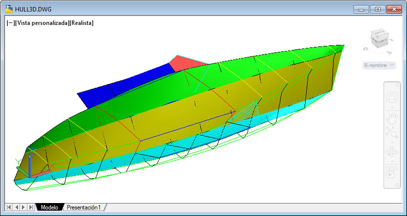

    Here's a sample of what you can get with AutoCAD. I used splines instead of your polylines and, without changing a single point of your transversal sections, I've gotten the attached model. It seems that the hull model is smoothed than you thought.
    Take my advice and do not change the software till to check, convincingly, that what you have does not serve you.

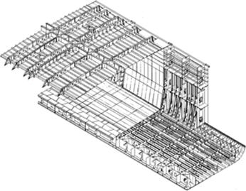

    Regarding the reinforcements with SW, I attached two pictures of what can be done with AutoCAD

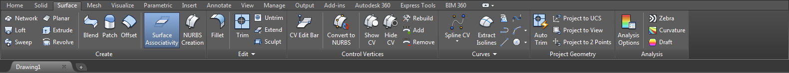

    I do not know exactly what you mean by "checking fairness". Fairing has always been a matter of good eye and skills of the artist. You can not translate it in practice, I repeat, in practice, to mathematical methods.
    Attached pictures show tool palettes AutoCAD provides the user to work with surfaces or meshes.

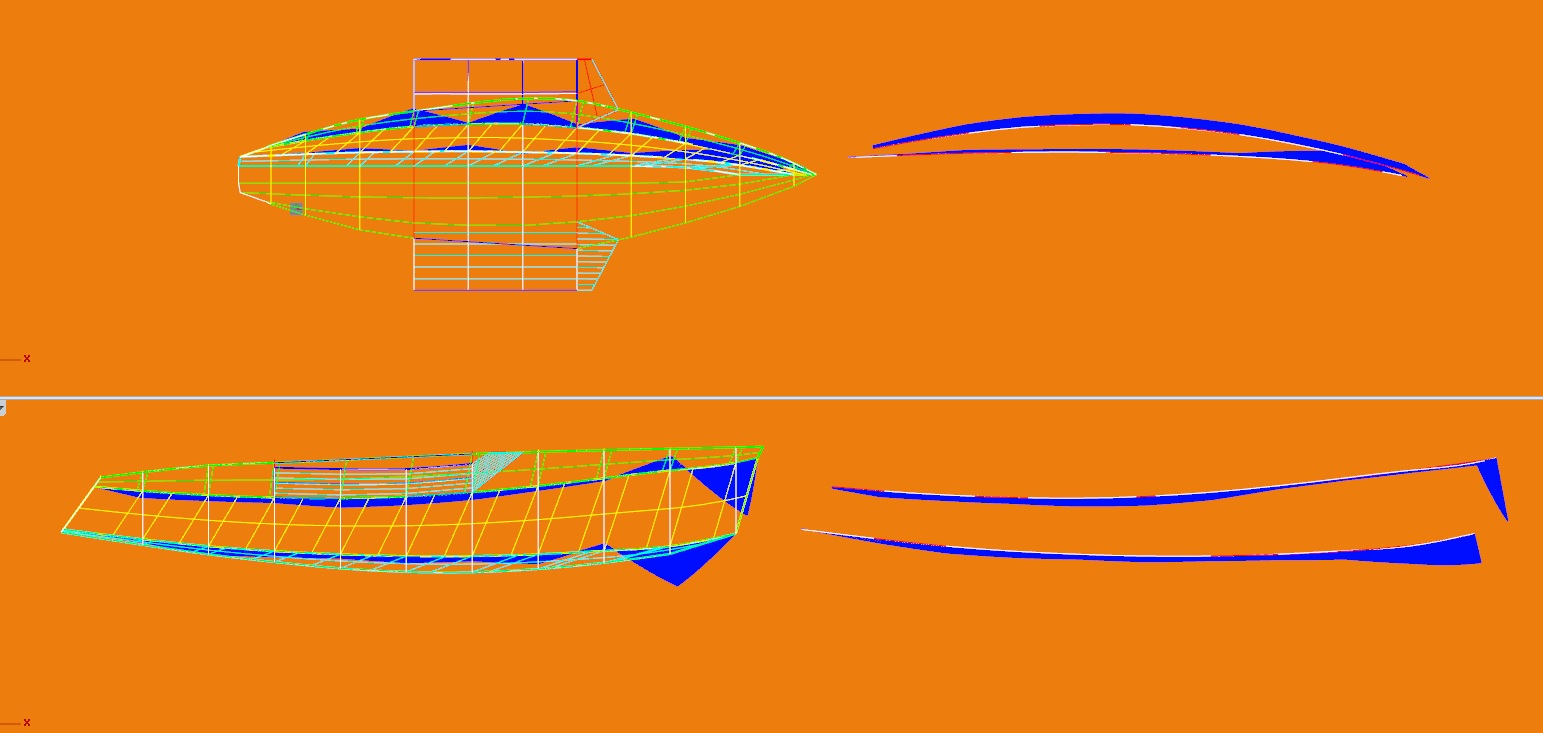

    Tansl sorry I’m not talking about the notion of “fair” in a curve, as you point out its a matter of opinion. In rhino as well I see in autocad you have surface analyse, Gaussian and the like to show deflections in a surface. In rhino and other software you also have a “line graph” which shows you the curvature in more detail than you can see, as an example in the two pic's one show a curved line in plan and profile say of a shear, all look 's ok but when you turn on the line graph you can see a hollow at the stern and the profile has a flat spot. By adjusting one control point out by 30mm and one down by 60mm I have improved the look of the curve.

    Tansl no problem, I know its not part of you work flow to do this but I was interested in seeing the differences. I copied two chine lines across and turned on the curvature graphs. I then adjusted out the peaks and hollows on the copies, the max difference in old (white) and new (red) in plan was 7mm and in profile 25mm (in the bow area).
