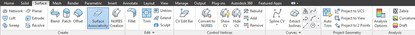

    I seem to remember that, from the AutoCAD 2010 version, new commands / tools for working with surfaces were incorporated, that will go perfectly for surfaces that you're looking for. See attached picture.

    Wow, I see.
    This look interesting and all new to me.
    Why fix something if it isn't broken!
    Thank you!

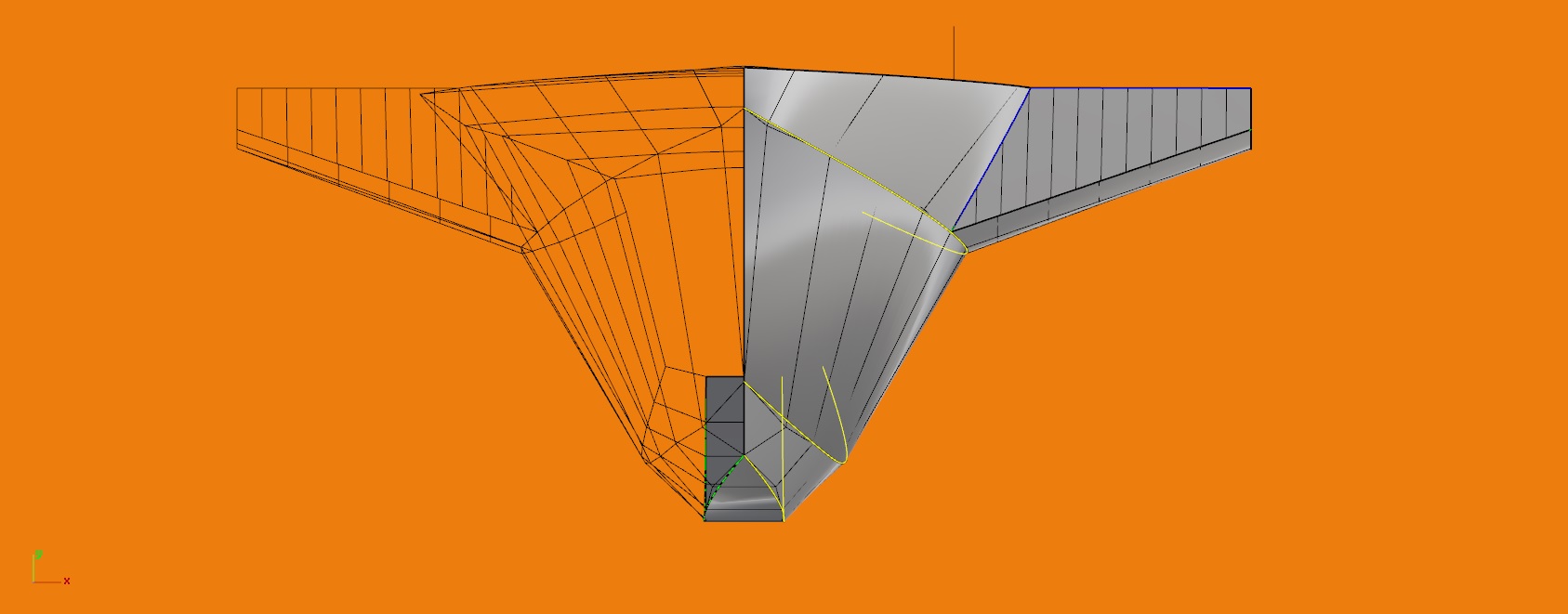

    It is not always about what software you are using and the tool set that is available for fairing and surface generation, but more helps. Sometimes its the methods and techniques being used can cause the problems. In the files you posted you seem to have used polylines instead of curves for the chine lines. This makes it impossible to fair the most important lines for the construction of the surfaces in your design. Rather than trying to recreate the processes of the drawing board with lines for all sections think about stepping back in time a little further to when half models were made and all the lines were taken from them. That way you only need a few target points, say bow, stern and say three sections, then you only have to pass a curve through these points, then fairing the curve becomes simpler, construct your surfaces from these curves, then you can get your lines from the model you have created.
    I used this method to create what is in the pic. I put the curves through a few of the sections plus bow and stern, I then faired up the curves a bit more then did the surfaces. You can see in the bow area the difference in the chine lines.

    I agree with the use of splines is more appropriate than using polylines. However, in my opinion, not only about getting smooth curves, but curves pass exactly the cross sections he has defined. Use only a few points occur, of course, smoother lines but will not guarantee that the lines go through all the points, which is what, I guess, he is trying to achieve. What he should do is to draw splines passing through all desired points and go slightly changing the position of any of them (ie, the shape of each frame) until the curves are adequate.
