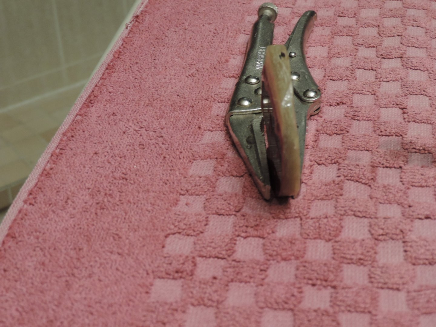

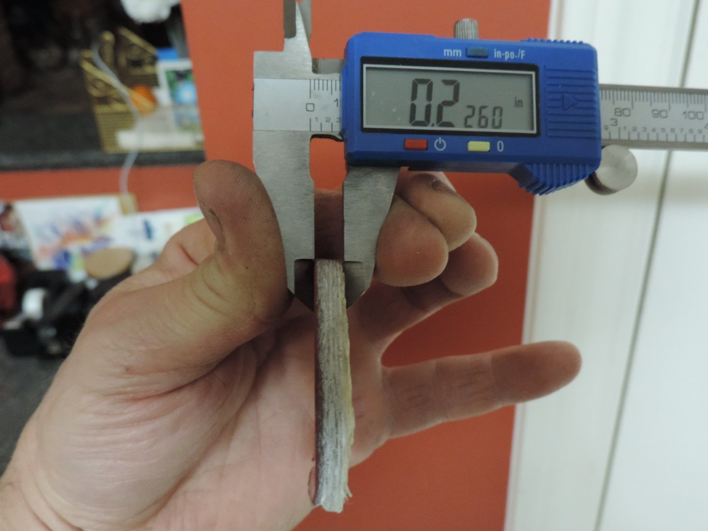

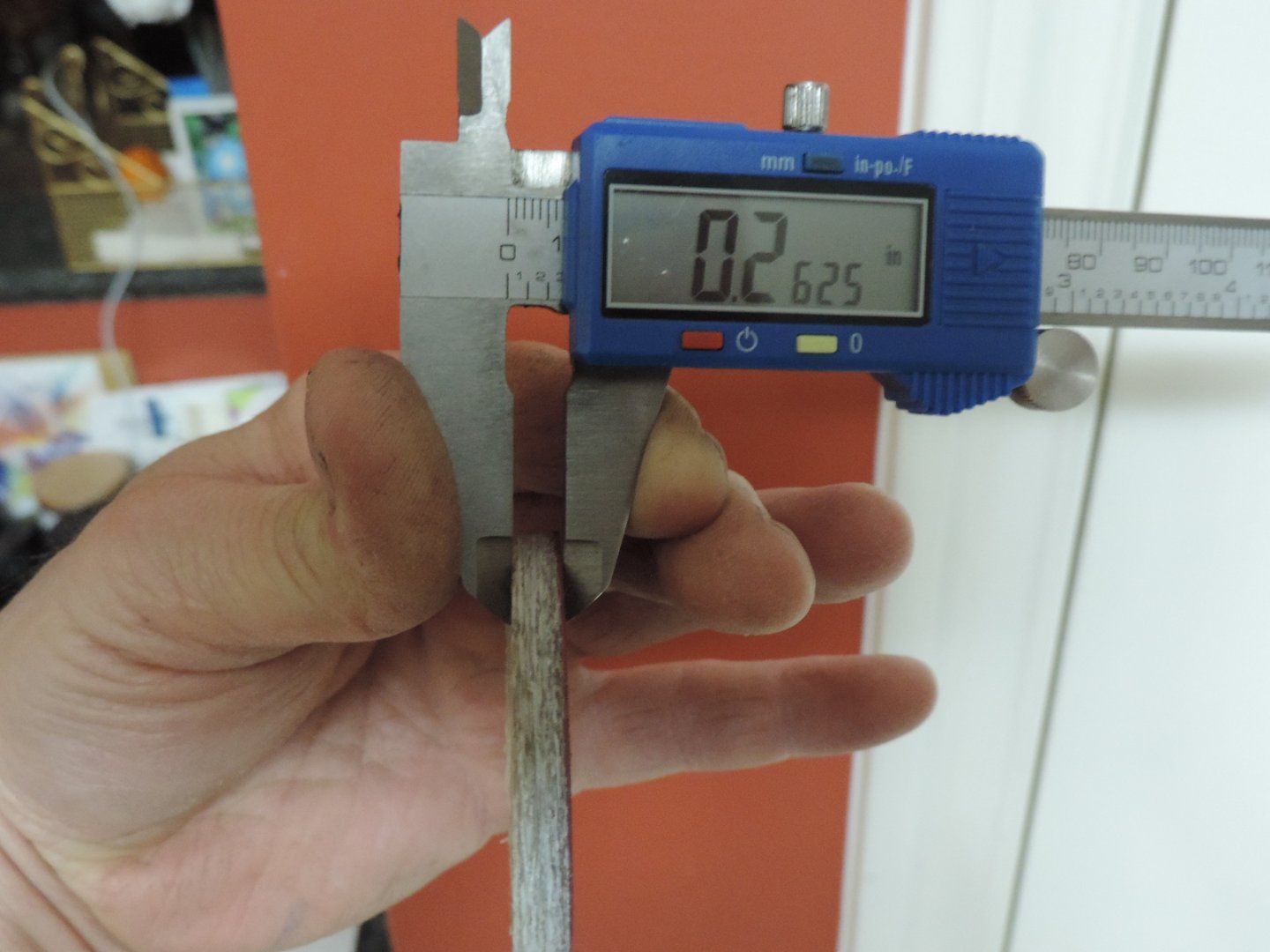

  8. fallguy
    Joined: Dec 2016
    Posts: 8,745
    Location: usa
    fallguy Boat Builder
    -picture offered for comparison only
    Between caliper fingers is 6 layers of solid db1700 glass hand laid; well consolidated, caliper say 0.193", but I am cheating it in well past the fairing compound and paint layers-this glass between the caliper fingers is not really enough for your hull, but you have way less glass and mostly mat
    Your boat's actual glass is super thin I'd say. If I had to guess a single layer of 1708 or two layers, but certainly way under 0.100" of glass.
    Sorry, but this broke because someone trusted the hull more than it could deliver.
    I was out, but I am back in.
    As a builder; that looks like a single layer of perhaps 1708 on each side and coremat middle, or maybe two layers of something. We had some debates here and decided 1708 was between 0.040 and 0.050" thick hand laminated.
    There does not appear to be any grand cover up of prior damage by the original owner.
    The boat was probably damaged prior to shipment to the dealer or while at the dealer or while transported to you or by you.
    The reason for the failure is the laminate is really weak for the boat's weight on something like stands or a trailer.
    A very highly vertical section of my boat is 5 layers of the same and would measure 0.165" all fiberglass no coremat. Much better built (by me) for far less loading demands than the Rangertug.
    Your boat's laminate is too thin, based on my limited knowledge about boats learned over the last four years of amateur building. Not because of what I measured, but because nothing I have built for far narrower hull with a lower speed rating is that weak.
    Now. What is worse! It is possible the coremat bond or inner skin bond is secondary.
    Also, I don't know if that is an epoxy boat. Gathering not.
    I would be very curious as to whether a manufacturing error occured. Like boat built on a Friday and they forgot the second inner skin Monday, etc.
    if you ask a number of people here to spec that hull with coremat; you are going to get a better idea than my guesswork
    post script
    that is really hard to tell what you have there; perhaps you could sand by hand the edges of the cutout and do so with a progressive grit starting at say 80,120,220 and then wet with spirits to see if that is actually glass or not
