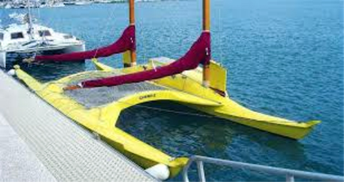

    I suspect the reason no one responded is because there is already a thread at http://www.boatdesign.net/forums/multihulls/40f-folding-proa-harryproa-55608.html
    In answer to the question/title, I would reply that it is both.
    The client had a long list of very specific requirements which could not be supplied with any other boat. So it definitely fits the second part of your question.
    Due to the build method (Intelligent Infusion http://harryproa.com/?page_id=1327) and the simplicity of the harryproa type, it will also be cheap. The compromises that have been made are, for this client and his requirements, very few.
    If you want more information on the boat or the build, let me know.
    Corley,
    Bucket List https://www.youtube.com/watch?v=ttXu3pRTzs8 edges closer. Look forward to taking you for a sail.
    Update:
    The windward hull is built and painted. Weighs 80 kgs on my bathroom scales. It's a bit rough as I am not allowed to make dust, but from 3m/10' or so it looks fine. The 2 halves of the lee hull are out of the mould, have the bulkheads fitted and weigh 80 kgs each. Maybe another 20 for mast and boom sleeves, foam bows, the centreline join, paint and antifoul. The beams are scheduled to weigh 25 kgs each and as they are filament wound, this will be accurate. Ditto the mast at 60kgs. I have just picked up the rudder moulds ($Aus400) and will build them next week. Based on the laminate and previous jobs, they will weigh about 15 kgs each. The rudder mountings on the beams have been through a few iterations, but are now simple and should weigh about 10 kgs each. Windsurfer masts for tiller extensions add another 10. Tramp, sail, battens, boom, winch, running rigging another 60. So, ~500 kgs.

    In addition there is the option of folding bows as shown on the Exhilarator 40F
    What is your take on that feature?
  15. redreuben
    Joined: Jan 2009
    Posts: 1,778
    redreuben redreuben
    Well from the graphic I don't see the point as the folding mechanism sticks out further than the shortened hull !
    It kinda defeats the whole Harry ethos of simplicity but I guess for some people the added complexity is going to be a necessary evil.
    There will be a lot of force from many different directions trying to rip that bow off and it will need to work in two directions as well, quite the engineering challenge.
