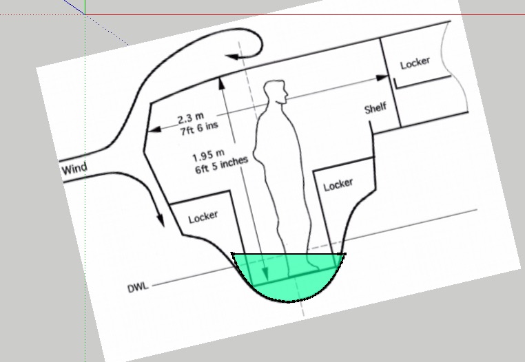

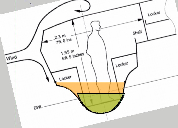

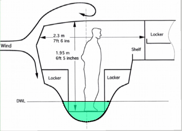

    This is a cross sectional view of Shuttleworth Spectrum 42.
    Green area is roughly calculated to be 34 sq cm.
    Orange area is 68 sq cm with 13 degree heel.
    Sorry, but how does the Marchaj graph account for these changes in hydrostatic balance?
    Believe that is why Richard Woods referred to a theoretical crane lifting the windward hull.
    Just added the 3rd image showing the original displacement with 13 degree heel. Very little, if any, change in the hydrostatic balance.

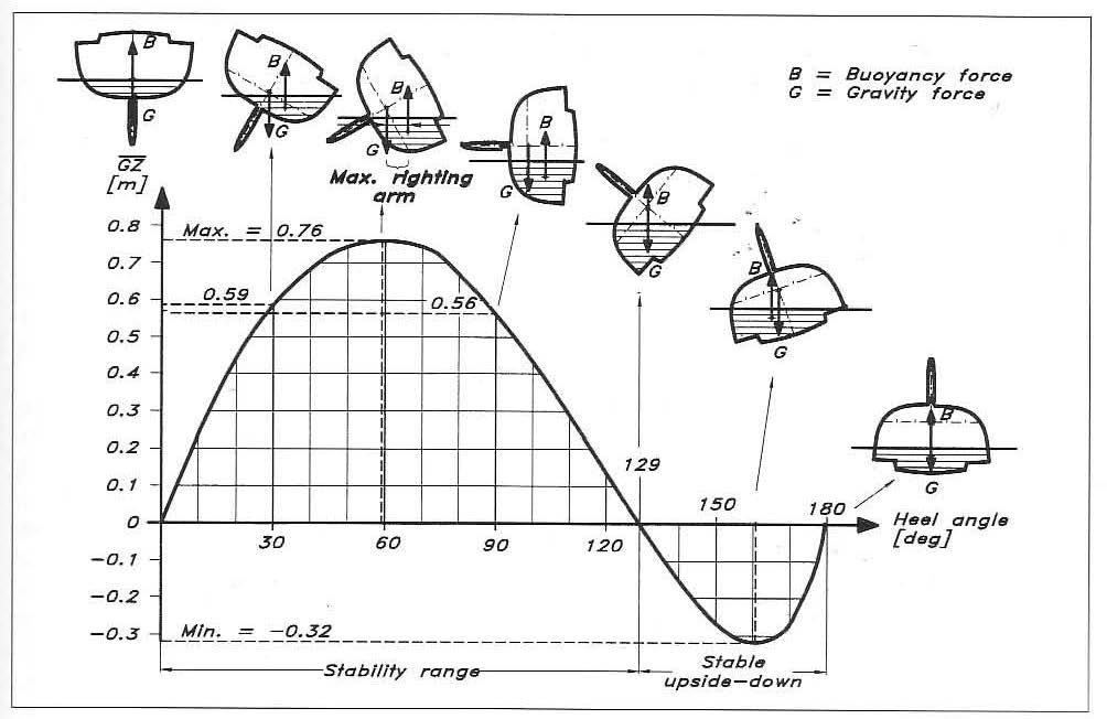

    Well, now you know what occurs when the hull rotates and if a multihull, when one hull comes out of the water..the other hull must accommodate a new waterline as it supports the entire weight of the vessel on just the one hull.
    We calculate this effect using a GZ curve and it is done sequentially from 0 - 90 or 0 - 180 degrees (depending upon hull type) at 10 degree intervals, or similar like below:

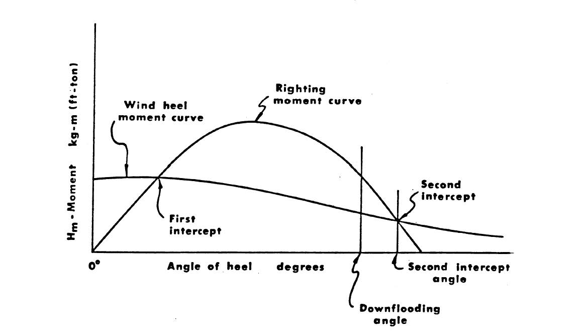

    Then knowing the wind force is applied at a particular location on the sail, this force x the distance from the load application point to the waterline is a lever = a moment. This is called the wind heel moment.
    So we now plot this wind moment onto the GZ curve as shown below:
    So where this wind heel moment curve intersects with the GZ curve, we get the angle of heel of the boat. That's it, simple.

    Sorry, wrong again.
    Looking at the wind moment curve applied to the righting moment GZ curve above, where is says first intercept, this would be the steady angle of heel. Your 20 degrees if you like. If the wind continues and the vessel is heeled to 50 degrees, to where is says downflooding angle (call this the 50 degrees), the area under the curve of the righting moment from the instantaneous angle of heel to the 50 degree line (downflooding angle) above the wind moment curve must be the same or greater than the area from zero angle to the first intercept....regardless of the location of the avs.
    Thus plotting the curve and the wind lever gives a picture of how much work is being done...and how much energy the vessel has...and in varying wind speeds.
