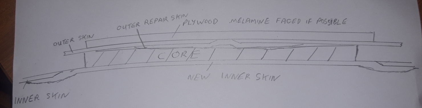

    Hi,
    im needing to laminate up a new deck hatch to 25mm with a 18mm ply core. My question is in addition to the gelcoat and ply how many layers of 450 csm would it roughly take?
    thanks

    Perhaps I should mention the alternative is a 15mm ply core.

    If gc both sides, subtract 0.040.
    So, less 1mm is 6mm laminate thickness with a 1mm allowance for fairing is 5mm. 450 gsm csm is 0.7mm consolidated, so 5/0.7 is 7 layers, but that is just odd, so I’d round down to 3 each side and fair it up to desired. Or do 3 each side and measure and add one each side..
    I have little experience with csm, so see what others say as well.
