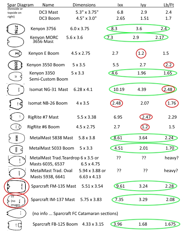

    Any ideas on how to find used spars by specs? My trimaran plans spec the spars exactly but the specs on Ixx and Iyy or even on ft/lb or extrusion thickness are rarely given in listings. I'll probably want to to buy a used leadmine to scavenge all sorts of parts, and hopefully get much of my money back for lead salvage and engine resale. But I know spars on a multi must be stronger. Seems like I need to look at bigger monos to get my required boom length anyway, and then probably crop the mast. I have been using the RigRite site because it lists a bunch of common boats for each spar, but even that is spotty.
    Here are the specs.
    Mast 32', 5.3"x3.75", 2.4 lb/ft, Ixx>=6.8, Iyy>=2.9
    Boom 12'4", 4.5"x3", 1.7 lb/ft, Ixx>=2.65, Iyy>=1.51

  11. Skeezix
    Joined: Feb 2016
    Posts: 22
    Location: NE Iowa
    Skeezix Junior Member
    mast summary
    As I mentioned, I like the RigRite site because for many spars it lists boats that might have them. This graphic is a summary of candidates I found there. Green circles are "looking good" details. Red ones are less than ideal.
