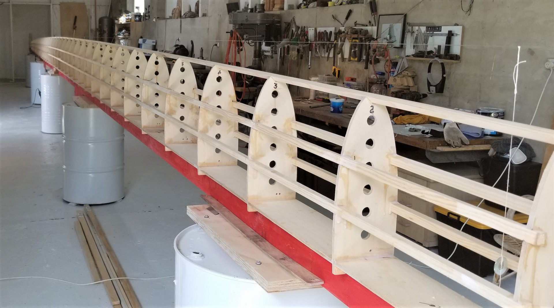

    PS and I won't fiddle around trying to foam fill the wing mast either. If anyone is interested I could start a thread on the wing mast
    Mast ribs assembly enhanced and cropped.jpg Mast white enhanced March 2020.jpg
