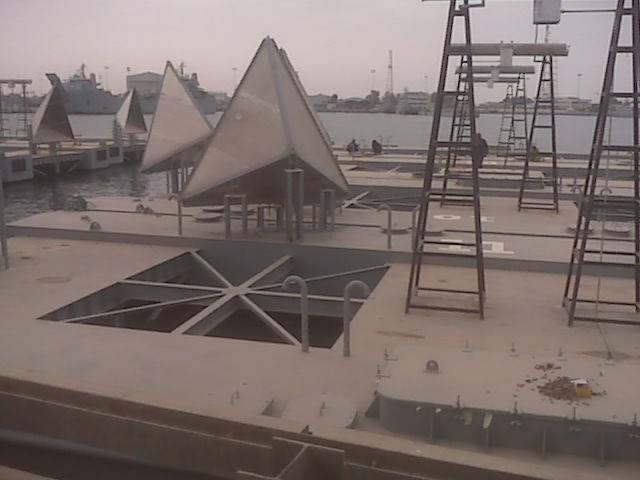

  12. Bijit Sarkar
    Joined: Sep 2005
    Posts: 48
    Likes: 5, Points: 8, Legacy Rep: 80
    Location: Calcutta,India
    Bijit Sarkar Naval Architect
    Catamaran Barge
    Dear DomB,
    Please find the 3d view attached.
    I made 20 of these and exported to middle east in semi knocked down condition . Two pontoons, 3 top panels, and the connecting arms were sent in separately and assembled at site and launched.
    In the two photographs, you can see the catamarans at the quayside, waiting to be deployed. Please ignore the structures on the deck.
    Also, this had two gaps in plating on the deck, and split levels. You may want a uniform plating and a super structure on board.
    If you need it for calm inland use, i would reduce the depth, that will save you a lot of steel weight.
    Anyway, we can work on the details.
    Regards.
    Bijit Sarkar
