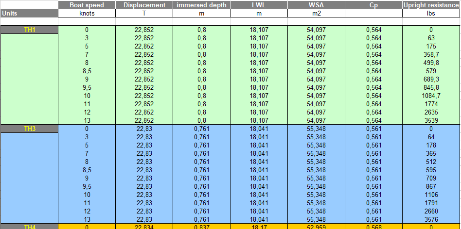

    Hereby attached, an overview of the culprits and their misdeeds on the poor flying AC75. At lunch time, I've also prepared a T-shape hull and a post-processsing loop, so we will be able to see what is happening on a different shape, and get an idea of the incidence of this parasitic drag. I must say that my poor drawing of the jib may also count as a culprit in this tragic affair, ( Mikko, if you're here, you surely be of a great help ). So, as long as I've not corrected the jib shape, I won't be able to have a meaningfull drag breakdown, for gain or loss to be estimated. I work with CATIA, all the models are parametrized, and comply with the ACM rules. But I just cannot close the slot between the mast and the jib leech, with the given measurements. But maybe I'm mistaken somewhere....

    Couldn't wait to test the T-shape... Very instructive. More comments to go. A very interessant shape, although I didn't use the true "Gate" shape that could be seen on LEQ12.
