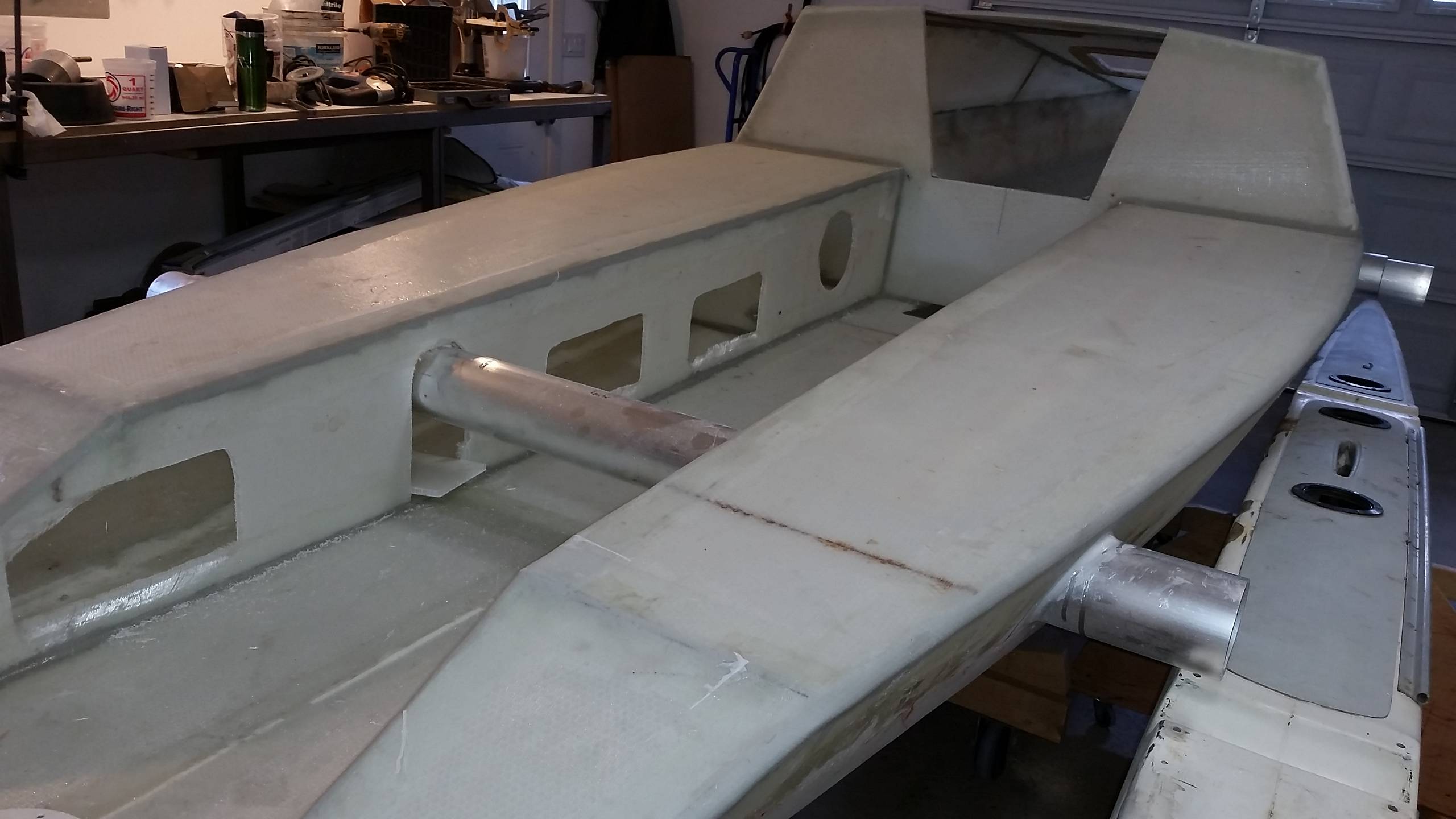

    I've been asking a lot of rigging questions lately and I have another. How wide must a traveler be to work properly and be useful?
    I've got a traveler track that's about 72" long. And I can either mount a 28" section of it directly on the cross beam in the rear of my trimaran, or I can make aluminum risers, add a support beam, and mount the traveler in full width. What would you do in my scenario?
    Here's a pic of the rear beam to give you an idea of where it would go.

    does seem a pity to have a 72" traveller then cut it down to 28". Looks straightforward to mount it onto the side decks. Is it too late to cut away/recess the side decks so that it could go directly onto the aluminium tube right across with top of traveller about flush with side decks? How will the tiller/tiller extension interact with the traveller/mainsheet - will there be an ergonomically satisfactory helming position sitting aft of the rear cross beam and will this allow in a suitable length tiller? Hard to tell from the picture. Many of the Farrier trimarans have the traveller on a sort of elevated 'bridge' so that the tiller can swing underneath the traveller and the helmsman sit forward of it, but that might look ugly on your boat. Alternative could be to have the tiller pivoted somewhere near, or on, the aft beam and link it to the rudder through two levers joined with a push/pull bar. Just thoughts. Looks an interesting trimaran.

    I had intended it to work something like the astus 18.2 with a curved tiller arm that goes over top of the traveler.
    It's probably pretty late in the process to modify the seats, but I have the tools to weld aluminum so I can make a few brackets and add a section of some smaller tube to run along the top of the seat decks and tie structurally into the cross beam for additional support easy enough.
    After reading the responses I think this is my best course of action to create the best sail control options. And it will tend to move the traveler car further off center making room for tiller movement. Unfortunately it will still require the tiller be moved around the sheet like you do on a beach cat. I had kind of anticipated that being required, so not really a big deal.
    The picture might be deceiving. This is only an 18' long trimaran so seating position is kinda important to balance of weight. I intended to steer from a seat position ahead of the cross beam most of the time.

    Full width definitely. I would say for your boat, 8 feet would be perfect, but since you can't do that, just do as wide as you can get it without it interfering with the folding/separating/whatever system.

    As rcsneg said, the maximum you can get without interfering with other systems, like tiller.
    A long traveller will give you a wide range of trimming possibilities, while a too short traveller will put a lots of load on sheets and on the deck structure. You can use this guide by Harken to calculate loads on your traveller system: http://www.harken.com/article.aspx?id=16233
